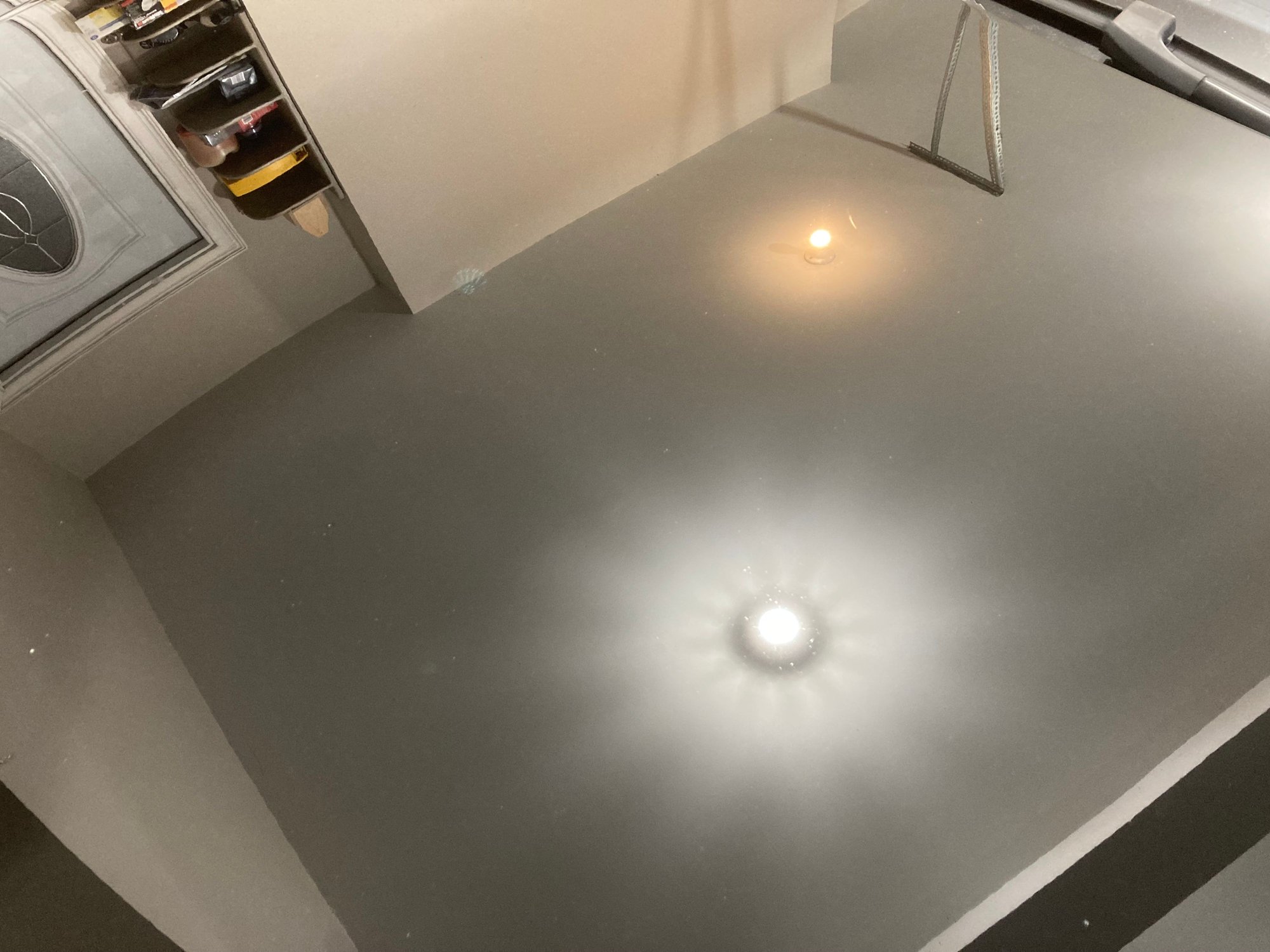

If they are doing ceramic make certain it's real, real stuff needs 2 days to cure to acceptable level to be moved around and should be kept dry for a least a few weeks/don't wash it. 30 days for full cure, I have 3 of my cars just camping in my garage(s) right now since I switched them to ceramic pro coatings. One of them got corrected for the first time...

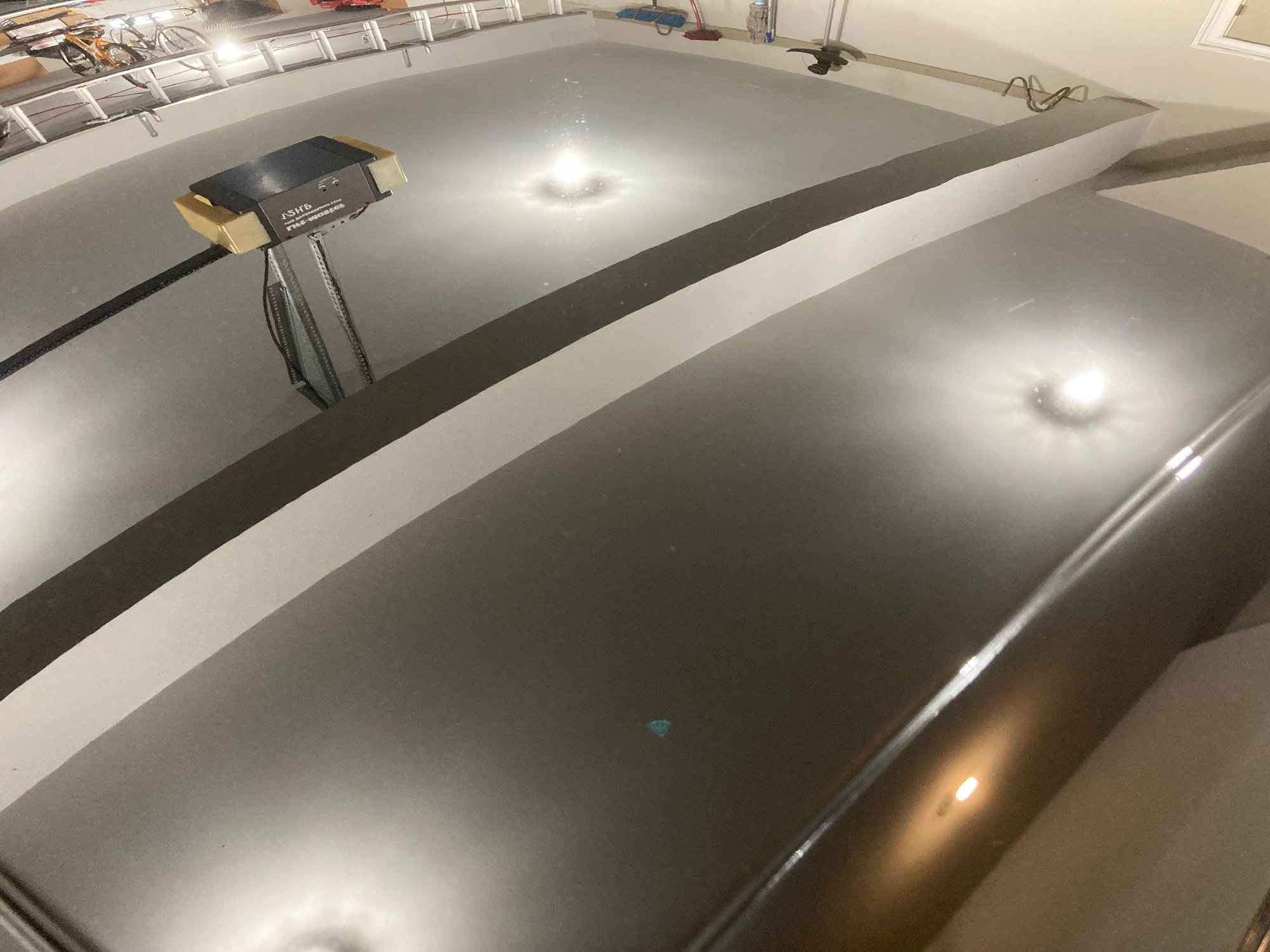

You can go from this lower half to the upper half in a
You can go from this lower half to the upper half in a "single stage correction" and that's what most people call a buff or polish...

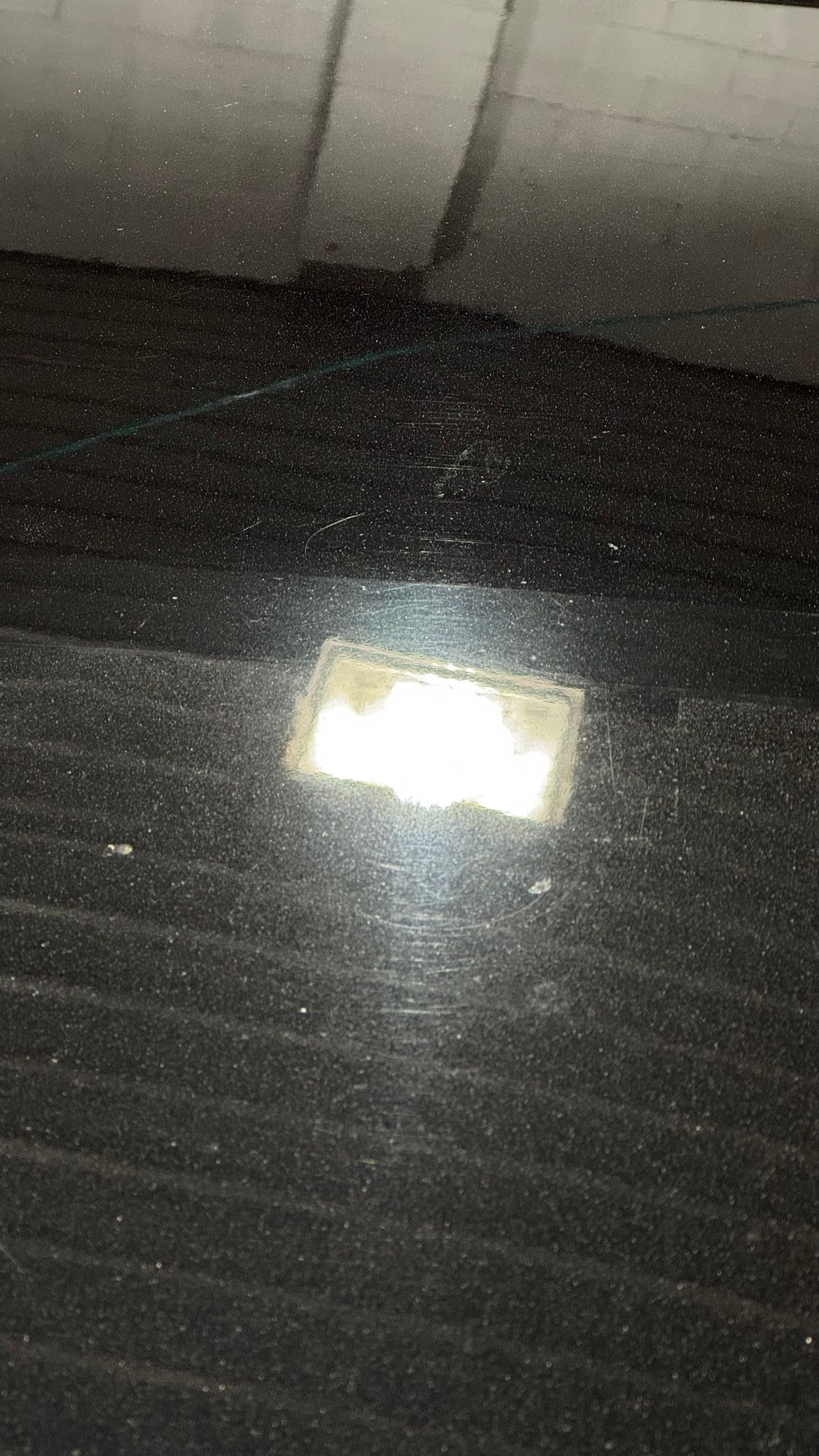

Or to this with a proper 5 stage with skill.
It's entirely possible to get 20 year old paint with oxidation pitting perfect again.

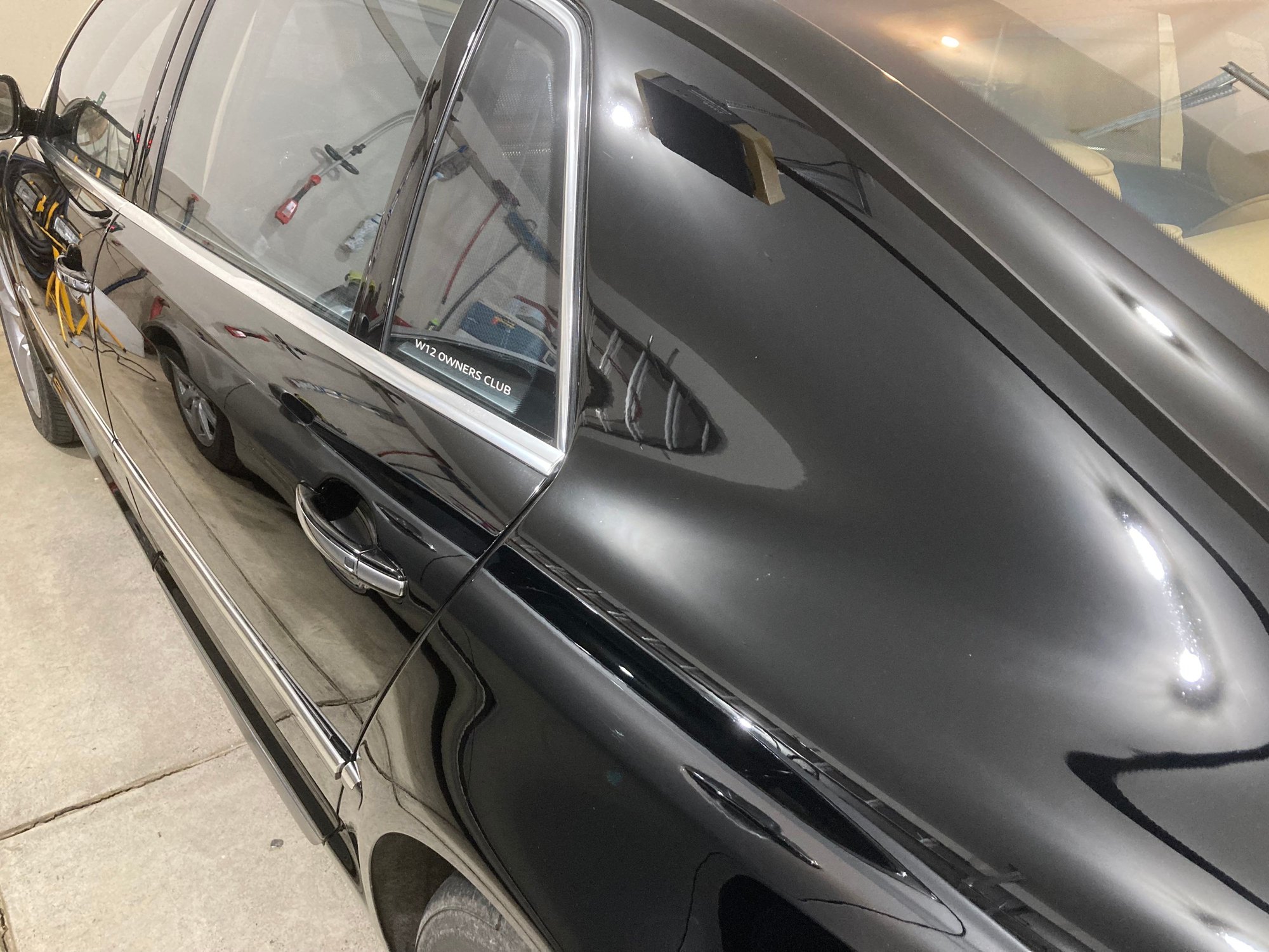

This is what you want before you put a coating or PPF on. All of my cars are like this one before I coat them, a job like this at a shop runs form $3000-4000

Your car looks great. Thanks for the information. Northlake Lexus is part of the Northlake BMW, Mercedes, and Audi group. It is my understanding their paint shop supports all four dealerships. I agree, I hope they know what they are doing.
