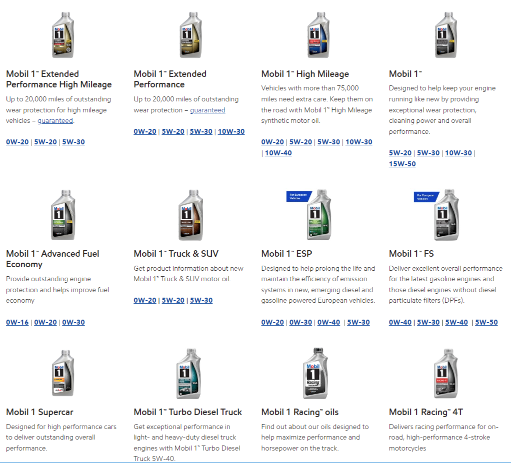

Pure marketing if you ask me. Do we really need another variety of the same Mobil 1 full-synthetic? In addition to the existing twelve?

I use the ESP X3 oil in my Audis, Moble1 in the Lexus cars, and extended performance high mileage in the Jeep since they are optimized for different usages for the same price so why not?

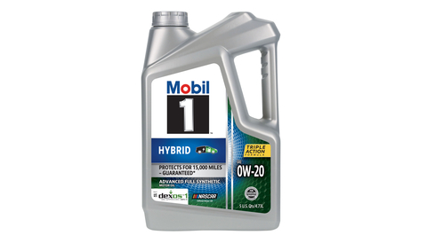

If you look closely at the bottle, you will see that it says "Protects for 15,000 miles...guaranteed". I would take that with a grain of salt.....a BIG grain of salt. And, remember, on most hybrids, for the reasons I explained above, 15,000 miles on the gas engine is not the same as 15,000 miles on the electric motor...so it is difficult to determine what that 15K miles really means, although most likely 15,000 miles on the odometer.
That what I'm basically trying to say.
Like Stricker was saying above, the formulas are different so I can appreciate that but then go tell people on the label they're good for 15lK miles???
