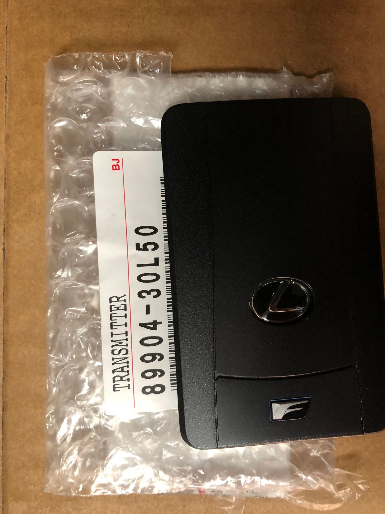

Not really part of the build, but I did order the GS F remote wallet card from Bell Lexus.
This is the only one that apparently works with the GS F (part number below). Getting it programmed next week.

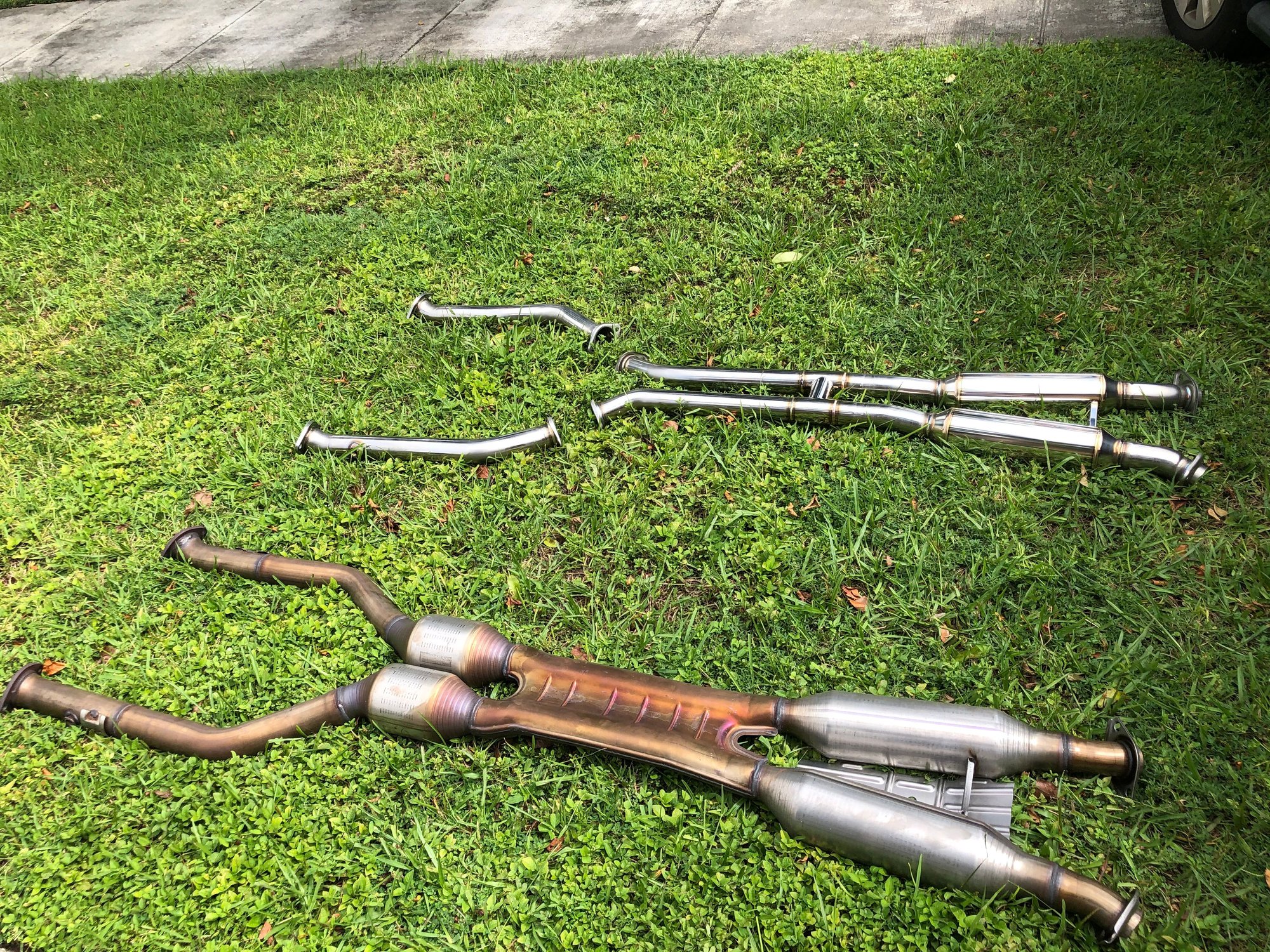

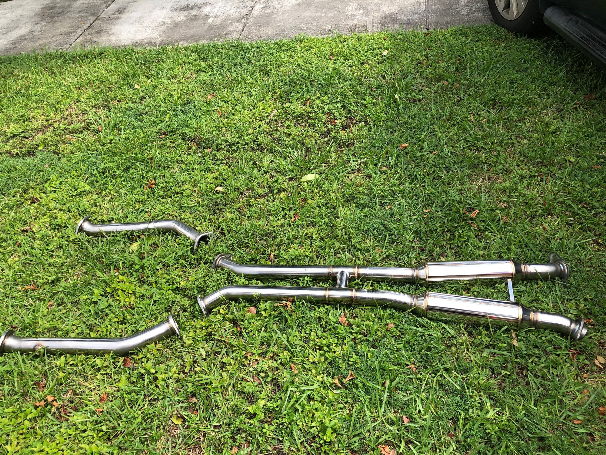

Installed the A’PEXi midpipe yesterday. Sounds great, even with the stock axleback still installed. Can’t wait to finish the exhaust when the axleback portion comes in from Japan.
Thanks again to Josh @ Meraki!

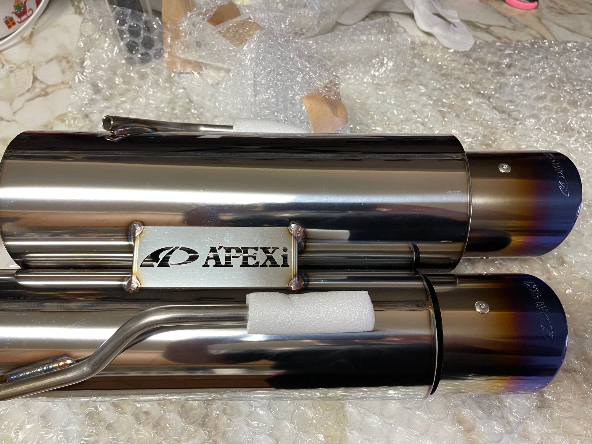

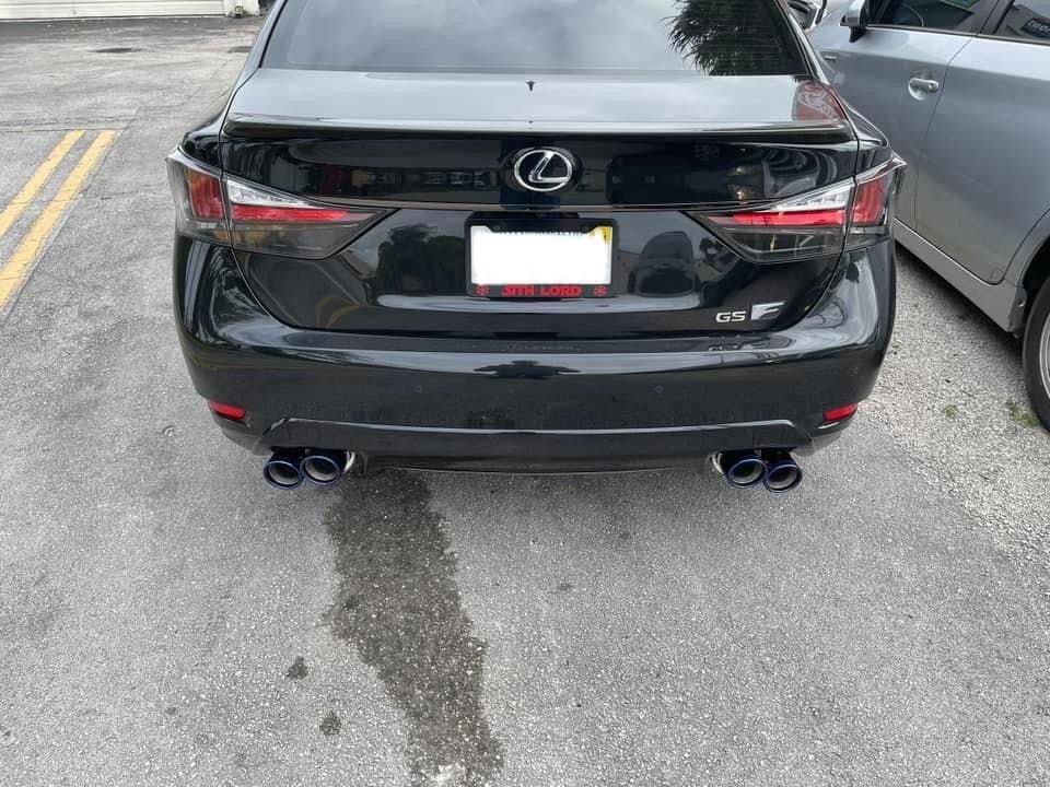

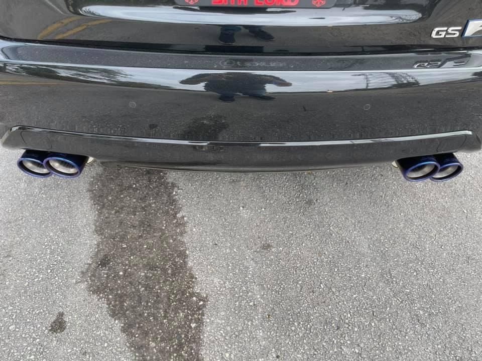

Finally got the axleback portion (thanks to Josh @ Meraki) and had it installed today. Very happy with the loudness and the rumble! Video clips do NOT do this cat back exhaust any justice!

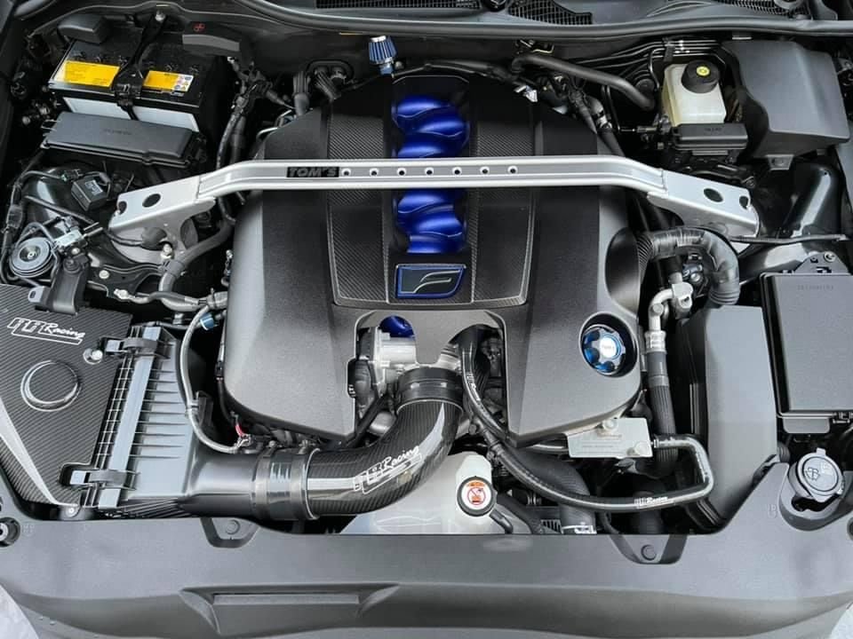

Installed the TOMs Front Upper Performance Rod Strut Bar. Easy install and no compatibility issues with AVS or relocated solenoid/horn from the RR Racing Heat Shield.
Also, replaced the intake’s stainless t-clamps with some Sure Motorsports Stealth worm gear clamps.
Next up will be the TOMs Front Cross-Member Brace and FIGs LCA bushings.

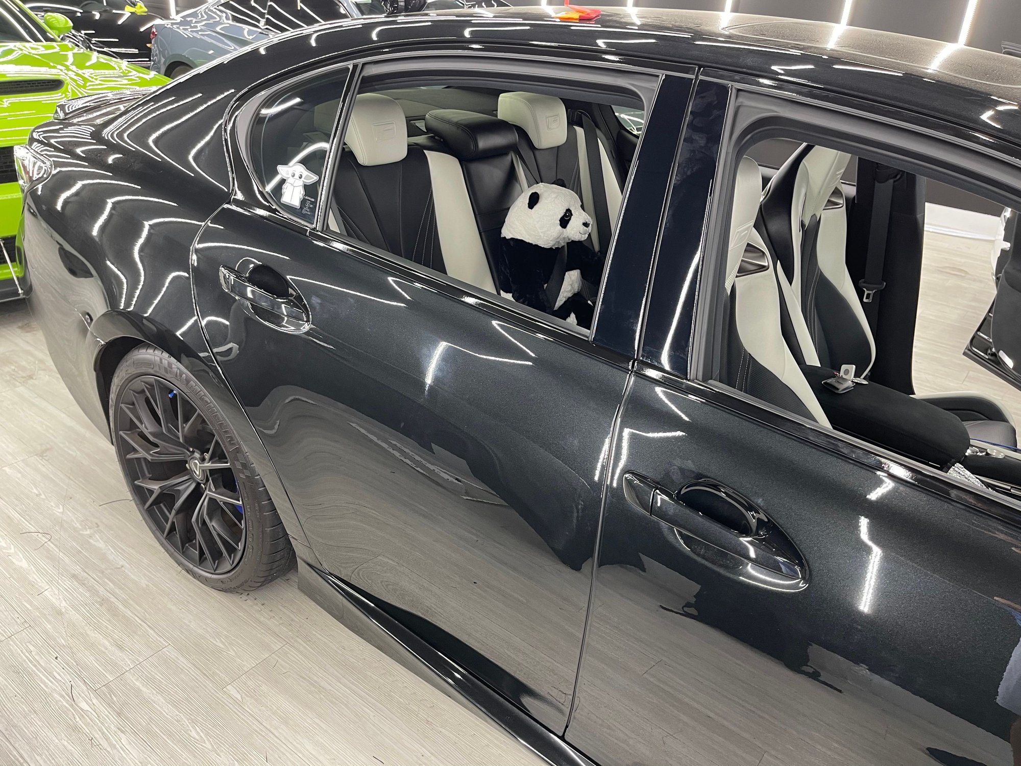

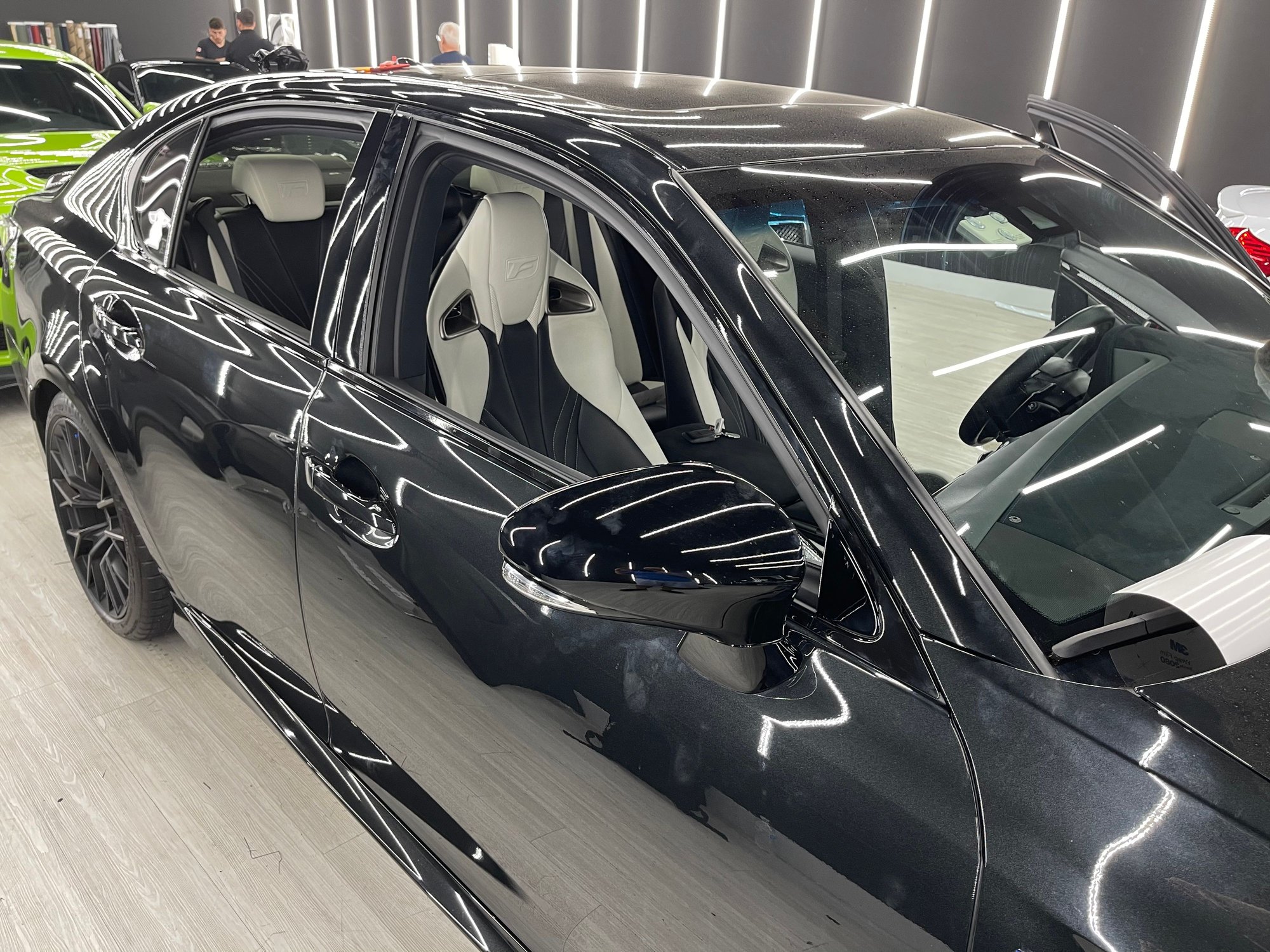

Had the chrome delete done using 3M 2080 Gloss Black to match the OEM pillars and mirrors which are gloss black on 2020s.
Looking good! That was a must on your car. I am still debating on if I am going to do this on mine.
