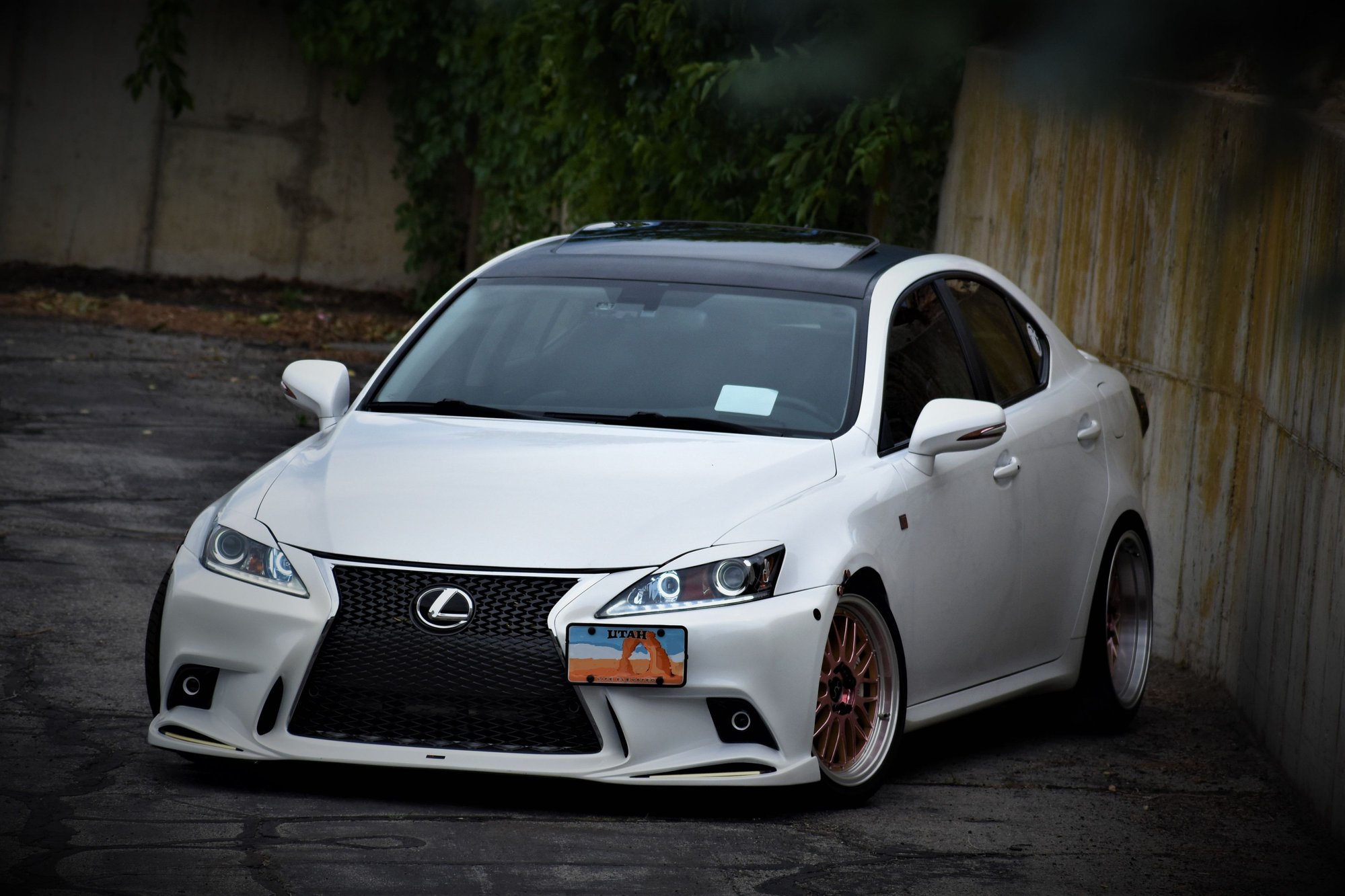

I have been on here a while and figure it is about time I chronicle my build so far.
Here she is the day I brought her home. A 2009 Starfire white is350 luxury with Nav and Mark Levinson stereo and black leather interior. The exact car I had been looking for for about 6 months. I was willing to travel 2 states away to find what I wanted but ended up finding one right in my home city.
Had some problems and needed some help. Had a cracked Navi screen and a hole in the bumper, some scrapes and tears.
FIrst thing I did was fix the screen, replacement parts were cheap and easy to get.
Then it decided I wanted to wrap the roof black as I love the look, adn of course get some wheels that fit my personality better. Always been a huge fan of not black or silver wheels. Decided to go with gold.
I wanted to get a little more HP out of her so I got a F sport Intake. ( it didn't help much with HP BTW)
I then decided to Black out the headlights as I thought the stock ones silver look far to big. I learned in design that if you want something to look smaller or go away you put it in shadow, Thus blacking them out made them seem less obnoxious.
I also was able to find a 2009 front F sport grill and an ebay front lip to help with the lines. Painted it myself even.
Then I decided I wanted A little better performance so I got the Orange Virus Tune kit.
The tune woke up the car and made it feel much more how I wanted it.
After getting the power where I wanted it I decided as a professional audio engineer, I needed to mess with the Stereo but I wanted to keep it as stock as possible as the Mark Levinson system is really good. I decided on the GROM Vline 2 to add some features that newer cars have.
I was quite happy with how it sounded so just having the extra services made all the difference.
I then decided I wanted to upgrade the bading on the car to 24k gold. Spendy as hell but had to do it. I also added a halo ring to the projector and a LED strip under the headlight to make it look more like the newer versions.
I also added Eyebrows to make the headlights smaller but without hindering performance in any way.
I changed out the driving lights for new yellow fog lights.
Then it was time to update the breaks. I decided on some drilled / slotted Stoptech breaks.
I also painted the calipers F sport blue then epoxy coated them Starfire white with pearl just like the car color.
I decided to try out some tire stickers for fun and because I think it looks dope.
I also got a set up vland Taillights. I wasn't sure I liked them yet as I really don't like the headlights they make. But after getting them installed I decided I do think the tails look great.
Now at this point the front bumper is looking trashed and is not easily repairable. So I decided it was time for a refresh.
I also decided to get some 2012 headlights, but I cant seem to leave anything stock so I modified them a bit as well.
Took out the stock LED's as they look weird and disjointed with spaces between the lights. I added in a 18" switchback sequential LED and backed it up with a 14 inch Switchback non sequential DRL. I also added in two halo's one on the projetor and one in the bowl for the High beam.
I then installed a 55 watt ballast and LED hi beam system, rewired the pin out so that it is plug and play on an 09.
I finally got the new bumper in, It's a NIA 3is conversion. I liked it because it has the lip built in and I hate how the stock one looks without a lip. I prepped and got it painted. Again I do all my own work.
I then installed 12" DRL switchback sequential turn signals in the vents in the lip. I didn't like how the holes looked without doing something to them to make them look useful.
I was also able to find real carbon fiber fog light covers used for a steal, so i installed them as well.
I also decided I didn't like the lack of lip on the rear wheels so I ordered some with a higher offset so that they fit the look of the car. I just ordered the rears in the same wheel as the ones I already had.
And I decided it finally needed to get a drop. So BC racing coilovers.
About this time I realized it was time to replace the wrap on the roof, and me wanting to always try to push the envelope, I chose Black anodized aluminum look wrap.
It is a bit of a pain to keep clean but I love the look. So much in fact that I decided to redo the interior with it as well.
Then came the hard job of getting the bumper installed with the coilovers and lights and new wheels. I also decided to wrap my wheels and add accents of Rose gold wrap.
Thus I think we are caught up.
Here is how she is sitting curently. Took this picture earlier this morning after a cars and coffee meet.
If you have made it this far, thanks for sticking with me though this journey.
Still plenty I want to do and change. I will keep you updated when it happens.
