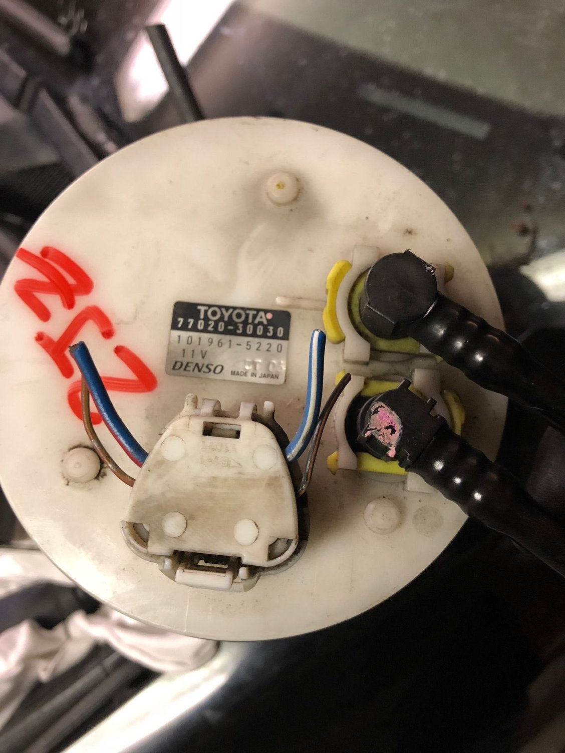

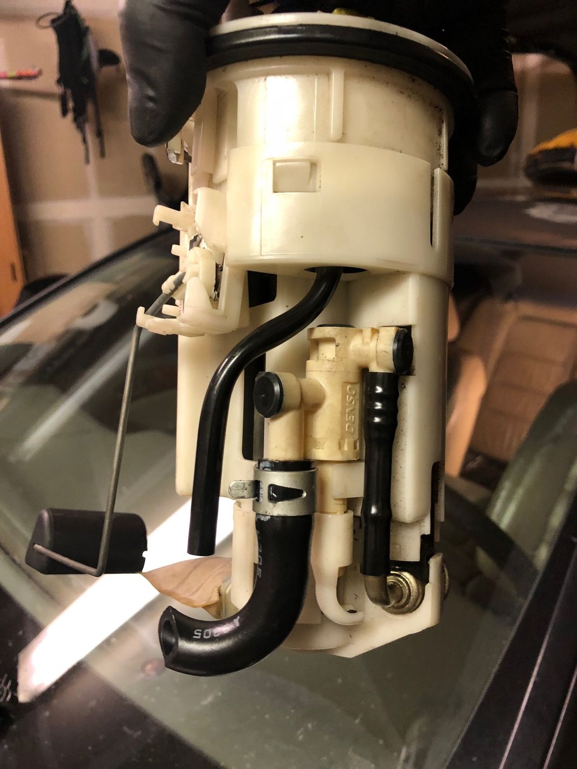

I picked up an Aristo fuel pump assembly and had a chance to install it tonight.
