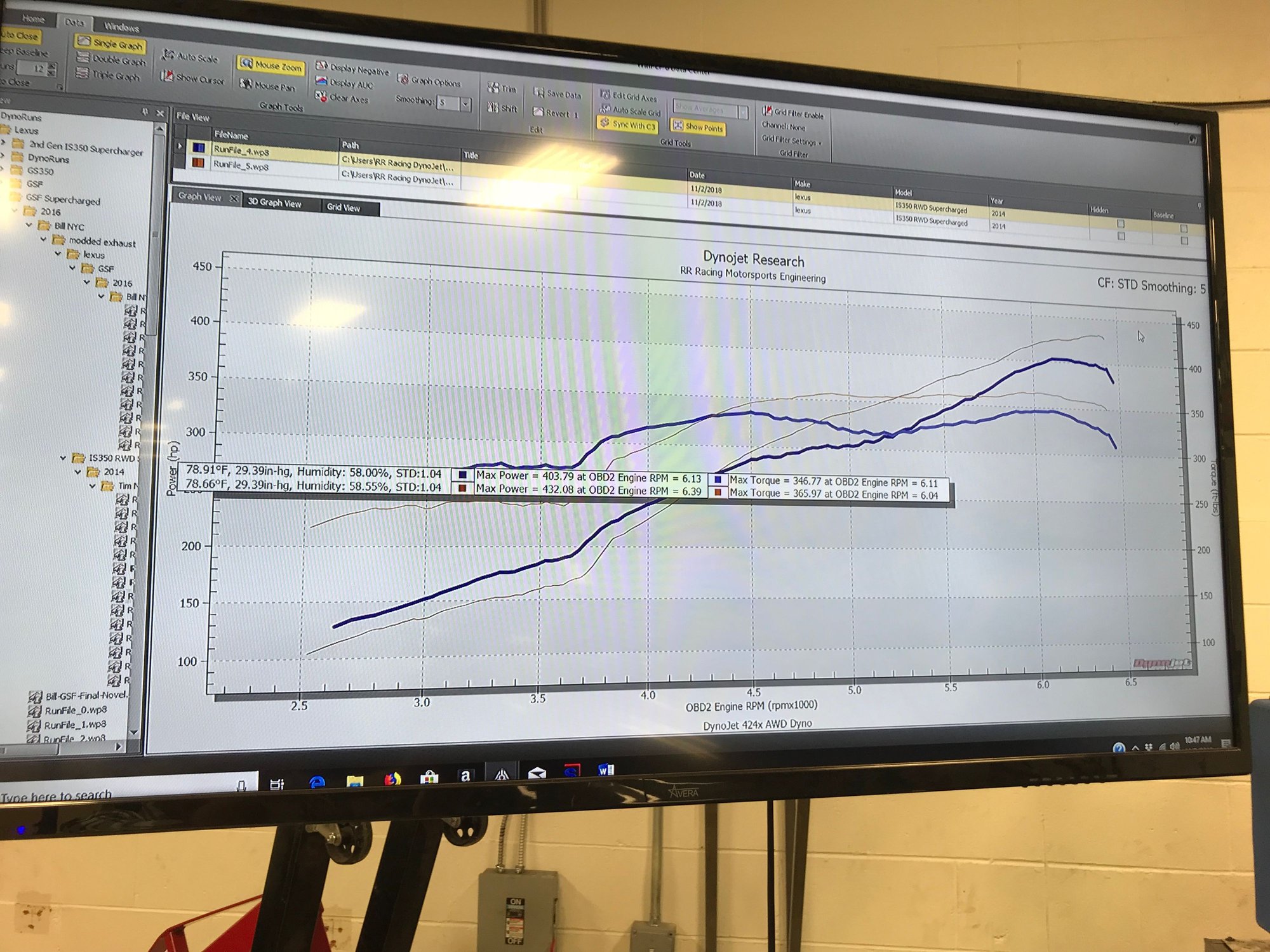

Alright here we go!!!!
409whp with 93 octane
430whp with %30 e85 mix
very happy with the numbers only thing To improve now is the smaller pulley wich would get me to 450whp but I am satisfied with where the car is at now

So does the power actually taper at 6.2k rpm or is that just the limiter kicking in? It seems that the e85 have much better top end.without tapering.

the power continuous to climb with the e85 after 6.2k the graph just doesn’t show it so actually I should be up to like 440 ish
