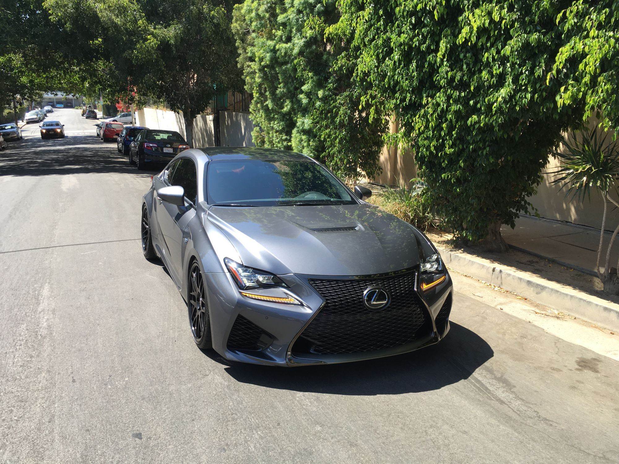

Owners treated me and ride very well. Pride in work. Glory in the details.
Here's how she sits today. Zero gap rear. 1-2 finger gap front for a level and balanced factory look. Added the JDM factory rear molding extensions.
