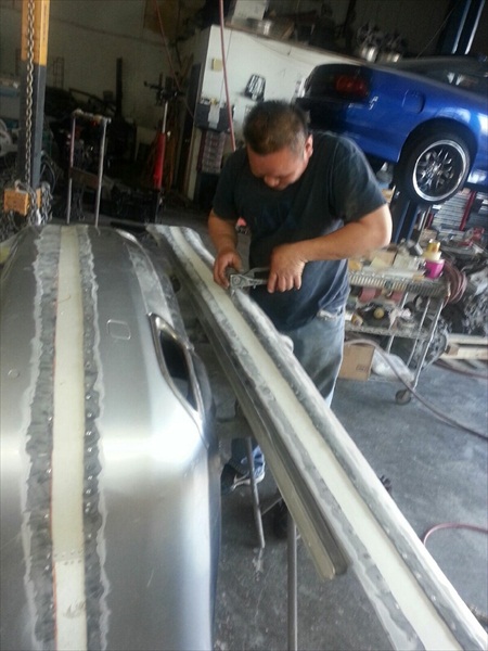

CIC Auto added 2 inches to the entire surface on all 4 pieces.
here's a general overview of how they completed this mod:
- locate and mark an area where the cutting will take place. CIC Auto also used tape after marking
- find fiberglass or hard vinyl to connect to the 2 halves together. CIC bought this from Home Depot
- cut the material to the desired length and width. if you want to do a 2" extension, then make the width 4", 1" above and below the middle of the 2" extension area
- rivet and glue the material to each half
- apply fiberglass and bondo, then sand
- once you get the correct shape, apply prime and sand
- when everything is looking perfect, apply paint and clear coat.
below are some pics from CIC Auto:
Attached Thumbnails yottabyte's LS460L Build Thread-1.jpg   yottabyte's LS460L Build Thread-3.jpg   yottabyte's LS460L Build Thread-4.jpg   yottabyte's LS460L Build Thread-5.jpg   yottabyte's LS460L Build Thread-6.jpg
