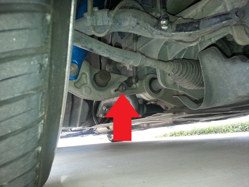

Originally Posted by 96zenki
very nice. i would love to see how you adjust the sensors as my heights are not the same with my data systems controller. if you don't mind sharing how much did your set up cost? i'm looking into aftermarket air set up in the future and would like a ball park. i plan to go with accuair elevel as well. it seems like alot of people are going with airrex as well.
below are four pics of where you can adjust the height sensors in the the following order:
- 1st pic is for the front right. This is at stock level. I had to adjust it back because the data controller was having issue lowering the front. Sometimes it would work, other times it would not. I believe if you want your car to be lowered, you would loosen the bolt, remove the tab from the hole and turn the bracket counter clockwise then tighten the bolt. I would recommend turning the bracket slightly and see how the data controller reacts to the adjustment.
- 2nd pic is for the front left. To lower your car, do the same as above but rotate the bracket clockwise.
- 3rd and 4th pics are for the rear right and rear left, respectively. I believe this is where Drew made the adjustment. I didn't play with this because the data controller worked properly with this setting. You would have to raise or lower the bolt and see how the data controller react.
