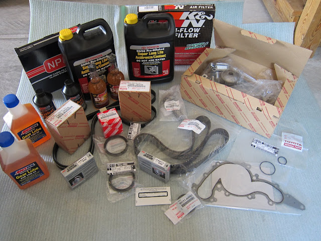

After the loss of the 2001 GS300, I wanted a 2006 Lexus GS430 and after over a month of looking around I picked one up from Florida. Like with its predecessor a complete overhaul was planned. Usually the first things I change are the HIDs, leds, wiper blades and a JDM squash air freshener . My wiper blade of choice are the PIAA blades and I would recommend them to anyone. Stock HIDs are replaced with 6k and the fog lights and high beams are changed to 6k HIDs too. I have a mini tech system now so was able to turn off my DRLs in order for the HIDs to work.

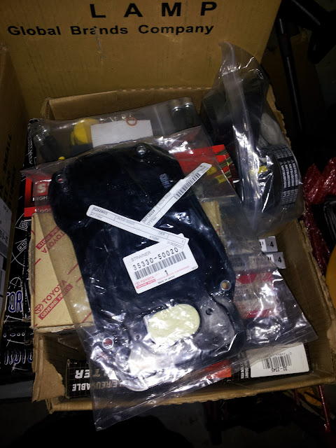

Prevention is better than cure, so with this mindset all maintenance parts were ordered.
MOTOR MAINTENANCE:
Toyota (90916-02586) Multi Rib Belt
Toyota (13540-50030) Timing Belt Tensioner
Toyota (13505-0F010) Timing Belt Idler
Toyota (13503-0F010) Timing Belt Idler
Toyota (13568-09070) Timing Belt
Toyota (16100-59275-83) Water Pump w/Housing
Toyota Water pump O ring (96761-35025)
Toyota Water pump gasket (16325-31010)
Toyota thermostat (90916-03100)
Toyota thermostat gasket (16346-50010)
Toyota Coolant (00272-SLLC2)
Toyota Valve Cover gaskets (11213-50031 & 11214-50011)
Toyota Spark Plug Gasket (11193-50010) x 8
Toyota Throttle Body Gasket (22271-500042)
OEM Front Main Seal (90311-A0001)
OEM Camshaft Seal (90311-A0004) (x2)
NGK Plugs IFR6T11
K&N Air Filter
Amsoil Performance improver APICN (x2)
Seafoam SF16
Seafoam Deep Creep
TRANSMISSION:
Amsoil transmission fluid (ATLQT) 12qt
Seafoam TT16
Toyota Transmission Filter
Toyota Transmission Pan Gasket (35168-60010)
All lubricants: engine, transmission, brake, differential and power steering fluids are going to be cleaned, flushed and replaced with Amsoil fluids. A seafoam treatment, throttle body cleaning, cabin filter and battery replacement are also in the plans.

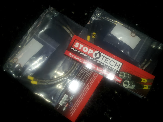

I also chose to go with the StopTech stainless steel lines which also has Teflon outer jackets. Previously I had Rotora lines but again Rotora doesn't make rotors or lines for the GS430.
StopTech Front SS lines - 950.44003
StopTech Rear SS lines - 950.44504

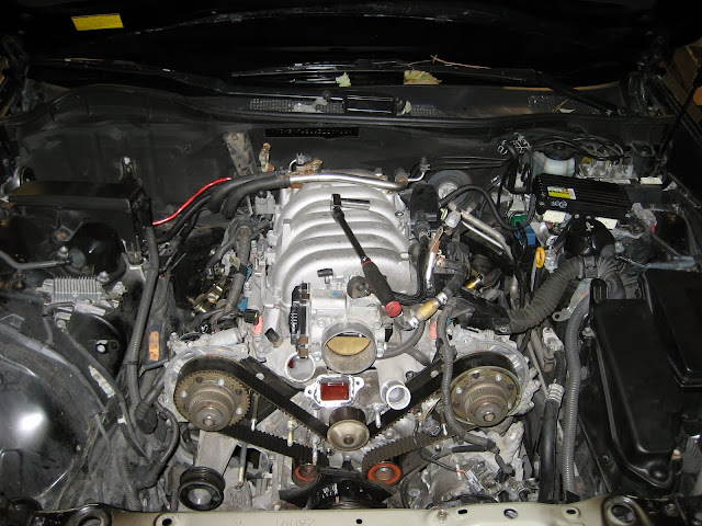

With all my maintenance parts together and collecting dust, it was high time I started installing everything. Prior to installation I tried to clean out the engine, injectors etc as best I could. To achieve this I did it in steps and used a couple of products. First I used seafoam, 1/3rd in fuel tank, 1/3rd in crank case and 1/3rd through a vacuum source to the intake. Drove for about a 100miles or so and in another half tank of gas added some Amsoil Performance Improver. Drained and filled oil using some regular shell oil and added some more seafoam in crank case. After another 100 miles pulled it in for all the maintenance work.
Have known the guys at Turbo Time in Cary, NC for years and they were kind enough to let me use their facility to do all my maintenance work. Which with the weather we chose to do at night, even though their facility is air conditioned. Matthew Meadows offered to help me with this endeavor. When I mean help, I mean he ended up doing 70% of the work. LOL. It is an absolute pleasure to work with someone as picky as I am so everything went fairly smoothly. After running through a plan of action with Matt we got down to it.

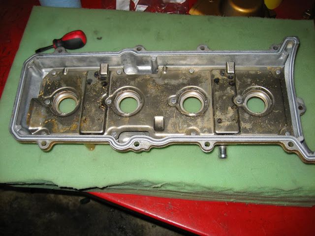

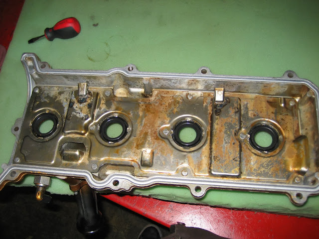

Tore out the valve covers, cam caps, throttle body etc to start changing gaskets, seals etc. While all the parts were out I wanted to accent the engine bay and make that part of the car look good as well. Had a vision in mind when I was doing this so hopefully it turns out as well as I picture it when I complete it. All the parts were media blasted and put through a parts cleaner, ready for paint. I used a high temp Gold and put a couple of coats of clear over it for some depth.
The throttle body was pulled out and was thoroughly cleaned out as well.
The spark plug gaskets were replaced as well from the valve cover.

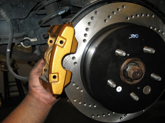

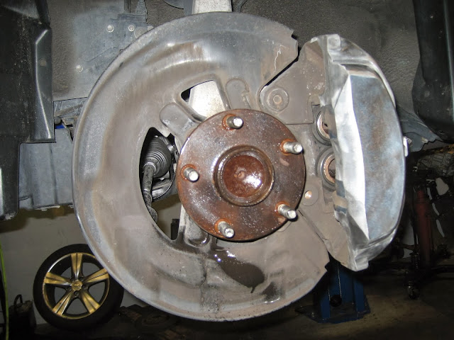

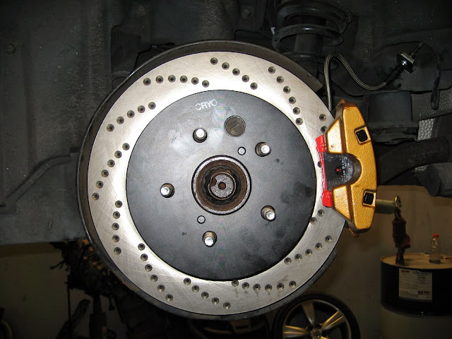

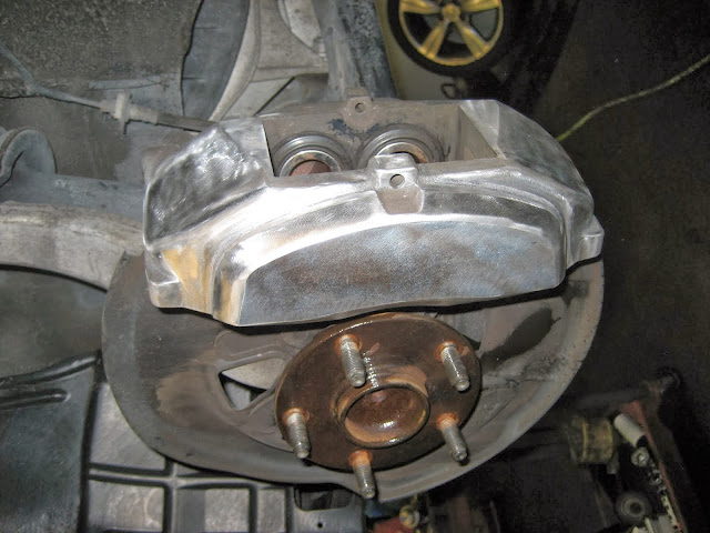

Pulled off all the rotors, cleaned out the rust on the hub and sprayed on a rust prevention coating before putting on rotors. Well also had to accent the calipers too.
Notice how the pins for the calipers are black, that was Matt's idea. Can't emphasis how much easier it is to work with like minded individuals. Also in the pic you can see the stainless steel line installed as well.
If you notice the calipers here it doesn't have a texture anymore. Matt smoothed it out before it got paint. Unfortunately with it being like 8 in the morning and exhausted at this point I forgot to take pictures of the finished product. Will do so at a later time but it looks clean.
Took another break for breakfast, where I was introduced to McGriddle. First time!! AMAZZINGGGG!!! Armed with McGriddle and some Mocha. ventured back into the shop to finish everything up. Thankfully Dustin Anderson stopped by to check on us in the morning and he stayed and helped finish things up.
With the brakes on, bled the system of all the old brake fluids and was replaced with Amsoil's brake fluid. Drained a little bit of the transmission fluid and put some seafoam transtune to help clean out the transmission.

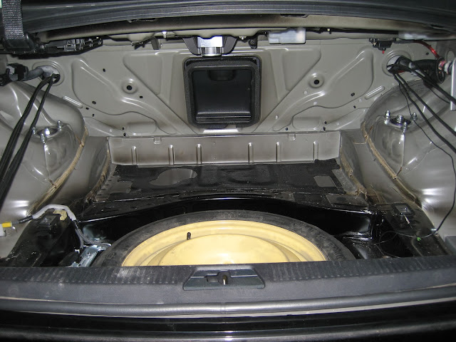

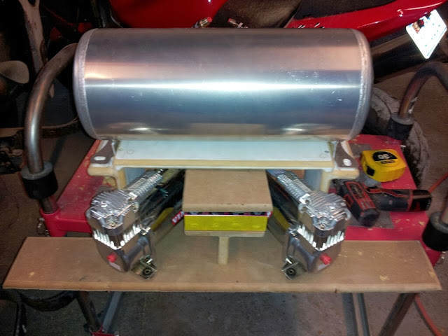

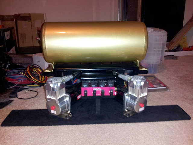

Before getting the suspension stuff installed I wanted to go ahead and make a pod setup for the trunk. Trying to keep the footprint small so tried a couple of ways to mount things and this is what I thought might work.
Built the structure out of mdf, made sure all the parts fit well on the mount and in the car.

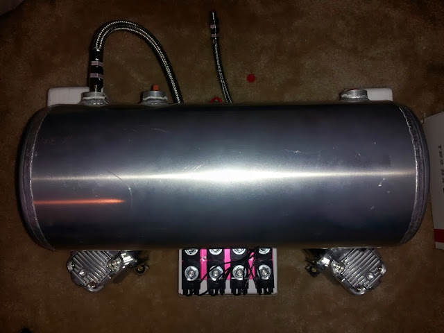

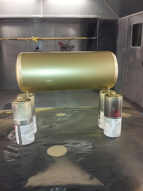

While the tanks was out, decided to get the tank painted before it goes in.
Wrapped the bottom mount with suede and the top half was wrapped in high gloss black. Wired everything up, all wires were soldered and heat shrinked also used loctite 567 for all the air fittings to ensure a good seal.
All wired and mounted.
The tank looked a little bland so threw this design together and cut it out to spruce it up a bit.

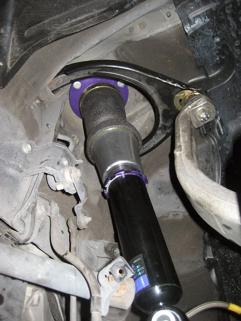

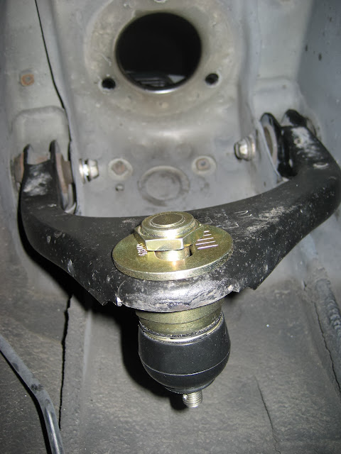

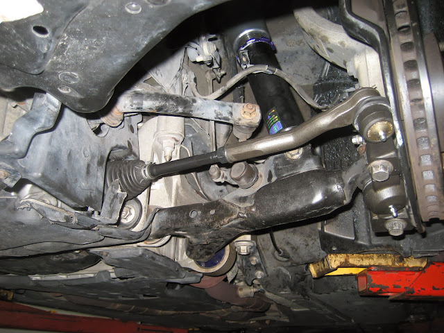

First task: Front upper ball joint.
SPC Front upper ball joints for an IS300. Slight simple modification to the control arm to make it fit.
The outer ridge of the UCA was shaved down a bit to allow full range of motion for the adjustable ball joint.

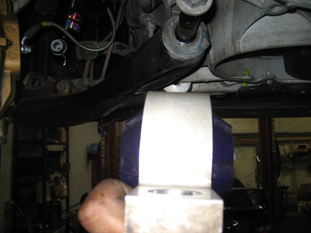

The caster bushing from Figs Engineering slid in without any issues. Check out stock vs the polyurethane bushing video from
Removed and replaced inner, outer tie rods and ball joints.
Installed coilovers. All the lines were ran through the frame rail underneath the car and tucked out of the way to avoid any issues.

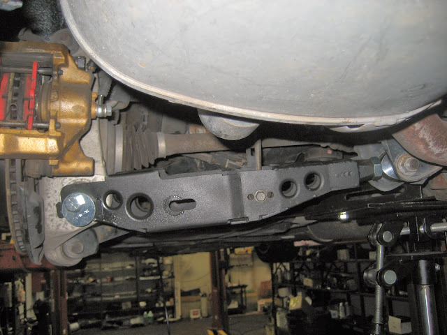

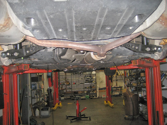

Installed the Rear Figs LCA and the toe links.

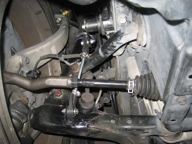

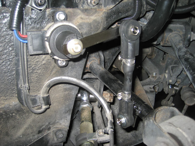

The biggest hurdle in this whole ordeal was the installation of the ride height sensors. It might have been exhaustion kicking in but Matt and I had to take a break and walk away from setting up the ride height sensor.
The sensor wires were ran through the inside of the car and everything junctioned off in the trunk.
In the rear this is where we ended up mounting the ride height sensor. A bracket was welded to the arm so that the sensor can be functional.
In the front a bracket was welded to the LCA for the sensor to be functional.
When mounting the sensors there were a lot of issues we had to think of.
1) The sensor not getting in the way of the wheels when wider wheels were put on.
2) The sensor being out of the way when the wheel is turned inwards
3) The rods attached to the pivoting arms not being in the way of any other moving components.
4) The range in which the sensor is functional.
For the range for the sensor to work it meant a lot of tweaking / cutting / re-drilling etc to get the sensor to read right.

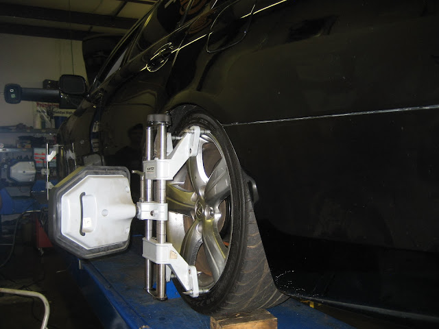

After a break and a much needed snooze we wrapped things up and dropped off the car to get aligned.
Started at about 8:00pm on Saturday and got done about 10:00am on Sunday. A long weekend !!
Got the car aligned and at the ride height in the picture I am at -0.3 degrees in the front and -1.2 degrees in the back.

More suspension stuff:
Old Oct 10, 2012 | 05:26 AM
Boron's Avatar
Boron
Joined: Feb 2012
Posts: 583
Purple - D2 presumably?
Yup D2's
