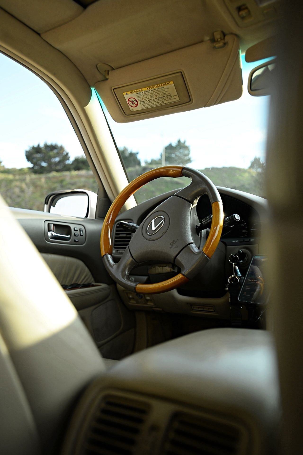

Tilt steering wheel worked flawwlessly

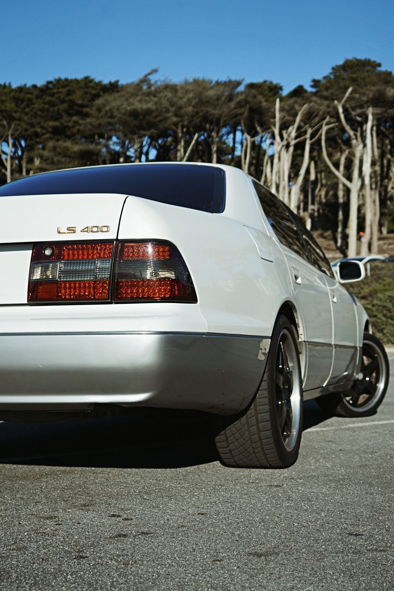

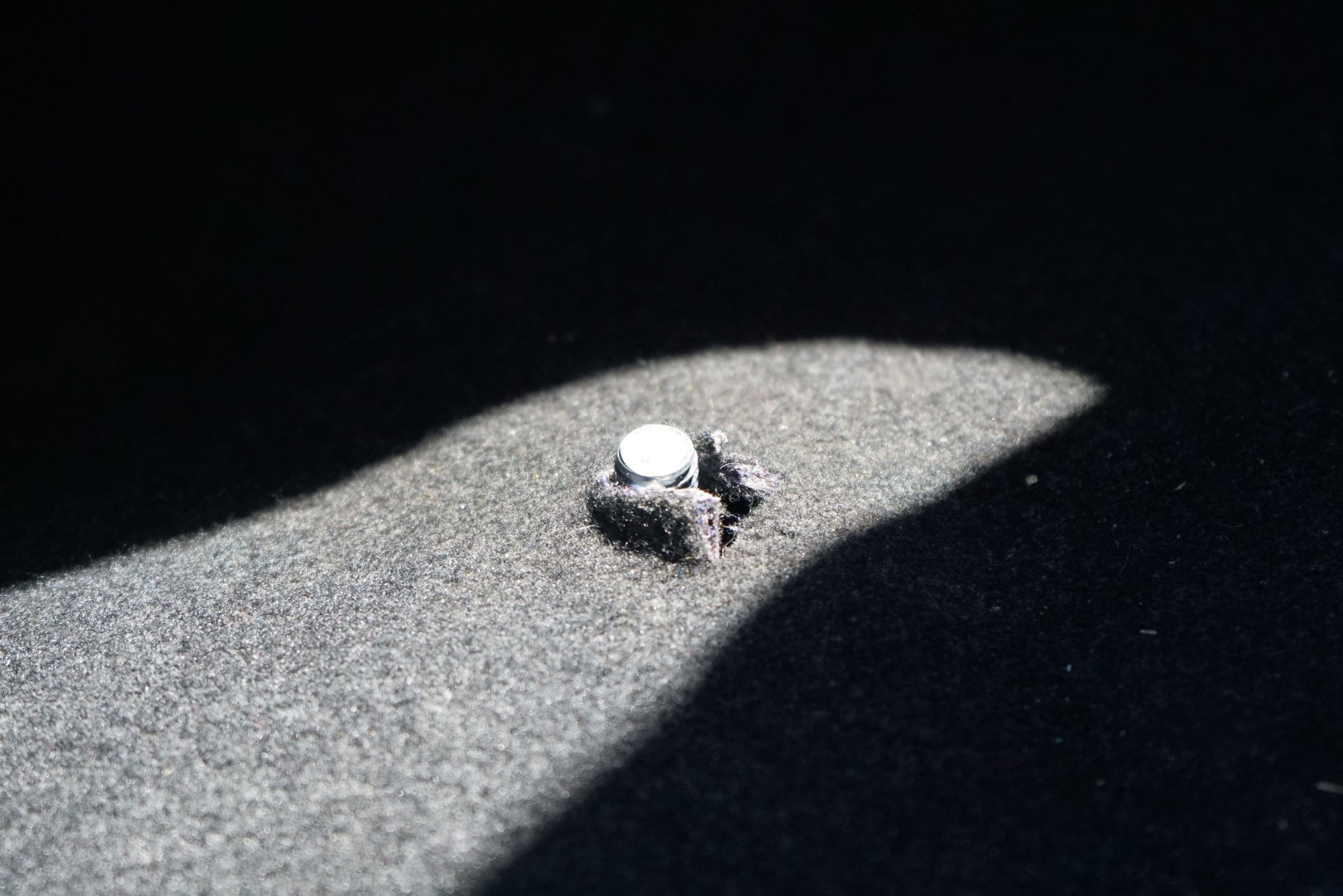

Small rear bumper damage from a fender bender

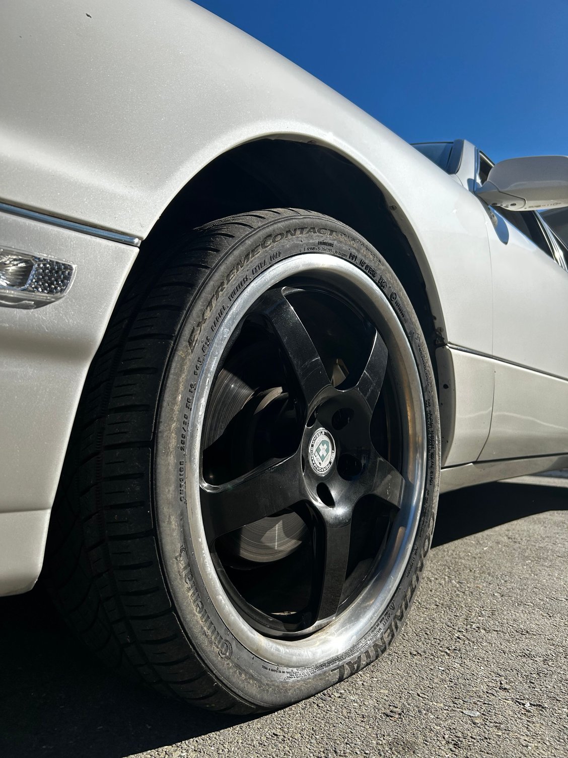

19" HRE wheels on Continental DWS06+
This wheel and tire combo feels great on the car. The unsprung weight hasn't changed much due to the wheels being aluminum. I can drive in the wet with much more confidence than the aged Michelin Defenders offered. 255/35 is smaller diameter than OEM and hard to find so will look at going to 245/40 when I need tires. The NVH is a couple of decibles just from rolling resistance and having a smaller sidewall than stock. They quiet down as they wear in a little. The DWS is a do it all performance all season tire that still has fairly good treadwear. I leaned on the car a little with these on and they held up the whole time. They do have a rounded and softer sidewall, so they flex more. I found out that I rolled about halfway onto the sidewall following a modified BRZ one night.

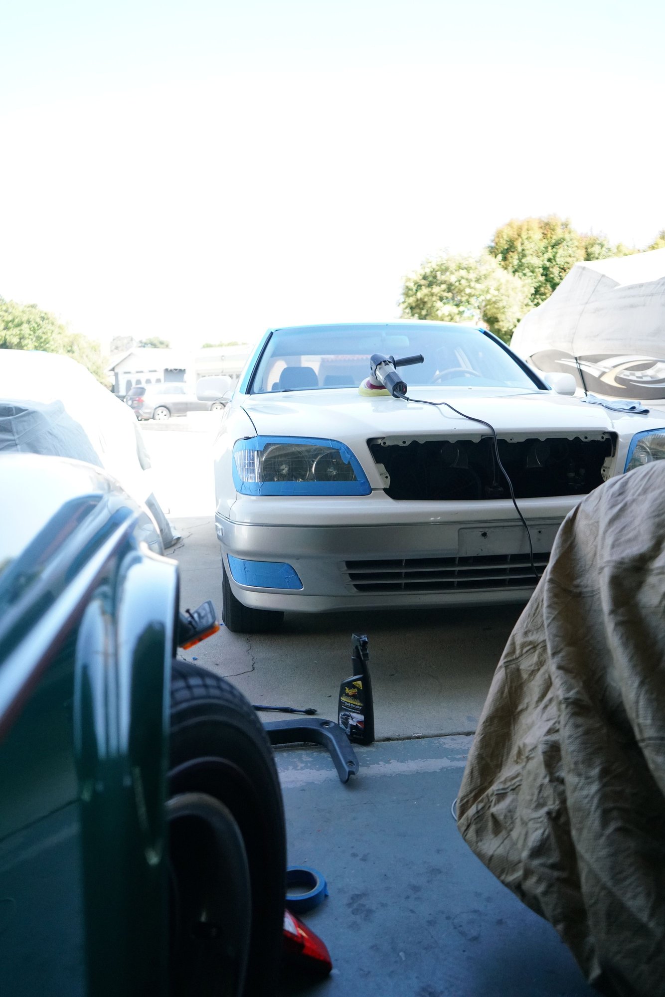

Masked the front end to buff the paint

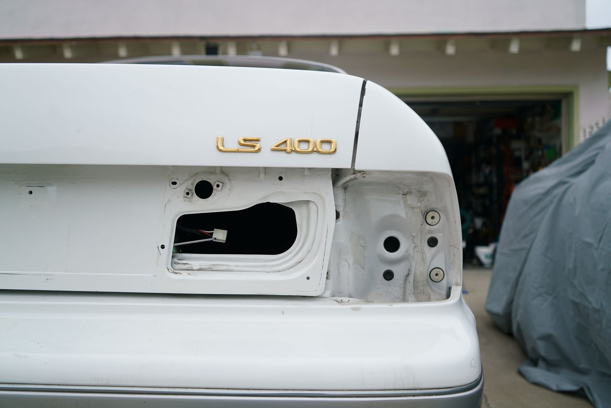

Pulled the rear tails to buff the trunk panels and clean behind the tails.

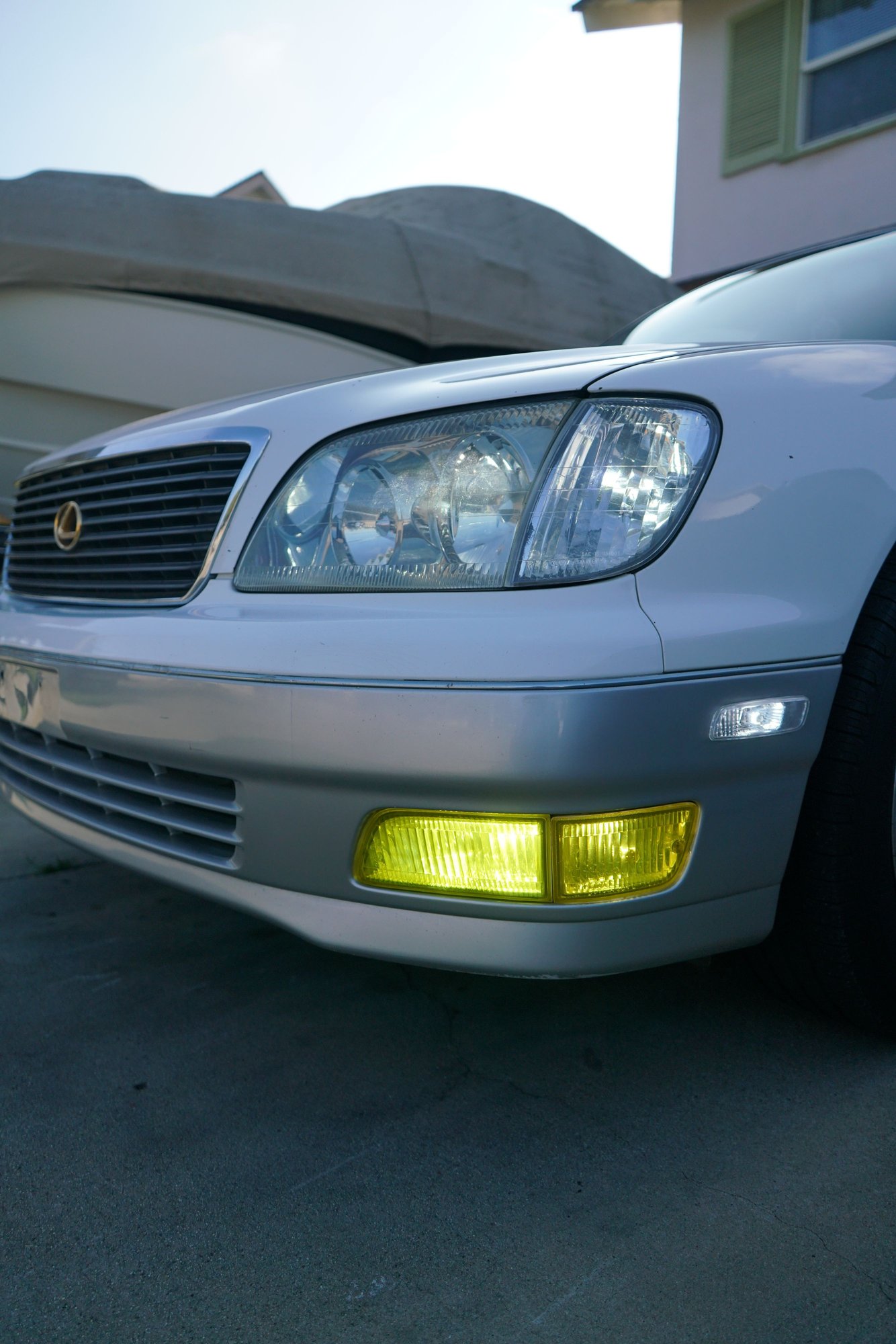

Post paint-correction. Cleaned up well, wrapped fogs in yellow Amazon film.
Closer look at cleared corners, modified fogs output, and clear side markers during the day.

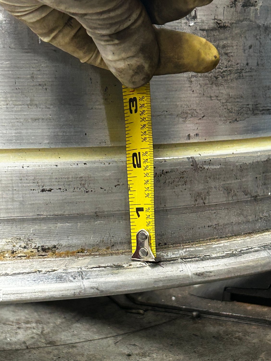

Test fitting and taking measurements off of 19x10 ET -5 Autocouture Supreme wheel
Test fit and measurements off of 20x9 ET +20 Lowenhart LD5

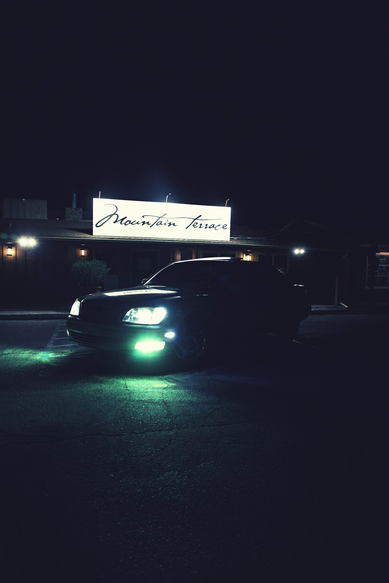

Beam pattern from modified fogs, switchback corner lights, and white side markers. My car runs HIDs so non LED lowbeams (not a fan in reflector housings anyways). I am running some super bright Auxito 6500k HiBeams, though. Specific model is discontinued but had them for 3 years dating back to the ES. I dont get flashed for having bright lights since everything is aimed properly.
Beam pattern from modified fogs, switchback corner lights, and white side markers. My car runs HIDs so non LED lowbeams (not a fan in reflector housings anyways). I am running some super bright Auxito 6500k HiBeams, though. Specific model is discontinued but had them for 3 years dating back to the ES. I don't get flashed for having bright lights since everything is aimed properly.

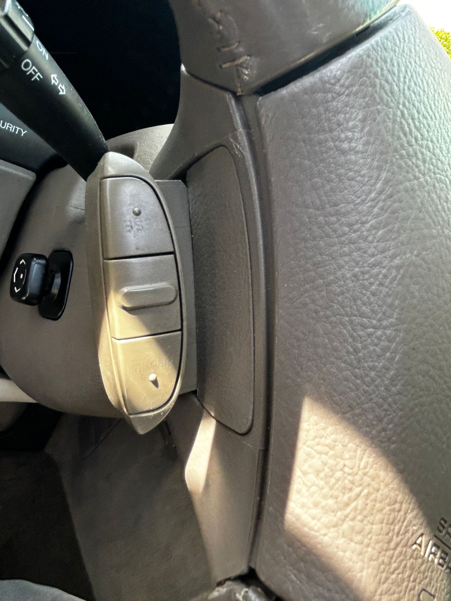

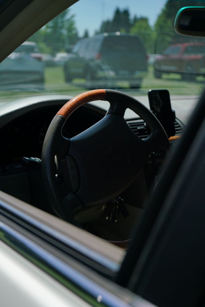

RX300 steering wheel mounted up. Bag was plug and play. Swapped my cruise control over. Woon grain is yellower than I hoped. Wish I pulled the RX wheel out of my ES before I junked it. Wood grain on that one matched better.
Function controller added to the RX wheel using the phone mounting bracket. It is inverted horizontally. I grounded it to the RXs cruise control grounding tab since the LS CC didnt need to be grounded.
Function controller added to the RX wheel using the phone mounting bracket. It is inverted horizontally. I grounded it to the RX's cruise control grounding tab since the LS CC didn't need to be grounded.
Trimmed the cover panel to close the gap. I can rotate the controller to be able to remove the panel when needed.
Better photo of the RX wheel in the car. Note my wireless charging phone mount attached to the transmission tunnel.

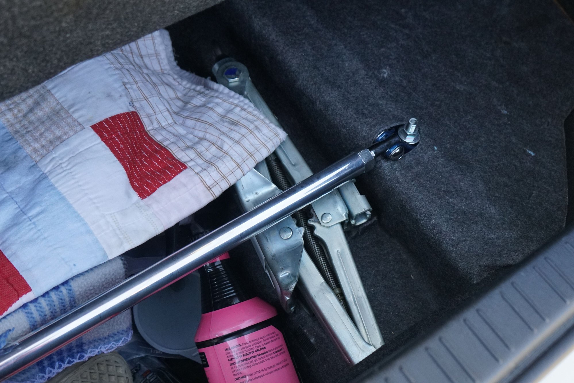

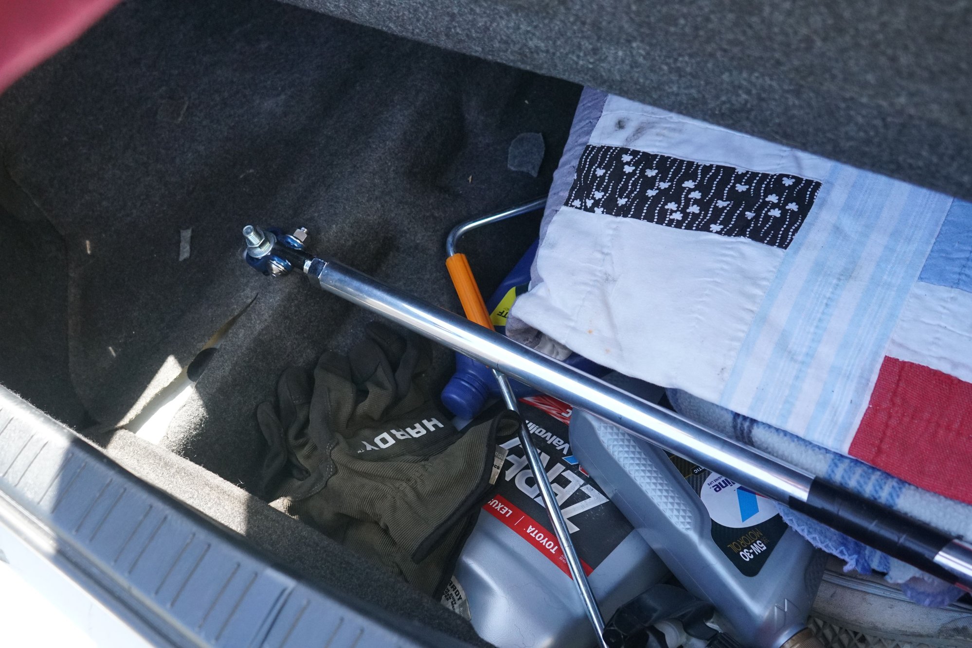

How much the trunk brace bar sticks out of the carpet. Need to see about finding/making a cover for these.
Passengers side mounting of the trunk bar. Used OEM holes to mount.
Passenger's side mounting of the trunk bar. Used OEM holes to mount.
Drivers side mounting of the trunk bar. Ignore extra use of storage space.
Driver's side mounting of the trunk bar. Ignore extra use of storage space.

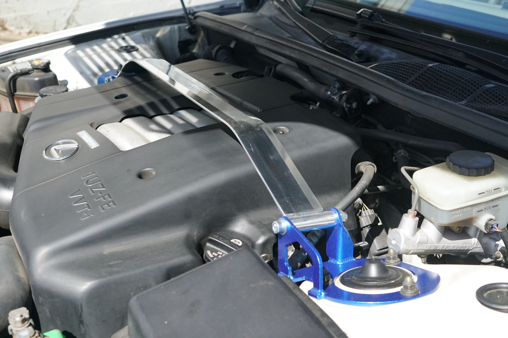

Cusco front strut bar. I swapped the sides of the mounts so that I could clear the brake master cylinder.
Wider view of Cusco front strut bar.

Front wheel shot. 3 piece HRE 895Rs. Probably going to disssemble, clean, and strip the black paint off the faces. Not sure yet.

Rear Lip size measured on 19x9.5s
