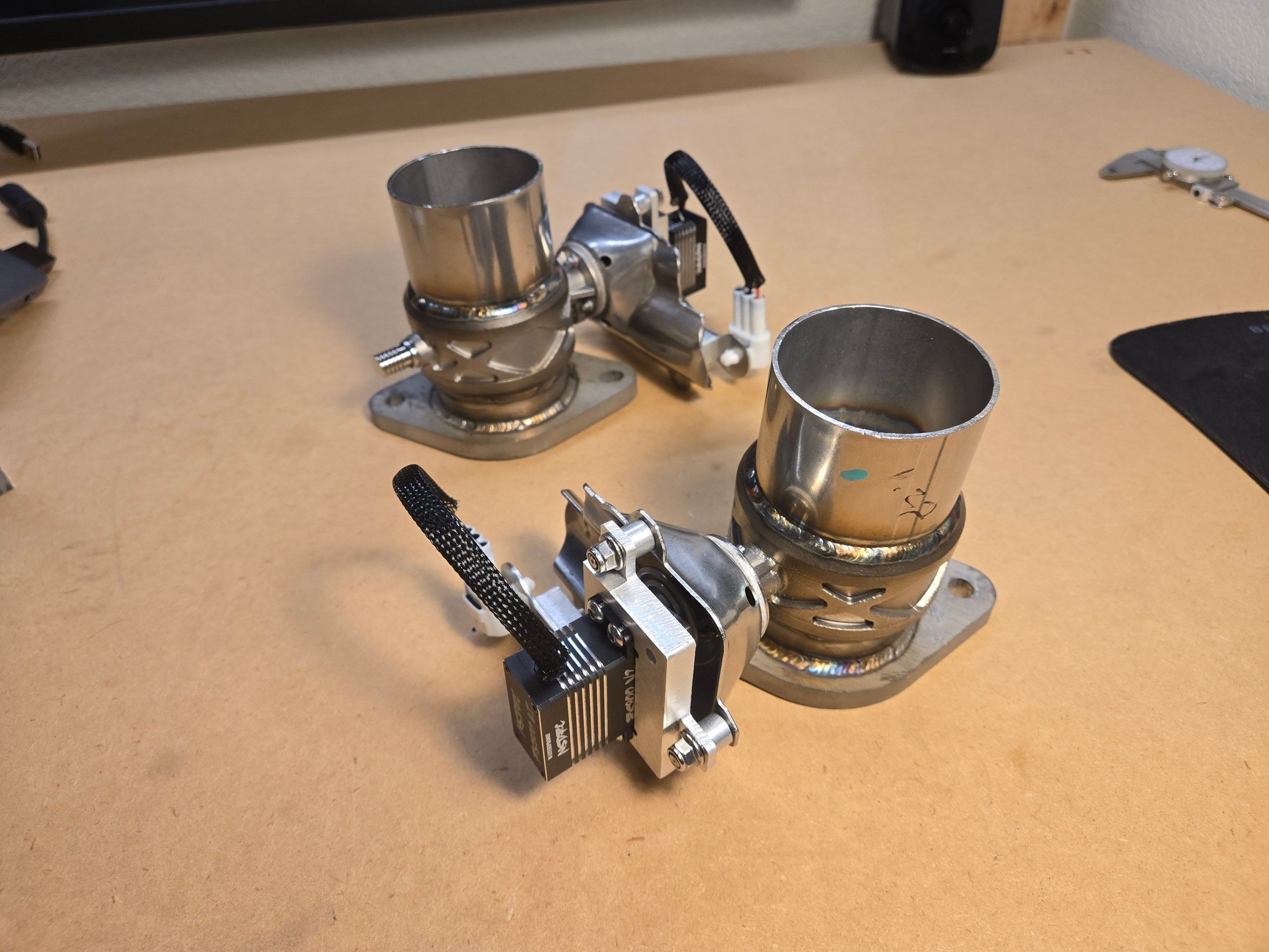

I wanted a super reliable system so I opted to go with a OEM Roush exhaust valves. All the OEM valves require proprietary signals from the engine computer to operate them, so without the knowledge on how to reverse engineer the software I opted to install my own motors on the valves that I could easily control with an Arduino style microcontroller. I fabricated some custom hardware to adapt my motor to the Roush valves. I used a high torque servo made for RC car steering systems and its plenty powerful and fast.
This is the valves how I bought them
And after adding the servos
