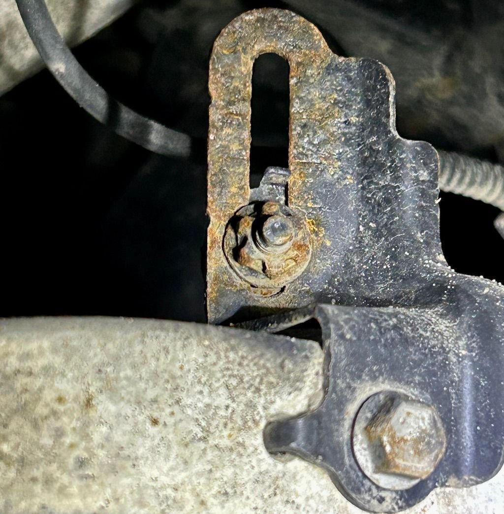

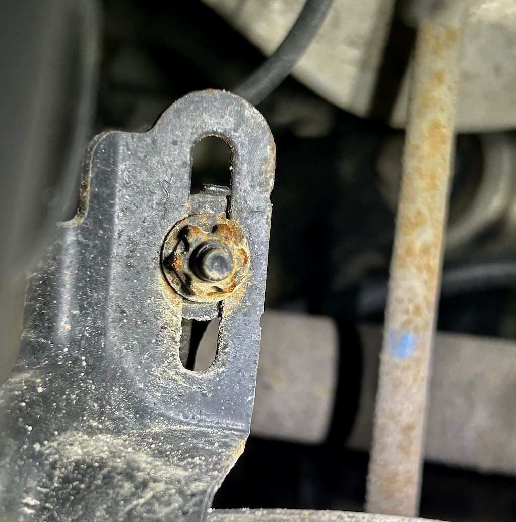

4. Front left air suspension was riding low, back left was raised. Dropped back right sensor to try and level, will be raising front left as well to fine tune balance. Bags hold air just fine, and imbalance is consistant in HEIGHT HIGH.

When you adjust with the height sensors it can take awhile to get things consistently even at whatever height you're looking for because of the way the sensors act/react with each other.

With the height sensors, I've dropped the rear right quite abit, probably half way down the bracket to get things fairly even. The rear left is pretty close to the top of the bracket, so I need to squeeze into the front and adjust those I think, otherwise just peave the sensors uneven (but car is balanced) until I can get into Techstream and set properly. Was looking at the nano device with V12 Techstream on windows XP 32 bit mentioned in the SC threads.

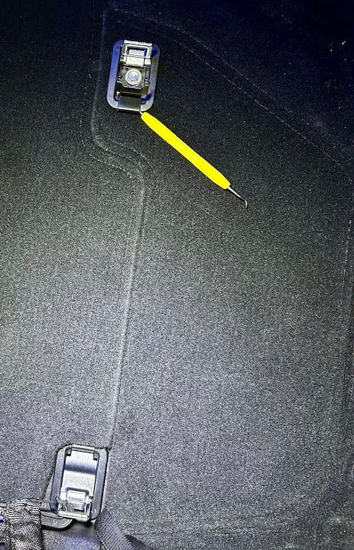

Regarding the trunk liner.. I've got all of the black Christmas Tree Clips out (without breaking any...woot), and the 10mm bolts under the cargo net anchors as you mentioned, but seems to be a few white fasteners that have square stems and a round face with a hole through the center. Havent found part number or replacements, so don't want to pry too hard in case I break them. Will post pics once home.
You can set the ride height with techstream to whatever you want individually on each corner but there is no way to save those settings and the car will revert to defaults on the next startup.
For me the existing adjusting links were simpler but took a little longer. Measuring from level surface through the centre line of the wheel to the bottom of the wheel arch...with stock 19"s and original tire sizing I have 27.5 inches front and 27.75 rear. Any lower and the car would scrape over some speed bumps. It would be good to know what your height ends up to be.

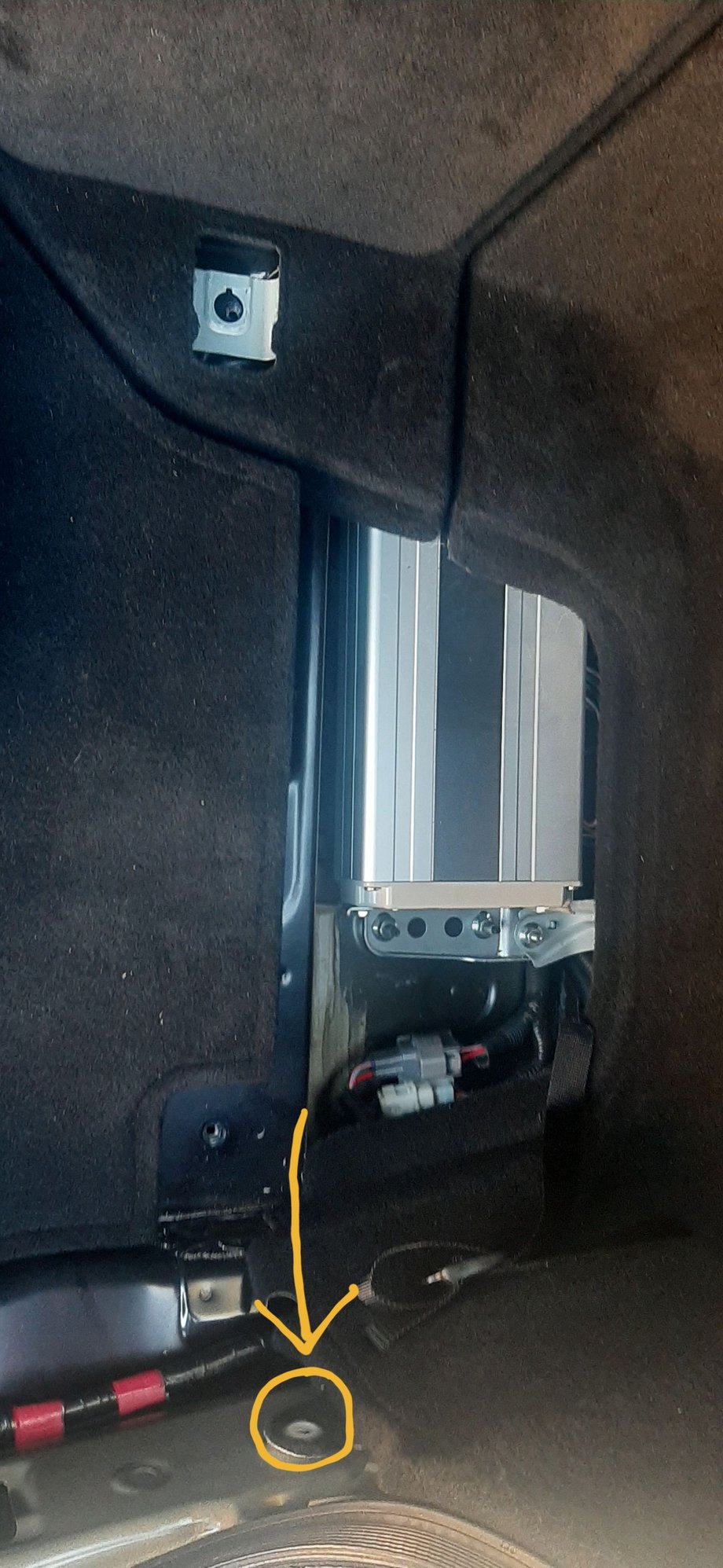

You are correct indeed, power on left, amp on right, just about to take some pics.
Sad days if ride height can't be saved. Guess Ill work with the physical brackets in the meanwhile. Will also send pics of 4 corners before and after.

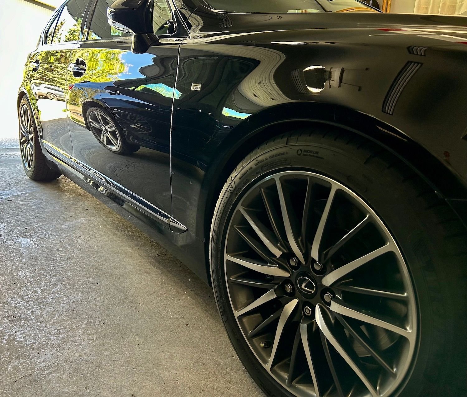

Im liking your height as well. You say you feel that's the lowest you can comfortably go?

Hey Gerf,
Here are some pics for the retainer clip giving the headache. Should be the last one before I can pull back the right side liner the access both ends of the amp (but there's always one more). Last bracket for amp is underneath liner at top right of photo 1. Seems to be quite stiff, but I believe there will be enough room if I can remove this white retainer clip.

What I do there is just lift up the area about in the middle of the amp and use an extension with a 10mm socket and loosen the bolt that attaches to the back of the wheel well, then keeping the panel lifted just reach up there and take it out by hand... disconnect the neg batt terminal first.
You can disconnect the connectors right there and bob's your uncle.
I think yours might be higher by the way I measure but look more
slammed because of the 22's, not sure though. I know after lowering with the links the height high doesn't look so ridiculous.

I think when I had mine apart I worked the felt panel over the white retainer and took it out afterwards, you'll need to take the trunk seal off also.

I think yours might be higher by the way I measure but look more slammed because of the 22's, not sure though. I know after lowering with the links the height high doesn't look so ridiculous.
Its a bit tight squeezing in, but I could try your recommendation of pulling the liner around the fastener first. I've also been extra careful so as not to bend or rip anything, could probably put some more force into it though.
The front on mine is about as low as Id like, as I already scrape on 50% of driveways into businesses on Normal Height, can maybe afford another 1/4". Would like to drop the rear another 3/4" or so though.

If you have the right removal tool for that white fastener it should come out, I put some speakers in a car today and I thought the door panel/card was going to break for a second but it didn't. helps sometimes if you warm them up when they're exposed like that.

And you are so right about the dance. At first I was removing the front links completely to re-measure,, what a pain. Decided it was best to keep the tops bolted in and just rotate the bottom of the links as needed (as evenly as possible). But it's funny, my back links look almost identical to yours with regards to "un-eveness", just reverse. My rear right is all the way down, rear left about 1/3 up. Right now Im pretty sure my front left is riding about 5mm lower, where the link itself (front left) is extended about an extra 5mm compared to front right link.
I'm happy with it, but could probably extend front left another spin counter clockwise for more accurate and even ride.
Its killing my OCD that the sensor links arent even, but balanced ride height definitely takes priority haha.

I took my front height adjusters off and cleaned and lubed the threads/lock nuts etc so I could just loosen the nuts and then adjust with the square in the middle of the threaded shaft without taking anything apart.

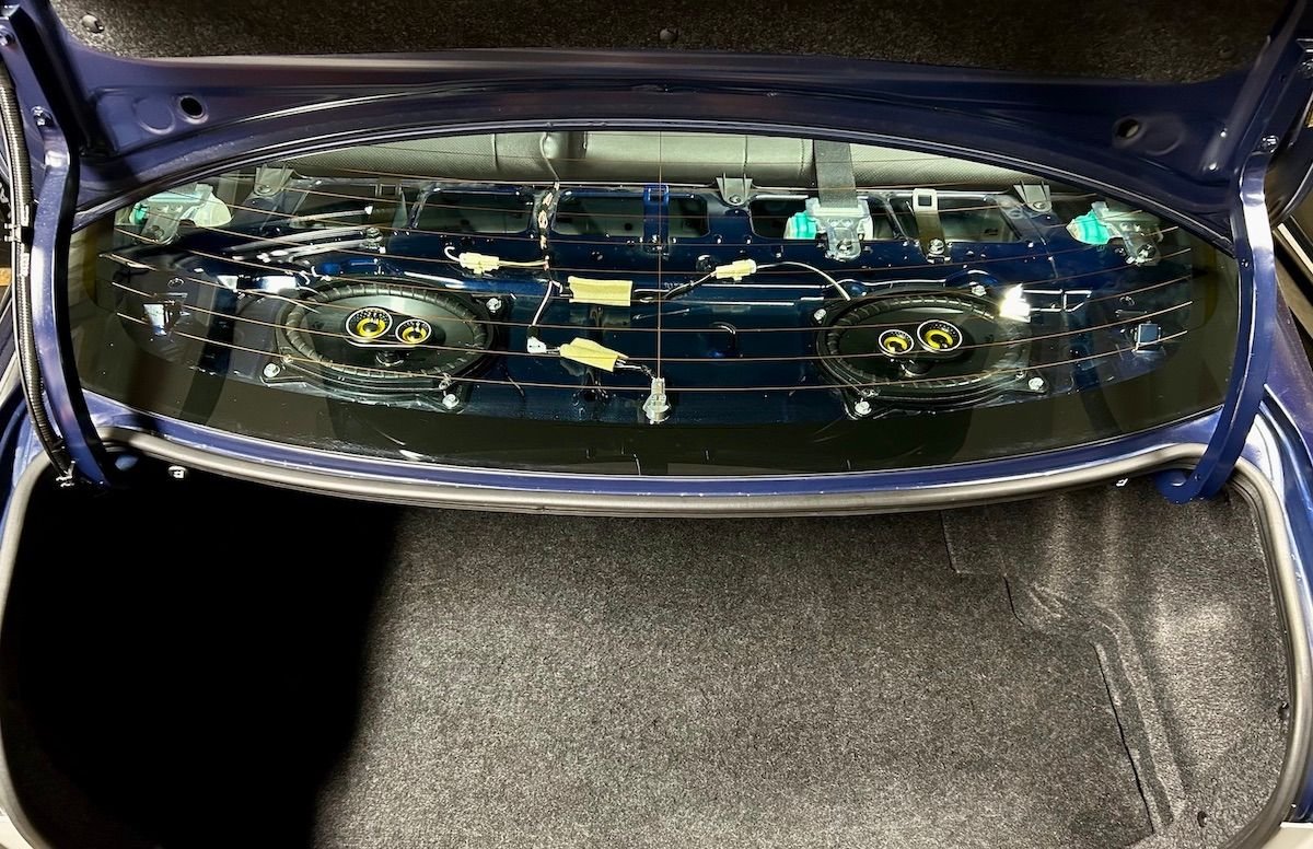

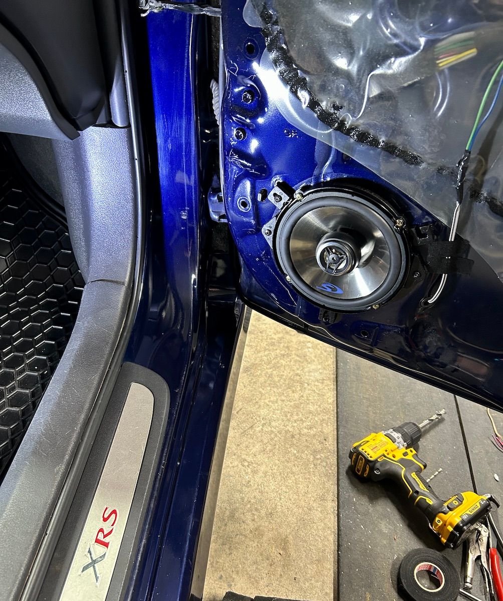

The speakers were fairly easy, replaced the originals and I have an Alpine V12 4ch amp to put in next. This is for another car that my grandson thinks he's going to get from me because he is working on getting his license.

On the 460 it was the premium/base system, I just put an Alpine V12 mono amp and a 12" sub plus an LOC to get the input for the amp running the sub. I replaced 6 other speakers in the car doors and dash running off the original amp and it's a lot better. The XRS I just replaced 4 speakers and kept the oem tweeters, it doesn't have Nav.
