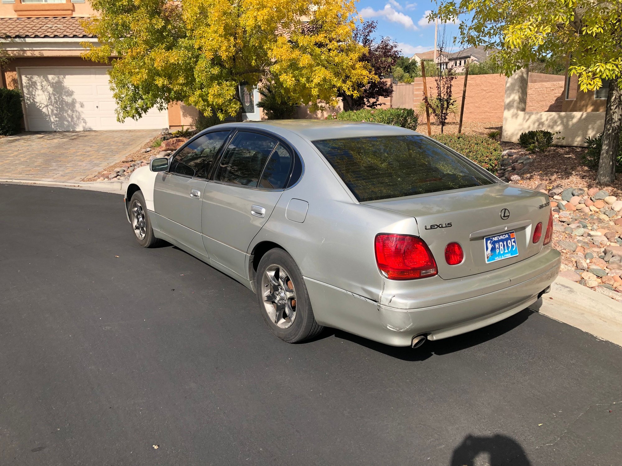

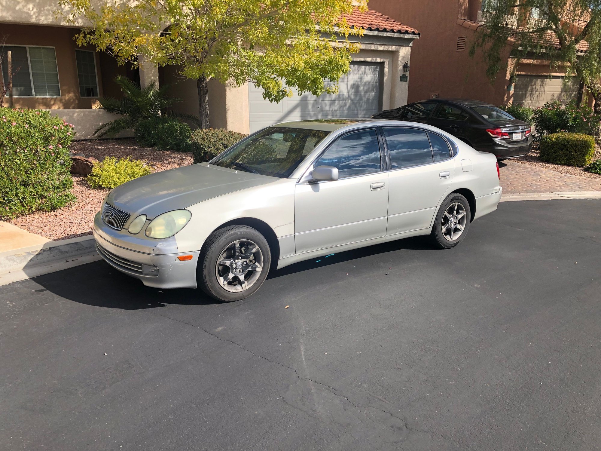

I've been driving Lexus/Toyota's more or less exclusively for the last 13 years (I cheated a little and got a Turbo BMW and Had a WRX for a while) I had been missing being in a Toyota and even more so me never getting to knock one of my bucket list builds off. I had always wanted a really cool JDM Drift streetcar, 4 doors, tons of style and just enough power for it to be fun, reliable and get me from point A to B looking clean. I saw this Mechanic's Special listing on FB Marketplace with a decent looking 02 with Black Emblems and then on one of the pics I saw the Interior and a Badge on the good fender and knew I had to have it. I had a 03 Sport Design that was my unicorn and it got stolen right before my build was going to begin and ever since then I had an itch to get another one but they're still pretty hard to find. Good timing with me selling my grocery getter Honda Crosstour I was using for my business. I'm keeping this post to document the build and have something to show for in case I ever sell it or want to show off a little. I have some work ahead of me before this becomes a cool JDM Streetcar. Lets get into it.

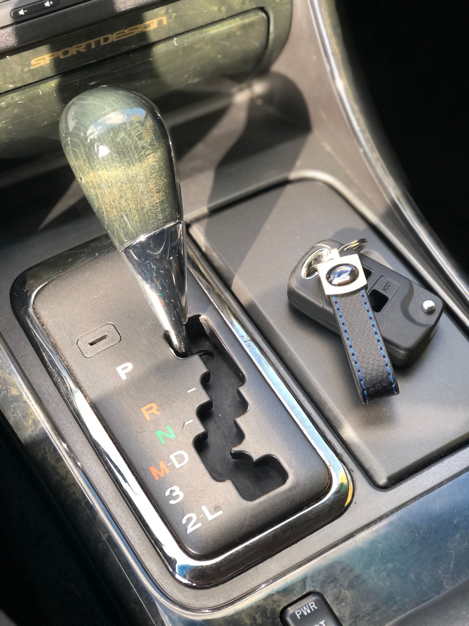

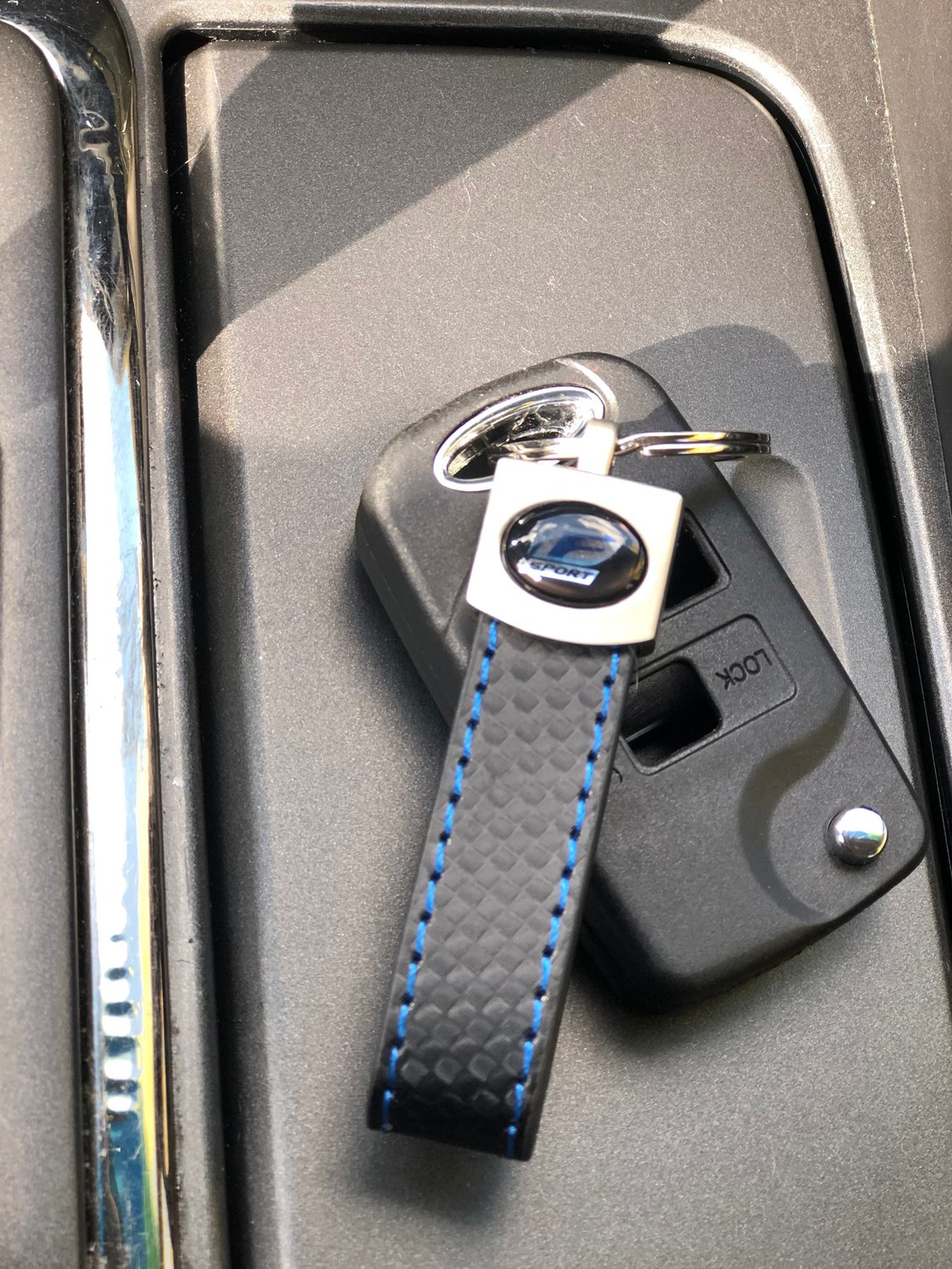

New German Style Flip Keys, Cut and currently waiting for the Lexus Emblem to put on the key and swap the Transponder.

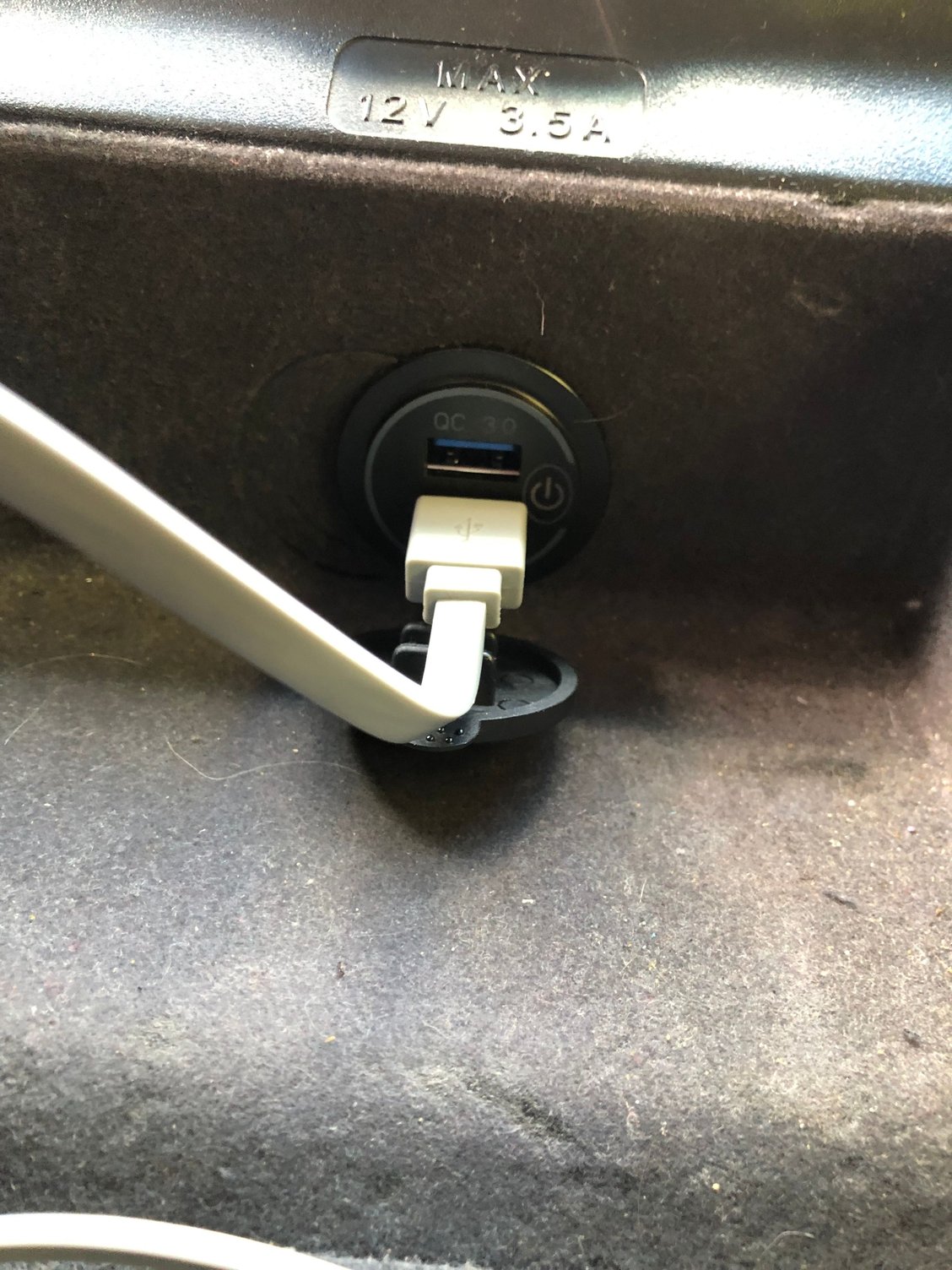

12V USB Dock installed after the 12V Socket failed.

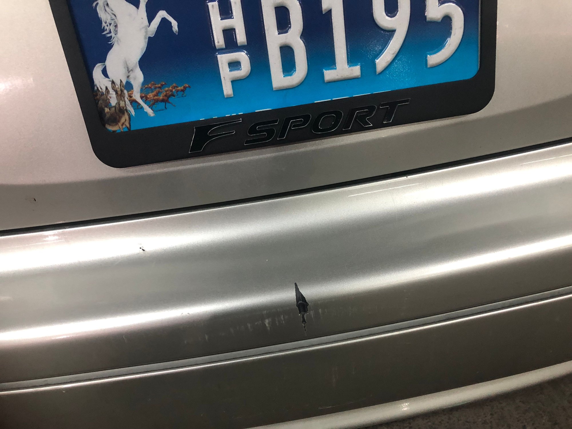

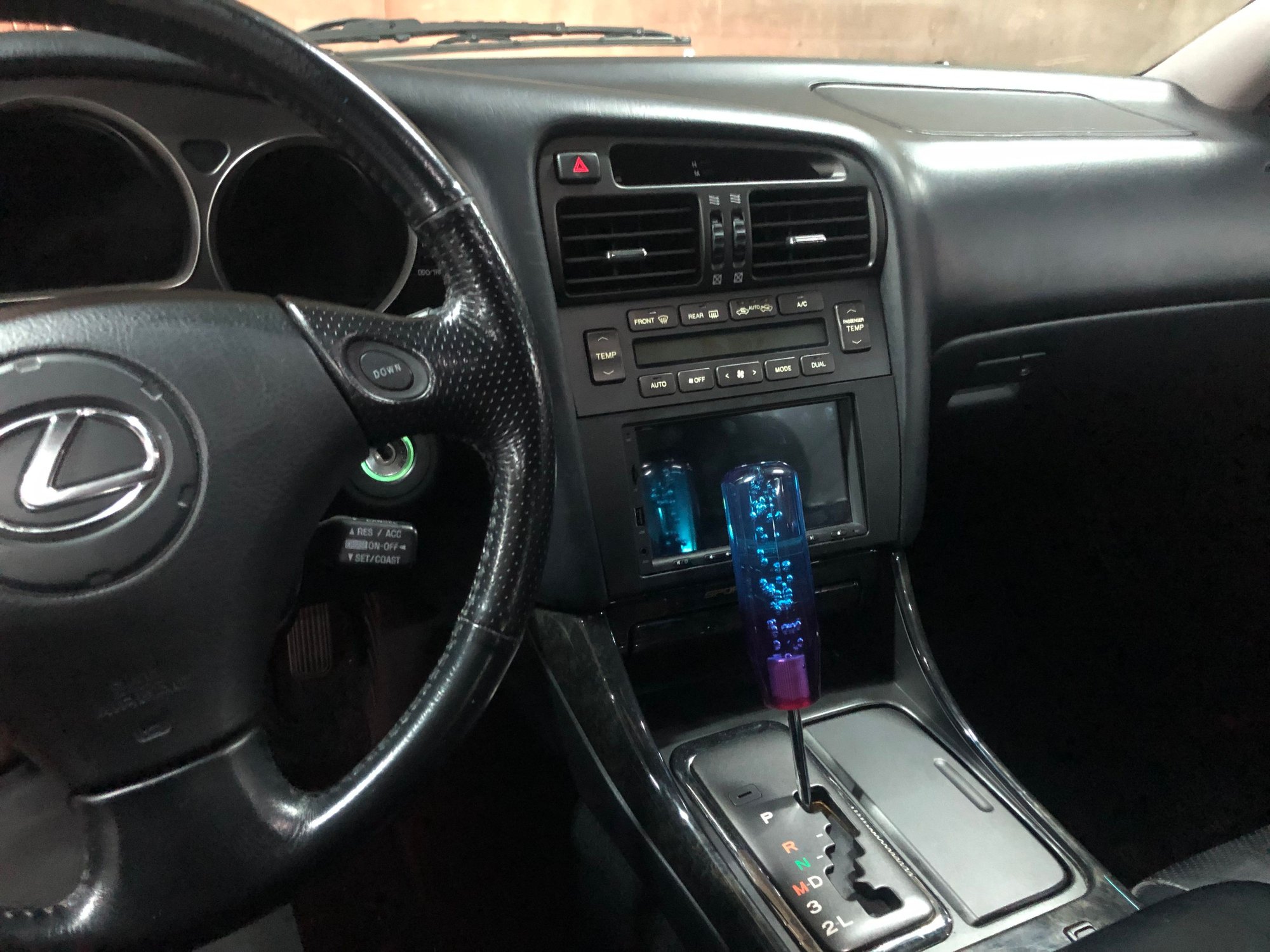

Little Photodump of some stuff that came in yesterday.
***** Shift **** - Amazon Special, when I go Manual it’s staying on.

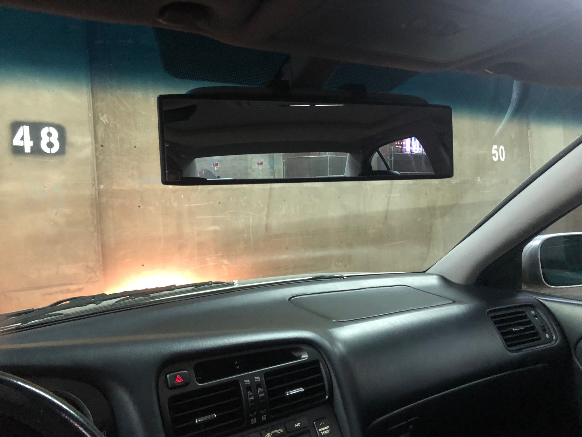

JDM Style Panoramic Mirror - I’m not sure I like this one, it’s a ***** to drive with at night. Looks like I have astigmatism kinda lol
Matte Black F Sport License Plate Holder
