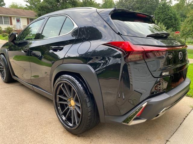

*****before camber is dialed in****Here is a pic of the lil poke from how wide the wheels are. Its not crazy but still have to adjust camber. But i am committed to make these wheels work as i have had them for 3ish years and have only used them for 6 months. Just a reminder this is a 20x10 +10 (255/35) and 20x11+10(265/35).

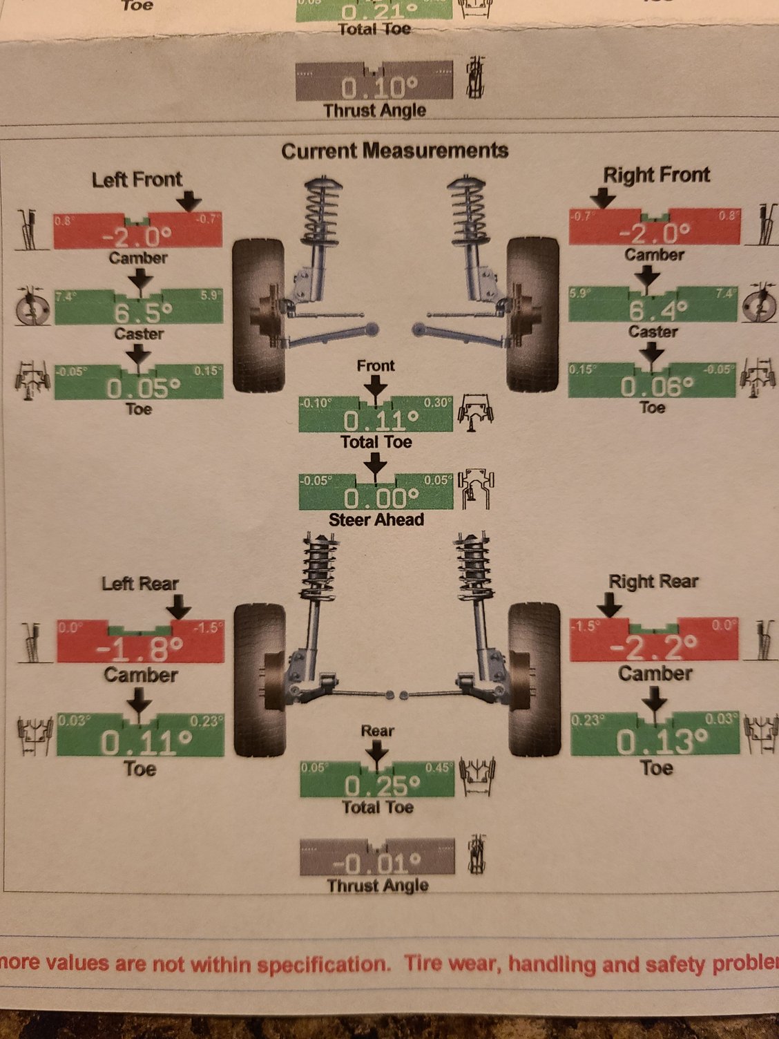

Before and after specs. So the rear is with natural camber. There is no factory camber adjustment on the rear or the front. So if your going to drop it then keep that in mind. Like I said before I am running camber bolts in the front made by spc. As far as I know it's the only option for camber adjustment in the front as of right now. There are some companies that make a rear adjustable camber arms. I havent decided if I'm going to buy some. As of now I like where we are sitting with the camber. I wish the rear was even but it is what it is.
Here's the after pic.

So if I want to raise my car, will that increase the visual space in the wheel wells? There is already too much, IMO, so I wouldn't be happy with that.

Yes, I would think so.
