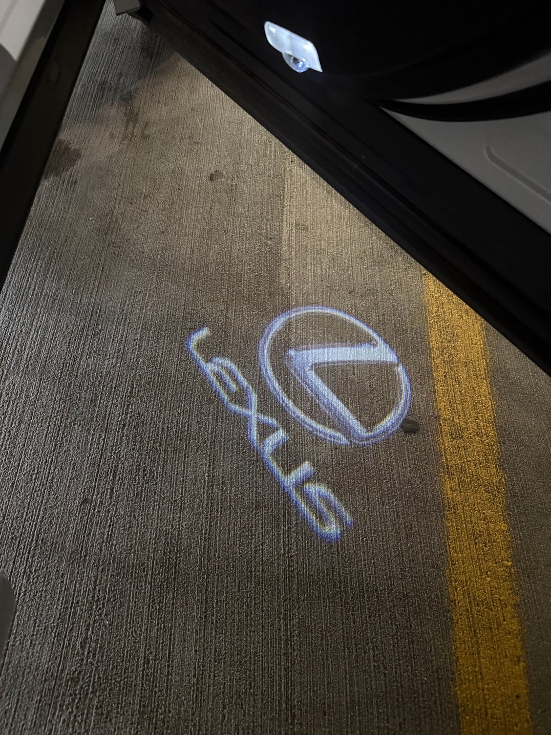

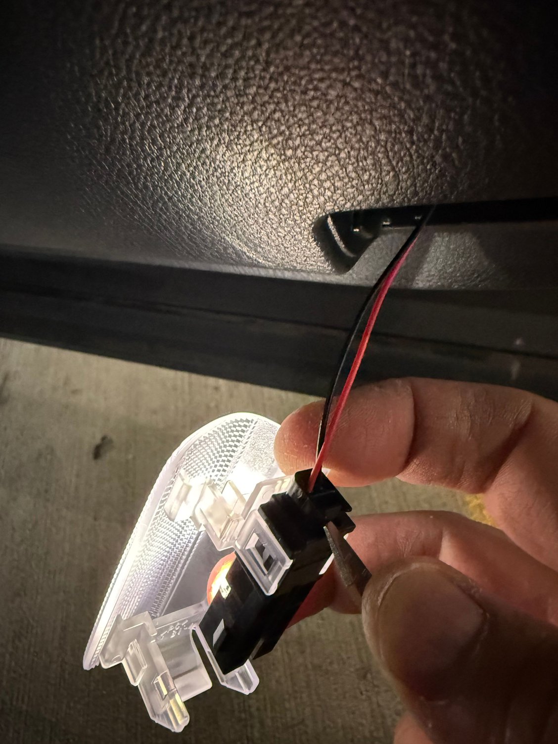

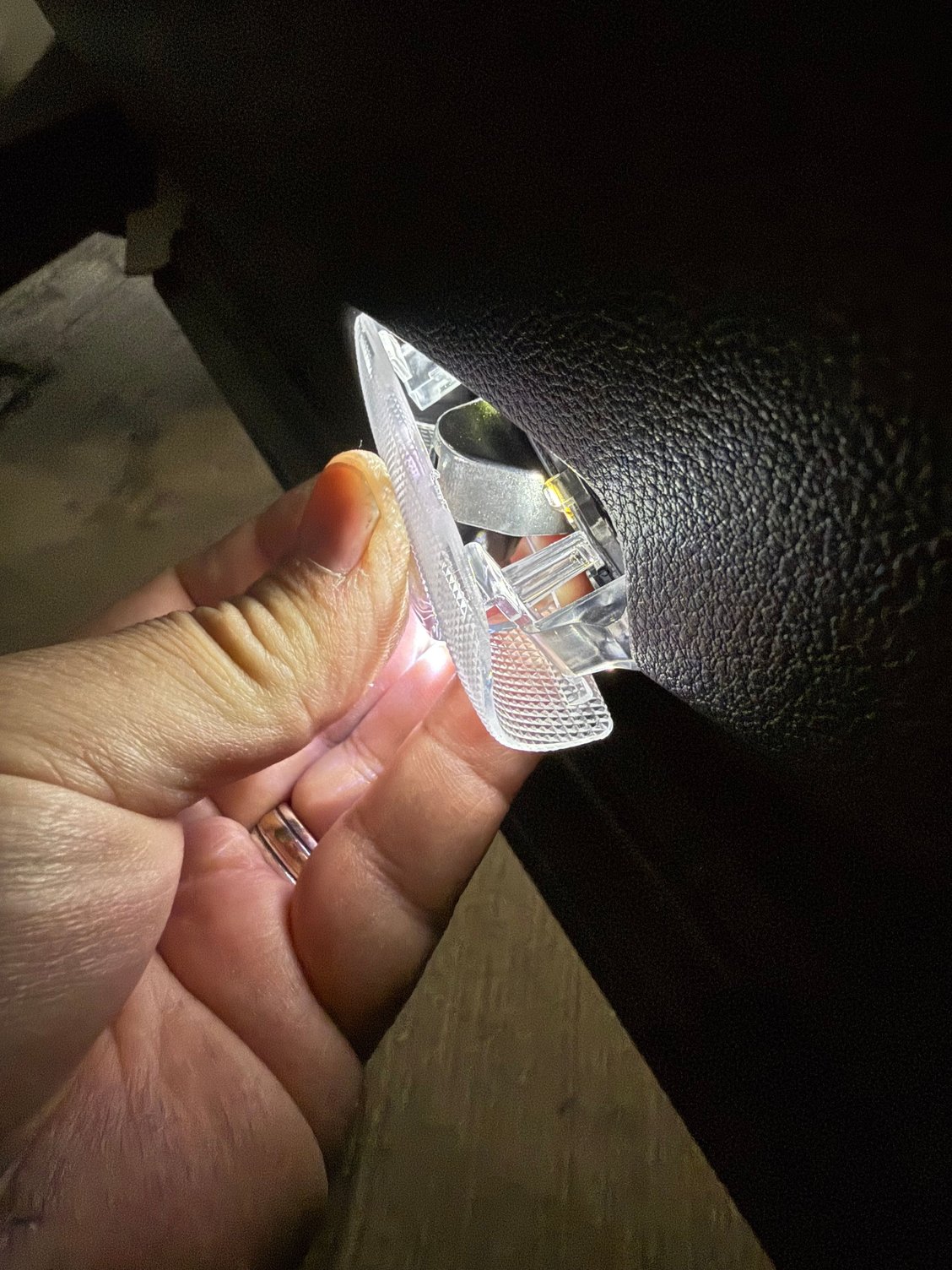

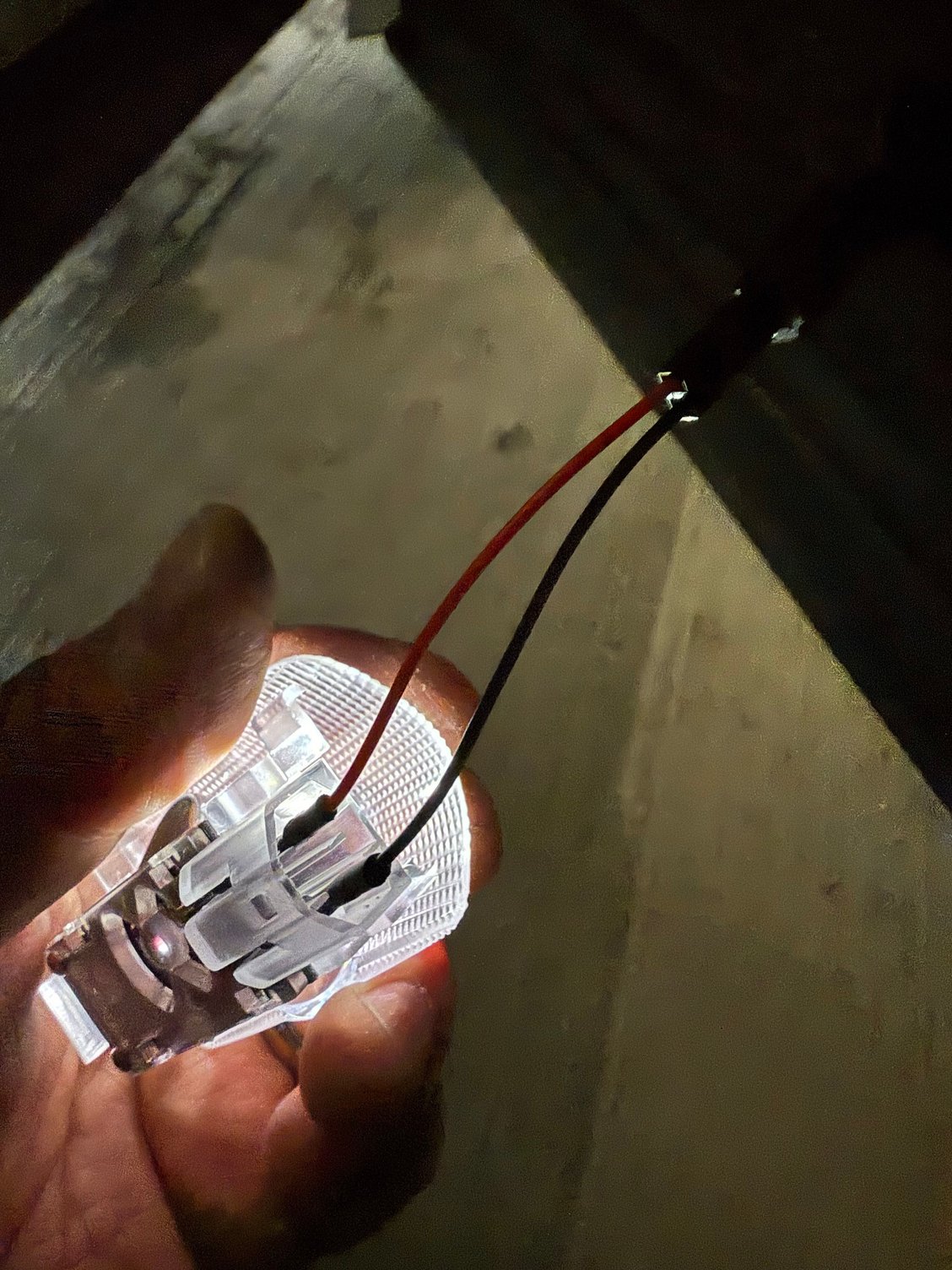

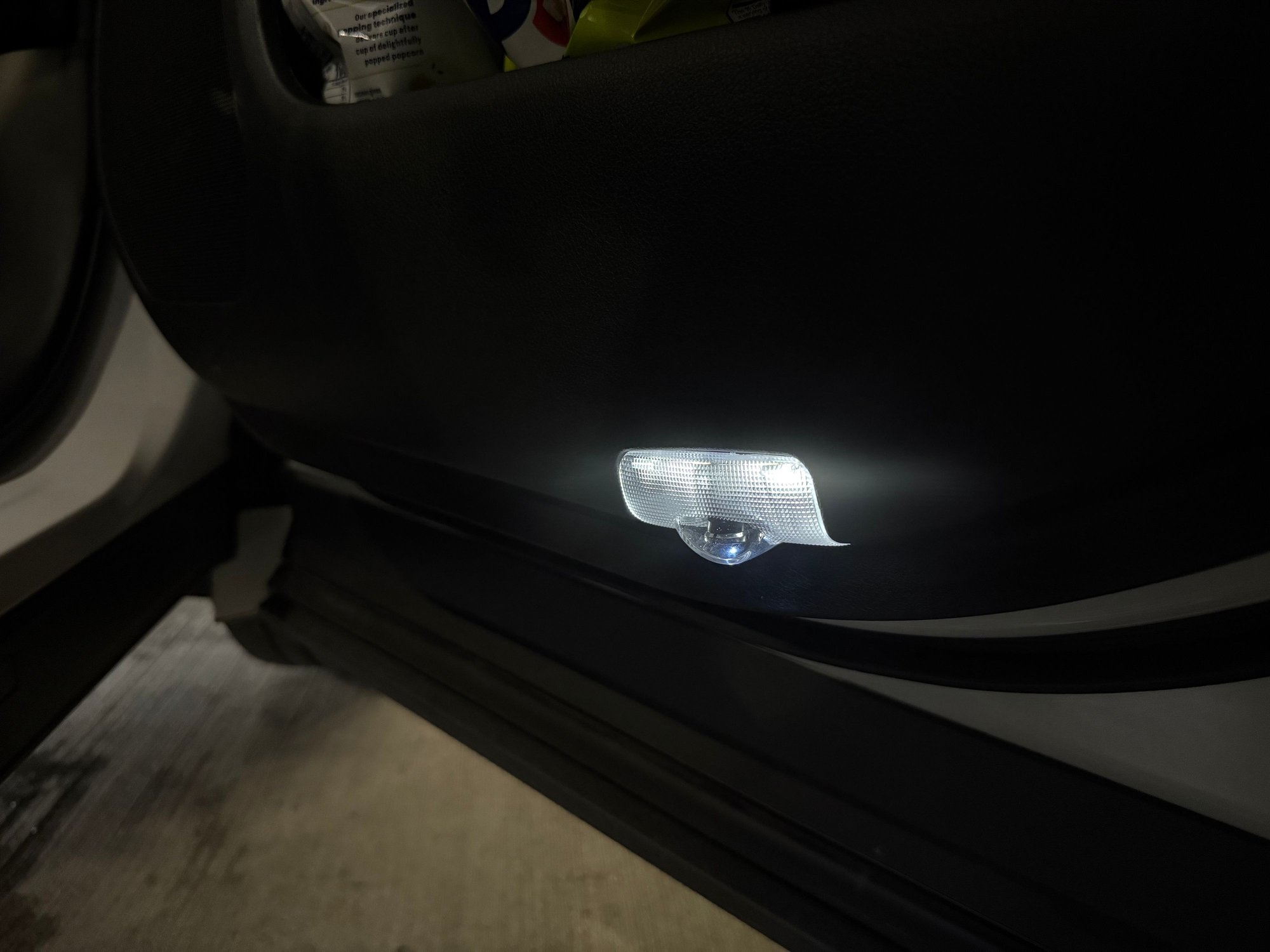

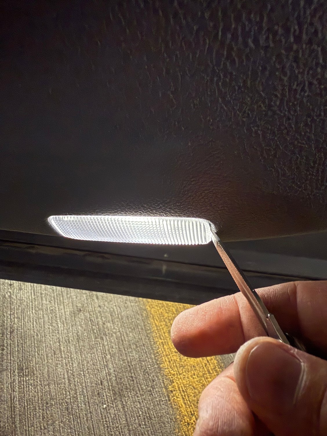

I had looked for options to add Lexus logo puddle lamps, but didn’t see any that were specific to the TX 350. It turns out most of the lamps fit the same in recent Lexus vehicles, so the wire harness / plug is the only real difference.
I found this set on Amazon, and they worked great with the little plug in adapter that’s included:
https://a.co/d/aaX1qTd Old light pries out with thin flathead screwdriver
Plug requires a simple press release
I had to use the included adapter, but orientation doesn’t seem to matter.
New light snaps in
New light snaps in
Fit and finish is clean
Result looks great
Result looks great
