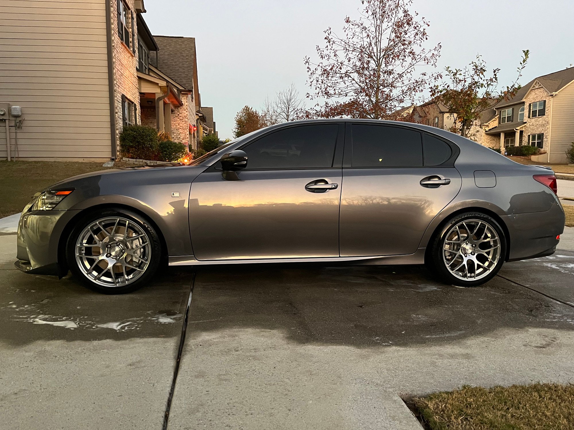

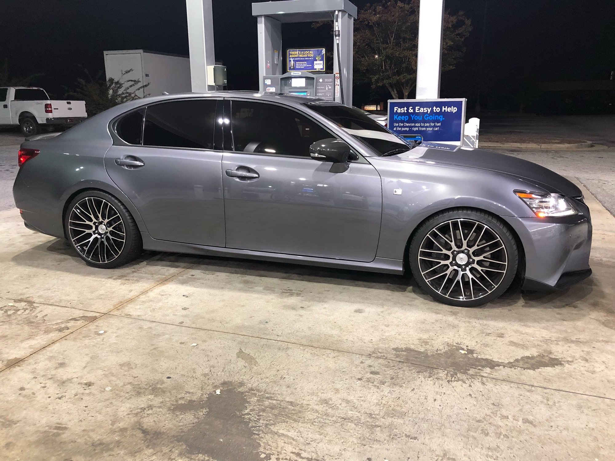

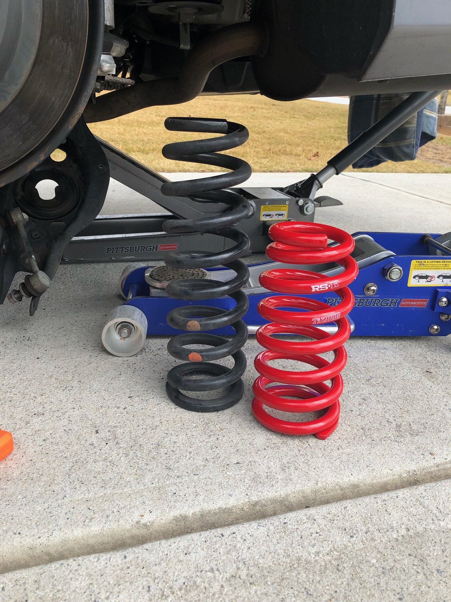

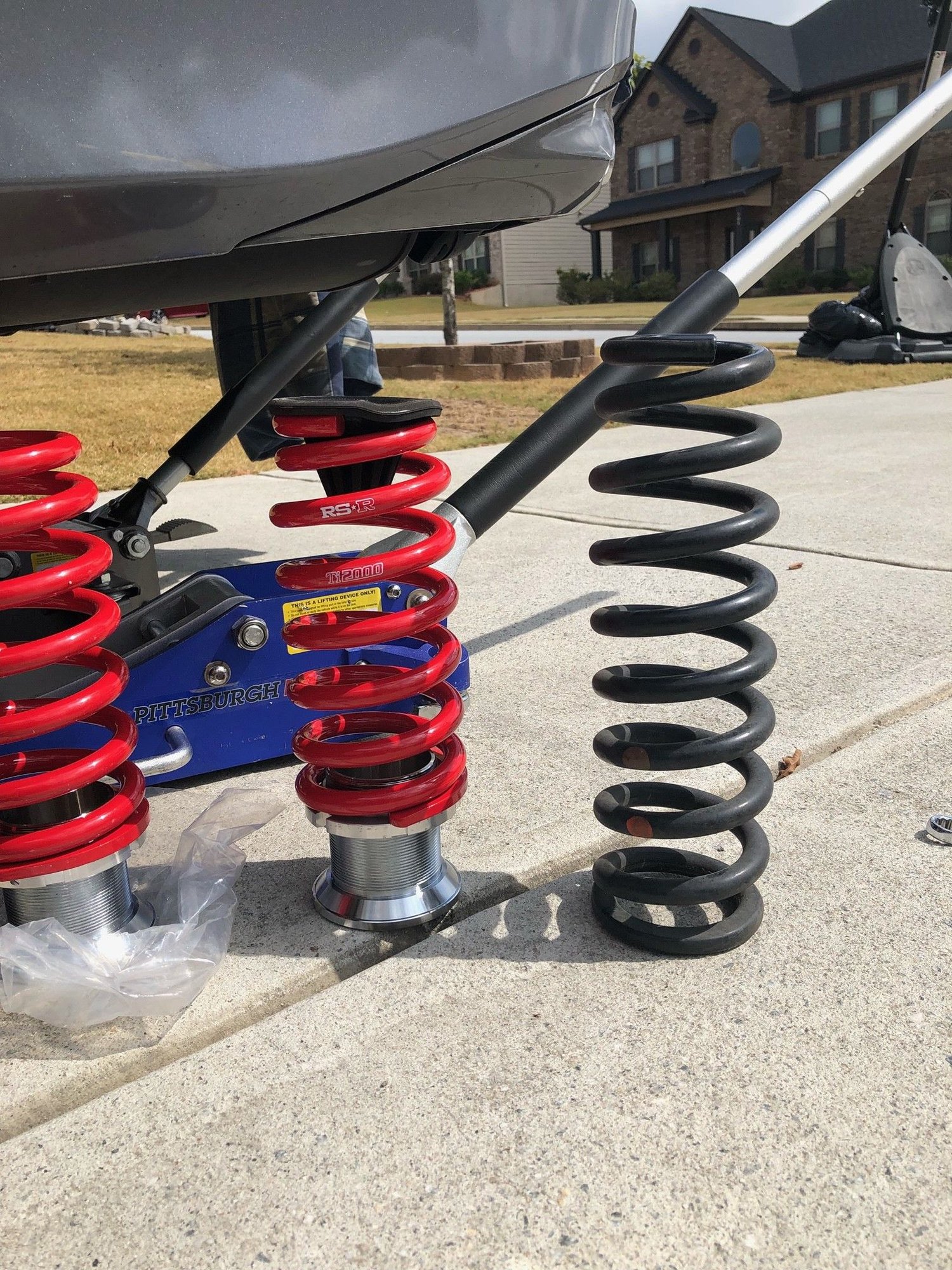

I'm not a mechanic and was able to install in my driveway. Took me about 6-7 hours from start to finish. Did I mention I'm not a mechanic? I purchased the RSR Basic Active Coilovers from Meraki a few years ago. I had them in the box until maybe a year or 2 before I put them on. I have RWD with the factory active suspension. Not sure what the difference is for an AWD with or without active suspension, but as far as adjusting the firmness, it's only done through the mode selector inside the car. There's really only 2 settings which are normal and sport which firms it up in the sport mode.There is a small black box that goes on the top of the actual strut/shock. I used the oem piece instead of the part that top part/piece the RSR's came with since it didn't seem to go on correct. I've had them on for about 3 years and maybe 18k miles and no issues.
As far as adjusting, The fronts are easy to adjust. The rears you have to loosen the arms and a few other suspension pieces remove the spring from where it sits. It's a divorced rear setup meaning the spring is separate from the shock similar to Camaro's, Mustangs, and some BMW's?

Really appreciate the detailed feedback, including the photos.
What size rims are currently on your GS?
