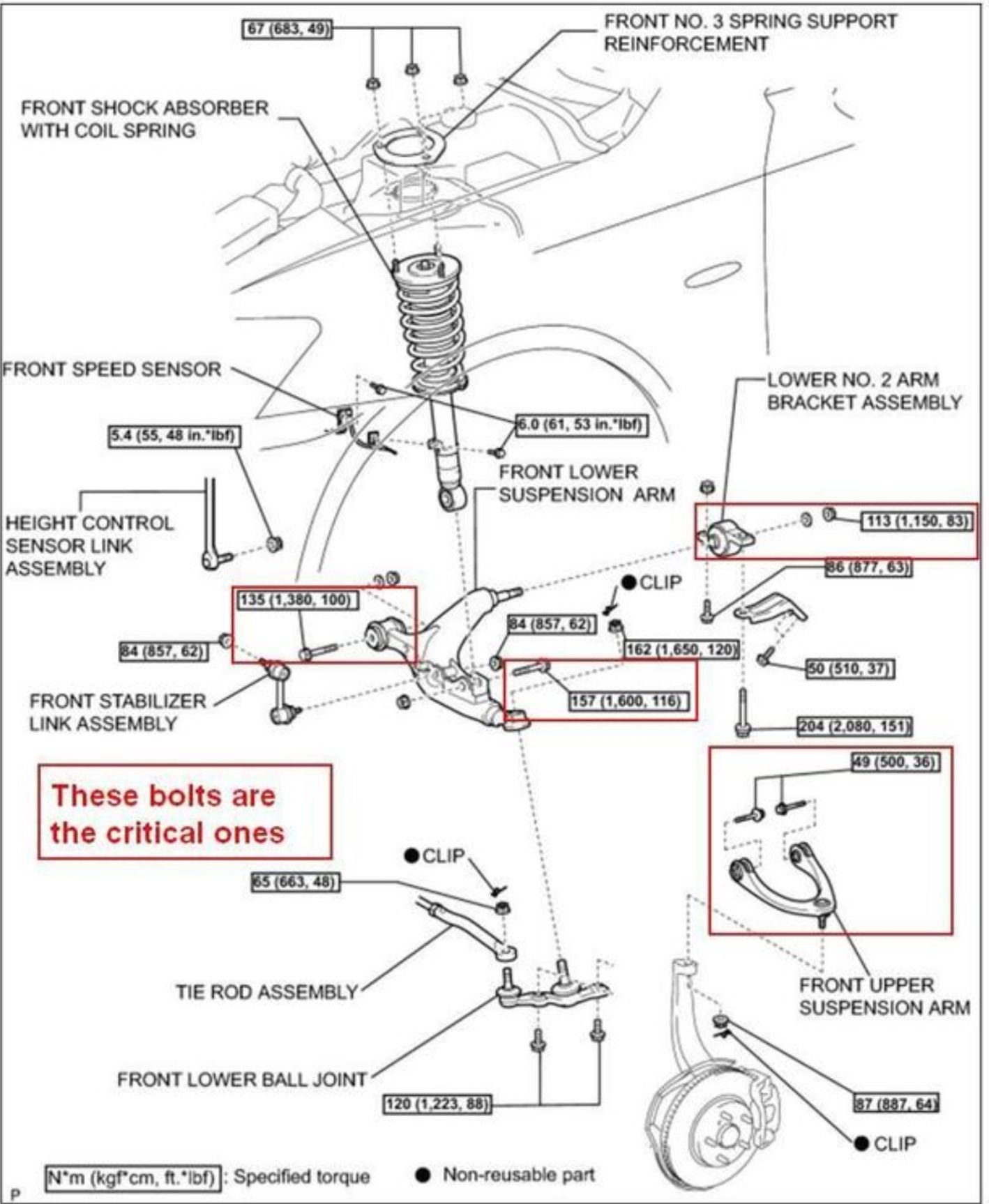

I don't know if anyone can help me out here, I have an extended warranty on my car. The warranty company keeps insisting that I have shocks in the front when I know I have struts. There parts list says according to them that they are shocks. How can I get proof of that? This vehicle does not have shocks in the front but does have struts. Any help would be appreciated.

Typically struts refer to MacPherson struts, which only have lower control arms and the upper load is supported by the strut itself. The GS430 uses a double wishbone suspension geometry and uses shocks, not MacPherson struts.
So, the warranty company is likely correct.

To build on what Jeff said above, you do have a coil/shock assembly up front that LOOKS like a MacPherson strut, but it’s not one. No upper bearing and pivot plate for steering and load bearing.
Here is what your front suspension looks like. This is actually a torque value chart and doesn’t show it fully in-place, and the supper wishbone is not shown in relationship. But hopefully it helps further clear the confusion.
