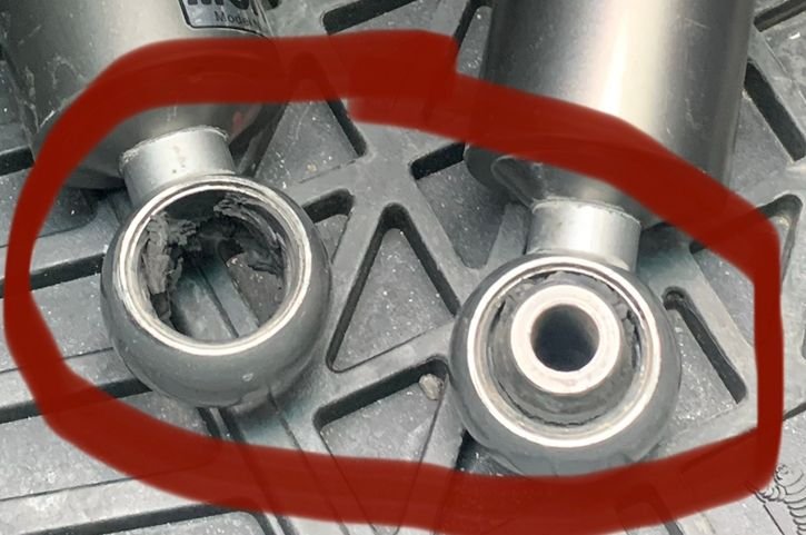

Hey everyone I got a 07 250 rwd
and was wondering if anyone could help me out in finding what size I need for a pair of shock eye bushings. I recently bought coil overs but the bushings are toast.

You'll likely need to go aftermarket and run polyurethane...
FWIW - the cause of this is mostly human error during the installation. The PO left the suspension hanging down and tightened the bolts. When the car was set on all fours, the bushing was over rotated and the constant rotation past center, killed it.
An example of over-rotation past center is a human joint like your knee being hyper-extended. It's painful and it does damage! All bonded rubber joints MUST be centered in their range of travel before securing pinch bolts or they have a very short life and look like those!

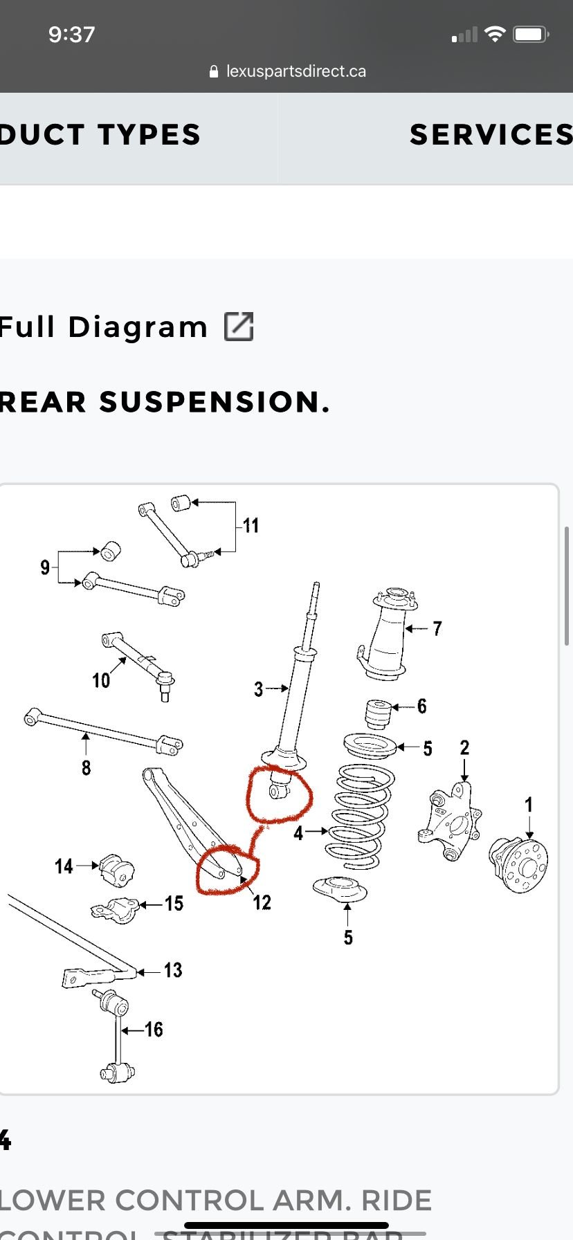

https://febestparts.com/BUSHING_REAR...SORBER/HAB-205
