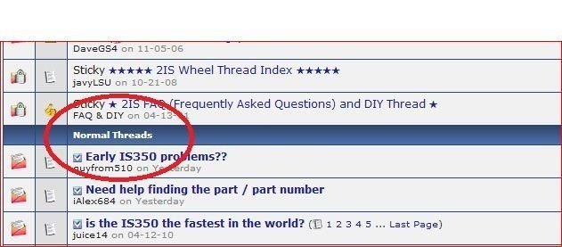

You should ask those questions in Normal Threads which get lot more viewers and commenters.
