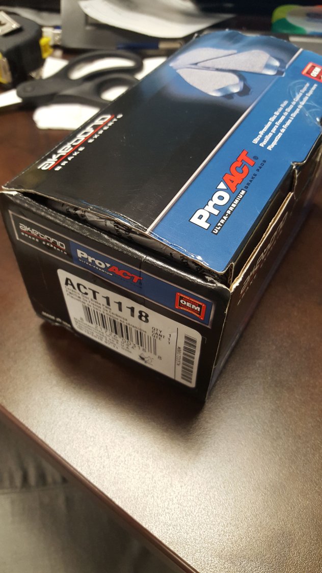

Originally Posted by KtIS
Akebono ACT1118(front) And ACT1113(rear) ProACT Ultra-Premium Ceramic Brake Pad Set
https://www.amazon.com/gp/aw/d/B001D...A3PEUMU5VFQMLM
Is this the one I need to buy it ?
I'm about to change my brake pads to low dust OEM pads. Can you update to see if you find out that is the issue? I hear that there should be little or no difference between low dust OEM and the normal ones.

My Akebono ACT1118(front) is on the way , i will post my feedback after install and test drive it .

The Pad is arrived , going to install by next day.

Okay , i got pad changed today and test drive few round , the brake performance a bit better than the OEM low dust , but there loud noise and vibration when braking . its not happened when i change a new oem brake pad . what's wrong is it ?
