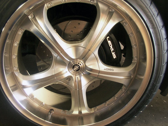

I used rustoleum and after about 4 solid coats it looks plenty glossy. One coat doesn't cut it and it looks grey, but after 4-5 coats it will look great.....
Take a look at mine again:
Also, you can buy 500 degree clear which you can put over the rustoleum and you are set. I haven't done it yes, but plan to in order to protect the sticker.

I found some Black 900 degree High-Gloss "Caliper Paint" at Pep Boys.
Wire brushed any rust off then cleaned them really good with Brake Cleaner.
After masking off the Rotors with newspaper and masking tape I sprayed on 4 solid coats.
They came out very nice.
Here are a couple pics of my calipers right after putting the stickers on:
