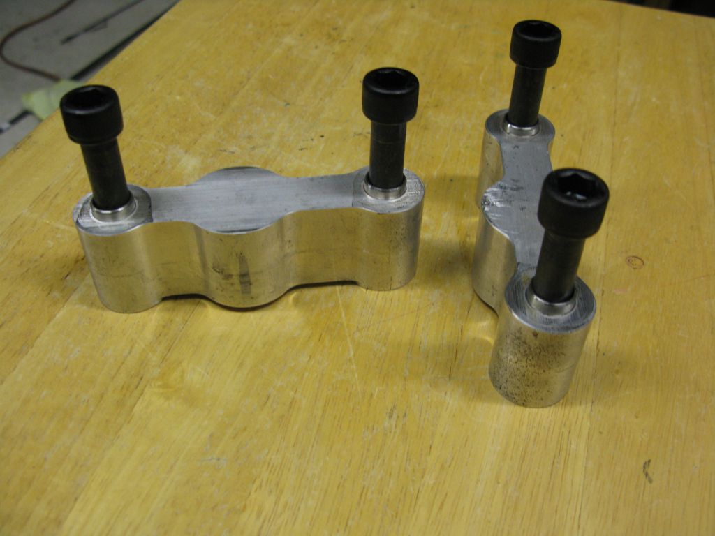

my contribution...I needed 15mm spacers to avoid rubbing my 19" vs-kf and stock 16" wheels (both not bbk friendly).
I also used SAGE RCAs (30mm) instead of shaving/grinding the LS400 caliper or the tie rod end...
