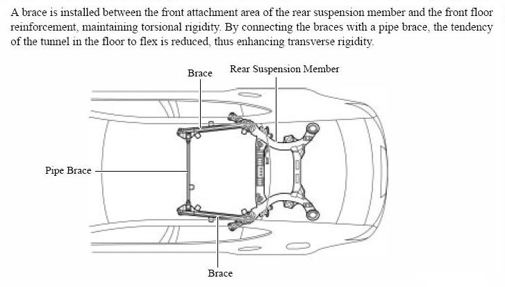

So what's your point here? There are factory installed braces underneath the car. From the New Car Features:
This aftermarket piece adds weight in the hope that it will improve chassis stiffness noticeably. Without a watch and a timed course, it's a pretty tough call to say the car will handle better or not. The weight penalty is real, this can't be questioned. More dead weight to accelerate, corner, and stop. Does the added stiffness offset the increased pork? That's the real question.
