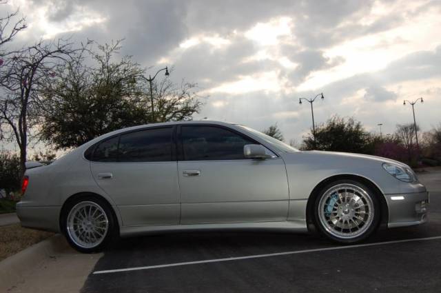

19" IForged Retro Front:19X8.5 37et w/Toyo T1R 245/40/19(Fat Setup)
19" IForged Retro Rear: 19X10 43et w/Toyo T1R 275/35/19(Fat Setup)
L-Tuned Shocks
L-Tuned Springs
Fat tire set up is great. Front rubs a bit when turning sharply. Wish I had gone with coilovers. Ride on L-Tuned is much better than stock but no adjustability compared with coilovers.
