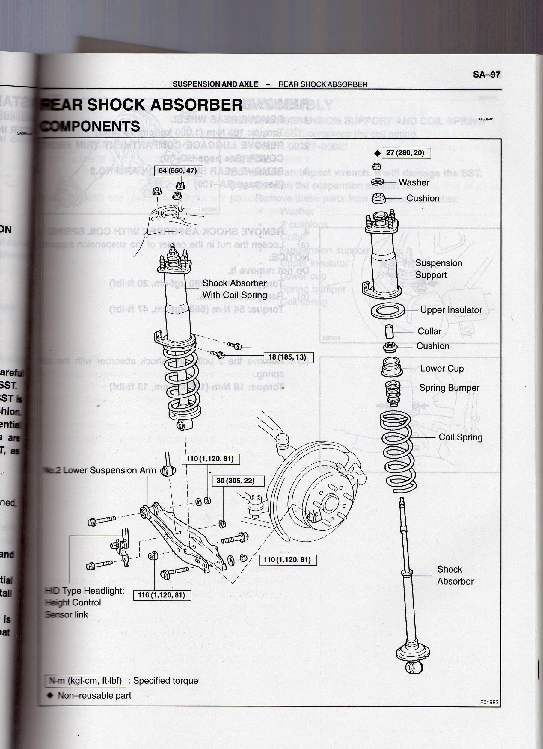

Chuck, could you post up the diagram for the rear shock torque settings as well? I need to change out both front and rear shocks.
Thanks
Thanks
huge pic
Old Jul 24, 2006 | 05:34 AM
natnut's Avatar
natnut
Joined: May 2004
Posts: 2,602
Likes: 89
From: Singapore
Thanks!
much obliged.
