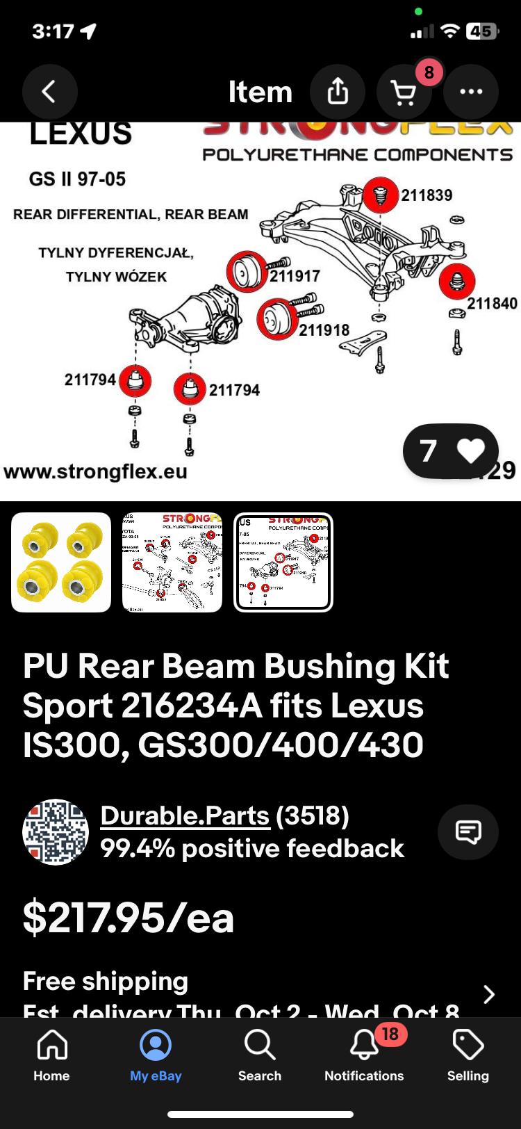

I am looking to to put new rear subframe bushes in (like in the pic) but all I can find online is solid replacements for silly money. Does anyone know where I could find the one circled in the pic.

Here are 2 options, the first one, the Megan kit are the budget choice, they are less than half the cost of any others, and they are much easier to install. You don’t have to remove the rear subframe, they simply get installed on the bottom of the original bushing and then they compress it to stiffen everything up. The tighter you make the bolts the firmer it will be. The next option would be to replace the original rubber bushing with a poly one, they come in different harness levels. The rear subframe needs to be removed and then you have to get a press or something to push the old ones and then drive the new ones in. This is kit is the harder level ones, but they will still have some flex and will be a little more forgiving than the solid mounts.
