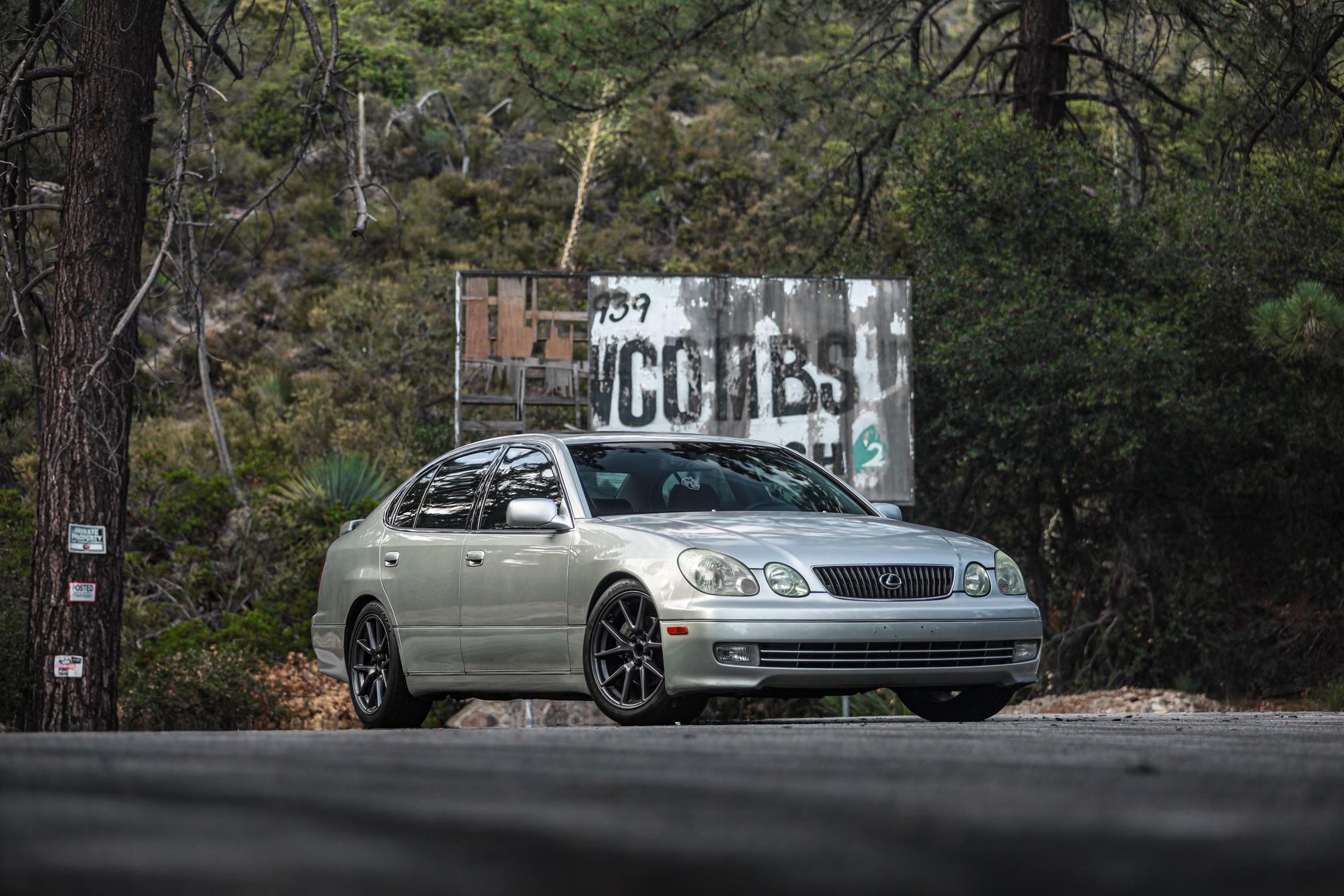

Hi everyone, new to the forum but have always found it helpful when browsing for problems.
I currently own a GS300 that I modified with Tein Flex Z coilovers, Megan Racing rear swaybar, and 18" Model 3 wheels wrapped in 245/40 Continental ECS02. My alignment is 1.9 degrees of camber with 0.02 toe-in F/R. The car has a ton of grip in the corners, but I am never quite satisfied with how the coilovers behave. I have the dampers set to 4 clicks from full stiff, and I feel that the car is jiggly but still ultimately underdamped. I run out of suspension travel (slam into the fenders?) when hitting bumps at speed, and it results in a really jarring bang sound.
For reference, my stock ND3 Miata Club does not do this, regardless of what speed I go over the same bumps at.
For my next suspension setup, I would like something that controls the body motions well without crashing over bumps. This car is my daily, and I would like "driver's car" driving dynamics without being overly stiff. I am willing to spend a good chunk more than the Teins to achieve improved handling. I did some brief research and it seems that Bilstein B8s paired with some lowering springs are a solid option. What springs would y'all recommend to go with the Bilsteins? I would also be open to coilovers with properly-valved dampers.
Here is a picture of my car as it sits. Thanks in advance!
