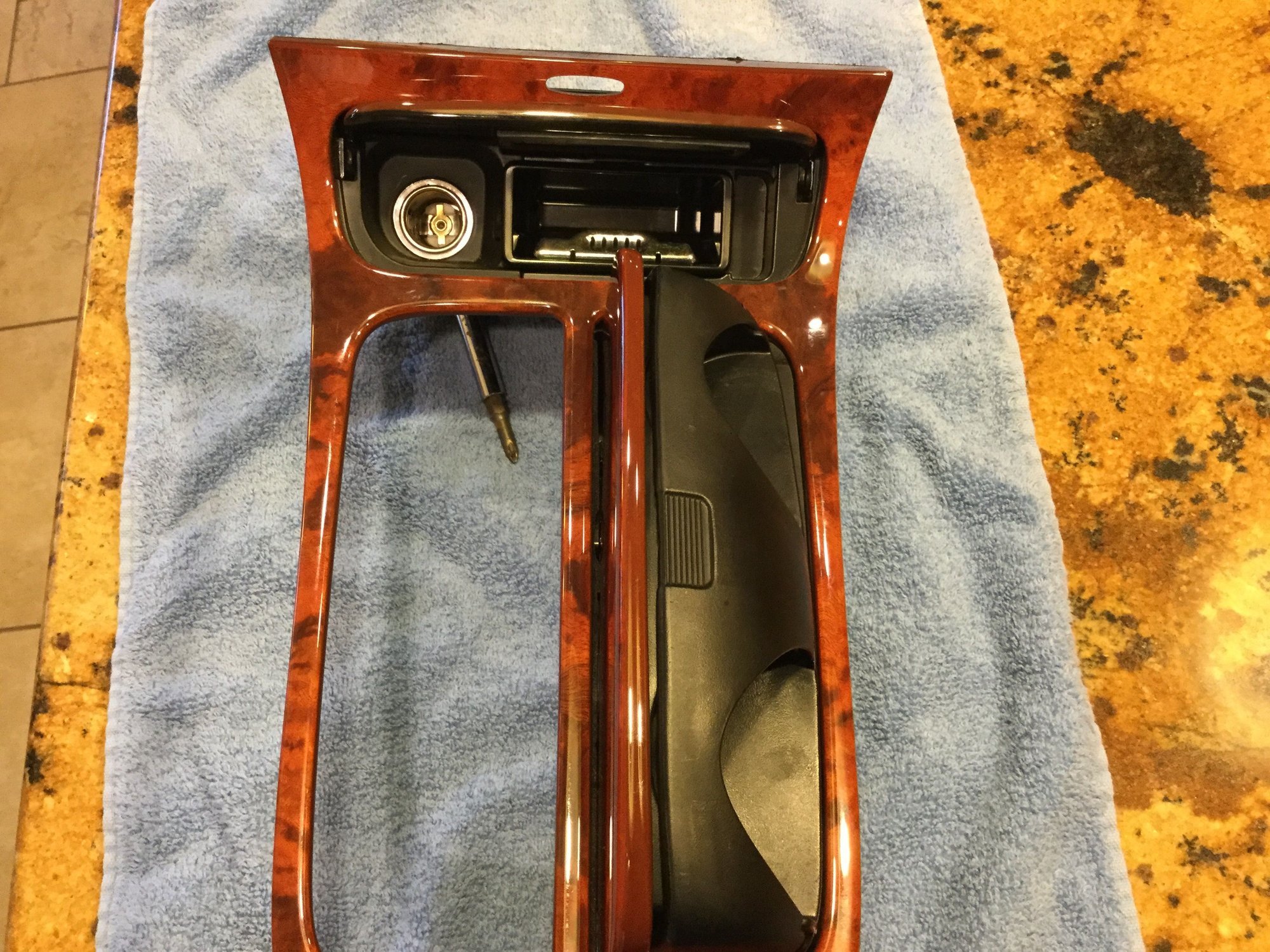

remove the cup holder assembly and wash it in soapy water…my guess is a spill…
see pic, the cup holder will detach from the main assembly, look for the screws on the bottom.
