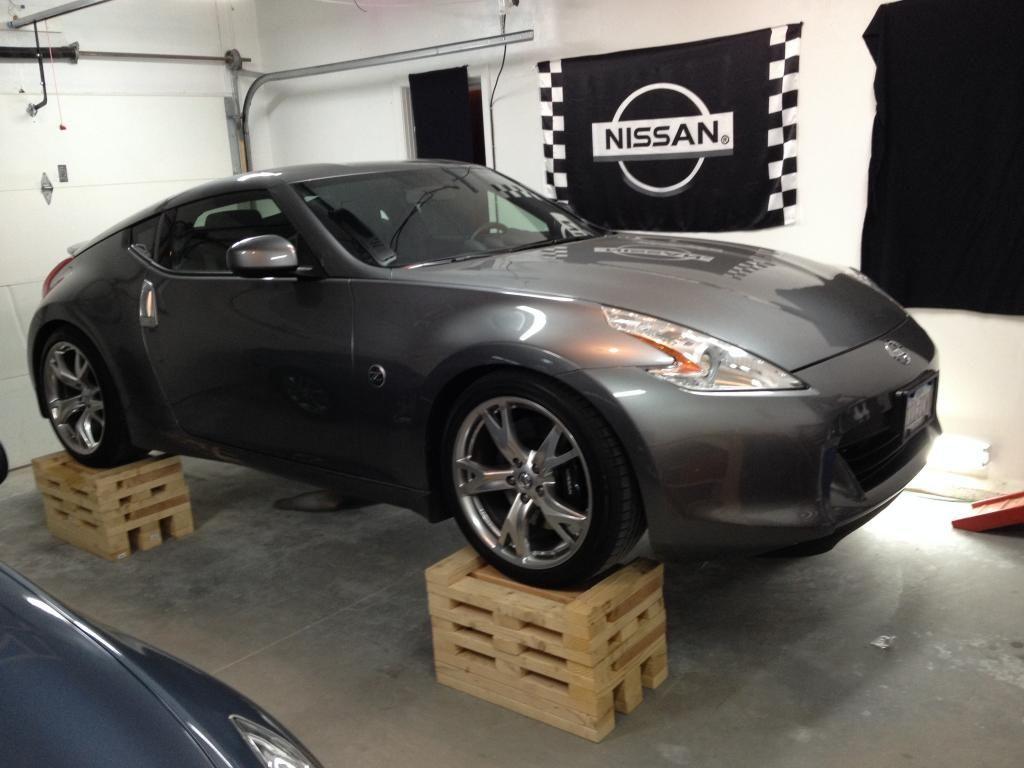

I haven't' done it on my SC yet because I've only had it a week, but I will be changing the diff oil soon. What I have done on other cars in the past is drive the front wheels onto some car ramps, then jack up the rear and place 1-2 foot long pieces of 2x6 lumber under the rear wheels until the vehicle is level. You may need a few thinner pieces of wood as well. You can check the level by placing a carpenters level on the doorsill when the door is open.
