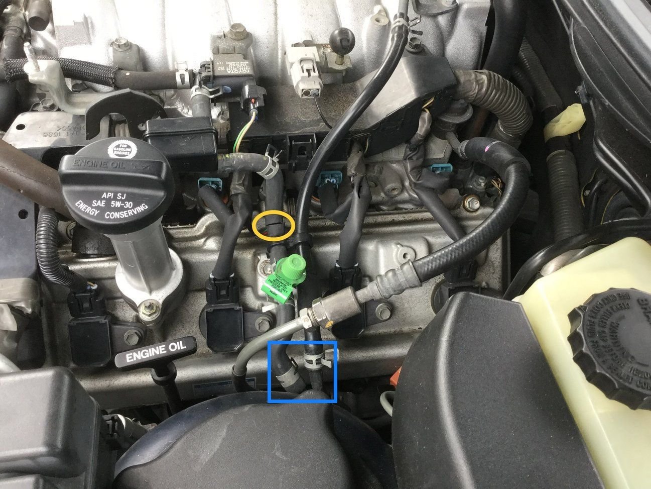

You said you tried other suggestions you found here on CL but you didn’t say what they were…
whenever I received those codes, it was either this broken vacuum line or it (blue square) pulled off from hard acceleration
