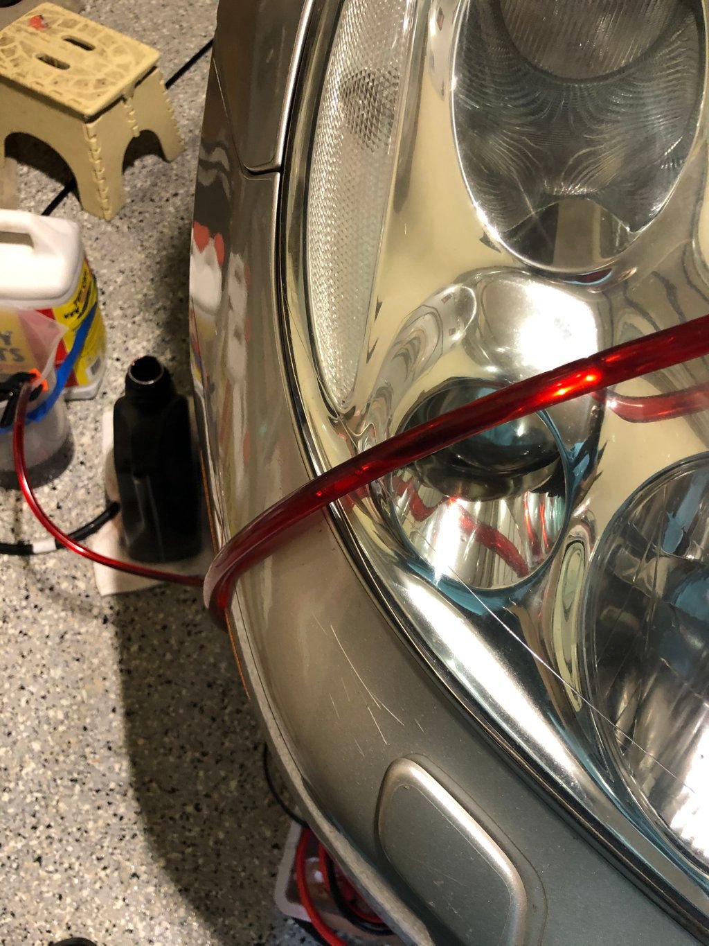

Because I was also needing to flush the Transtune out, I connected the return line via a barb fitting to a long 3/8 inch vinyl tube running to waste pitcher.
Flushing was done with key in on position (engine not started). Lock to lock steering wheels x 2 was about one reservoir of fluid replacement. Don't let the reservoir go dry.
This is the step where MAF is disconnected but key turned on --> VSC error later.
My ATF was already pretty red even before this process because I had already exchanged it a few months ago. To get most of the Transtune out, I ran nearly a gallon of ATF through. Reserved about 1/8 gallon for final leveling.
Yes, nice and red
