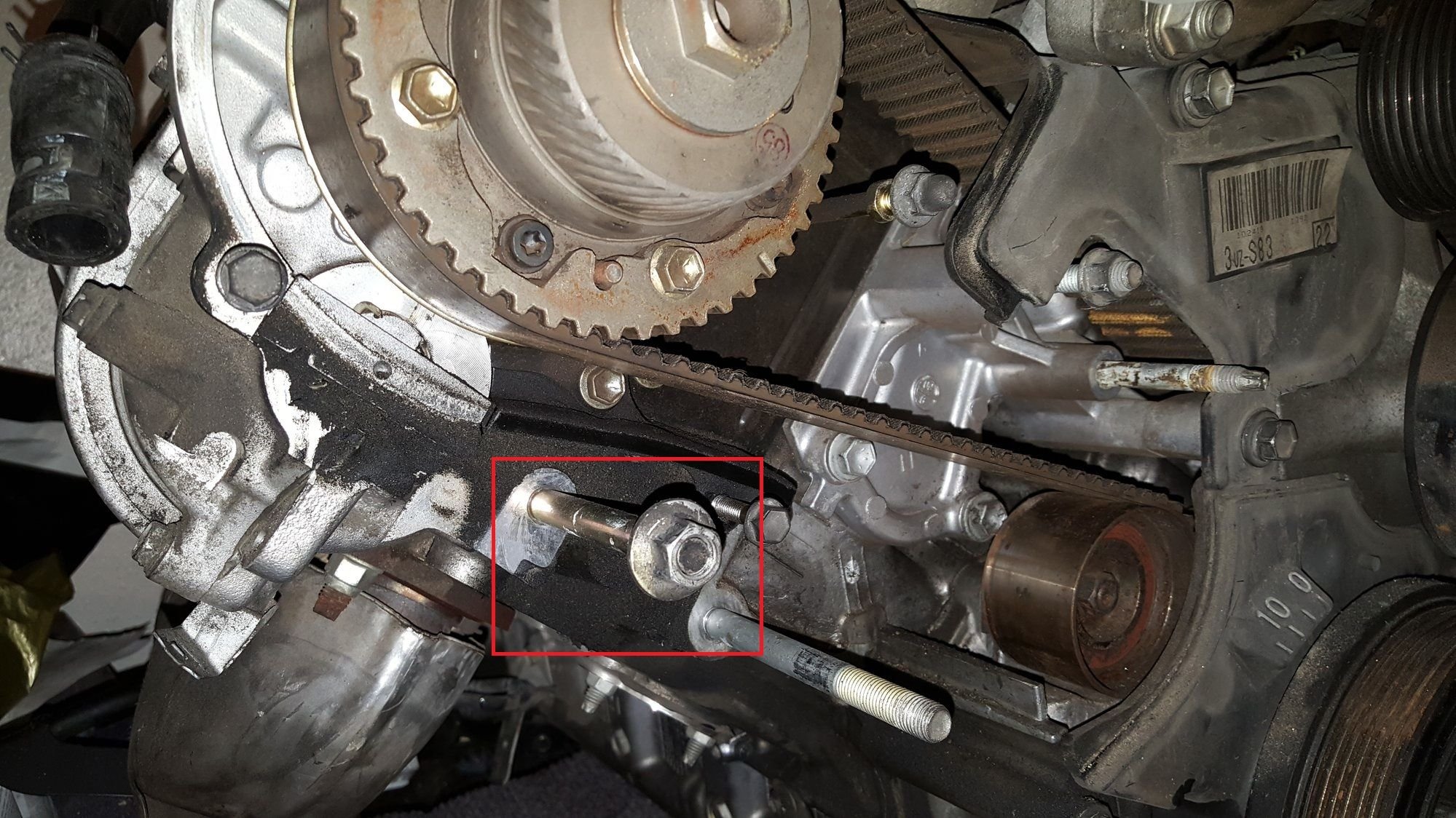

The stud for mounting the power steering is broken. Does anyone know the part number and how I can address this?
This is the stud.

what is wrong with the stud, it looks fine in the pic?

Still asking, how is it broken when it looks fine in the pic?

The picture is not from my car. The stud is broken in half and I am unable to tighten the nut and secure the alternator correctly.
If the stud’s broken flat, easy-out will get it out. Otherwise you can try to grab it with the locking plier.
