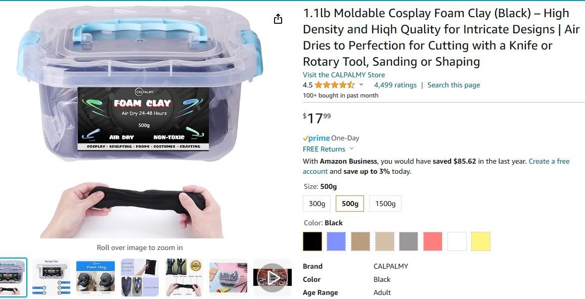

Yes, the Garmin 76 does fit. Follow Roger480 instructions and you should be able to do it. One thing that I did that I liked better than using strips of foam rubber is I bought a tub of moldable foam on Amazon. It comes out like putty and when it cures, it is just like foam rubber. You can form it around the Garmin more easily and it won't fall out or move around, but you can dig it out if needed with a knife.
Order on Amazon
