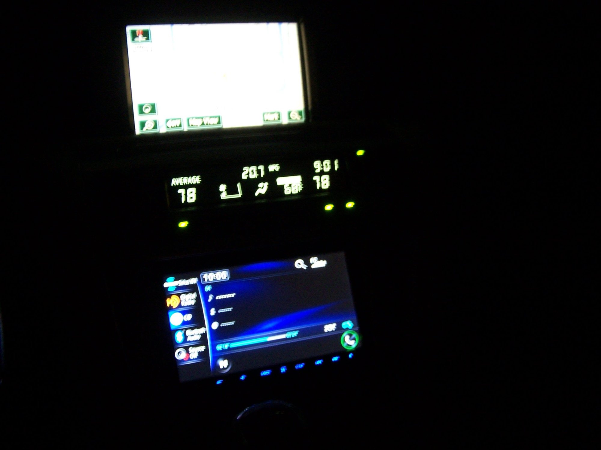

Originally Posted by leexed
Thats ok! We have been VERY close friends for quite awhile behind your back!! She won't be upset.
Like to see a pic of your android screen. thanks Ed
Old Nov 20, 2019 | 07:48 PM
joemg's Avatar
joemg
Joined: Jun 2019
Posts: 1,135
Likes: 292
here are the photos you requested. After replacing the radio, the OE screen looked out of place. It did not match anything,and to me,it was not
as clear and easy to read.
That's really cool! Thanks for posting!
