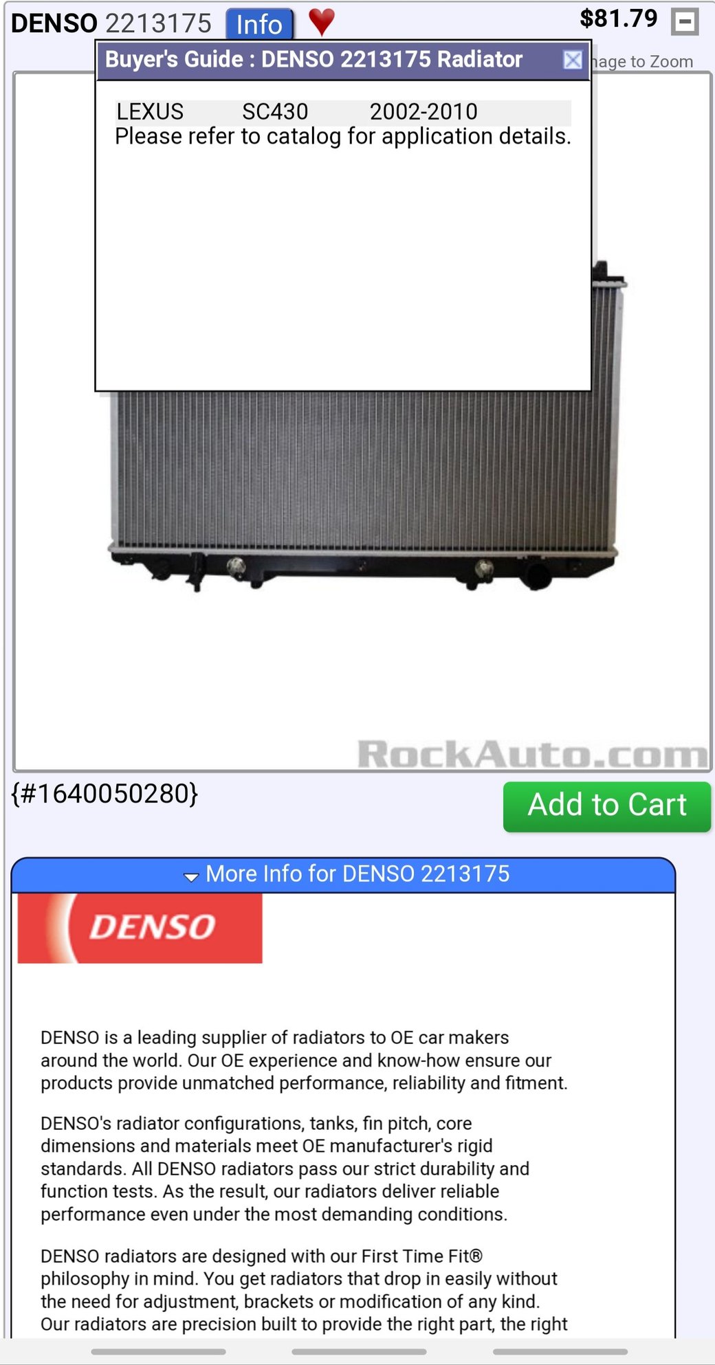

I think the radiator is 221-3175 not 3120. $81.79 on Amazon. This is without the gold plating you get at Lexus.

Same price on RockAuto - $81.79 I will probably replace mine as preventive maintance sometime this year.
