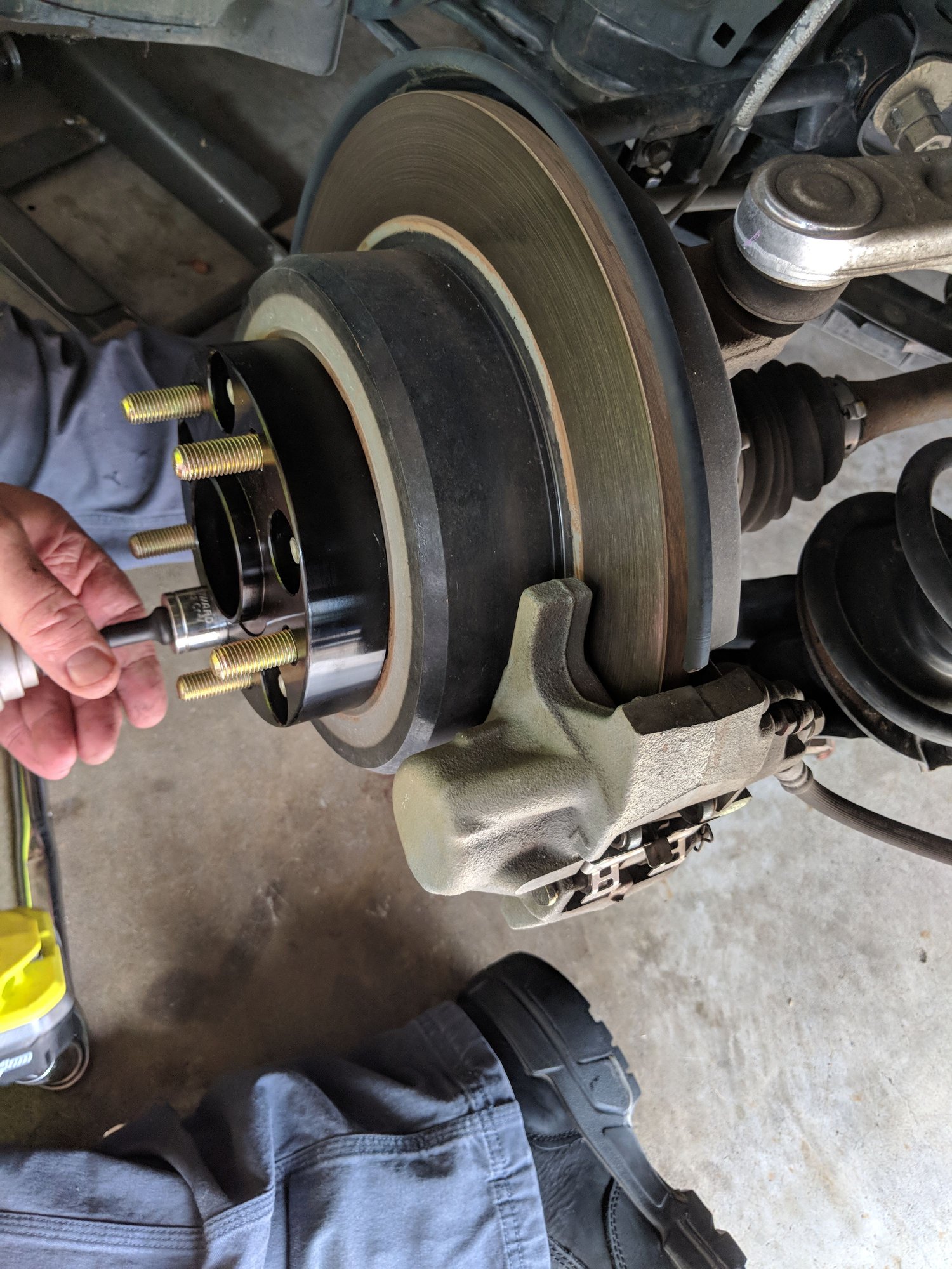

Yes, It's why I chose the Ichiba V2. Studs are built in to the spacer
Install spacer to hub lugs w/ 80 lb torque then torque wheels to 76 lbs on the spacer
Ichiba V2 30mm rear spacers

thank you for sharing this vital safety information!!!
i have always wondered if spacers place any additional stress on the wheel bearing or any other suspension part?

I wonder too, sure hope it's all good cause I'm instantly in love with the wider stance. For every "anti" argument, there's a "for" argument. I've got the 2003 steering wheel wiggle going over bumpy surfaces (before the spacers, nothing changed w/ them) so front struts are on the way. Everything I did I learned here, so if something goes wrong, it's everyone elses fault!!
