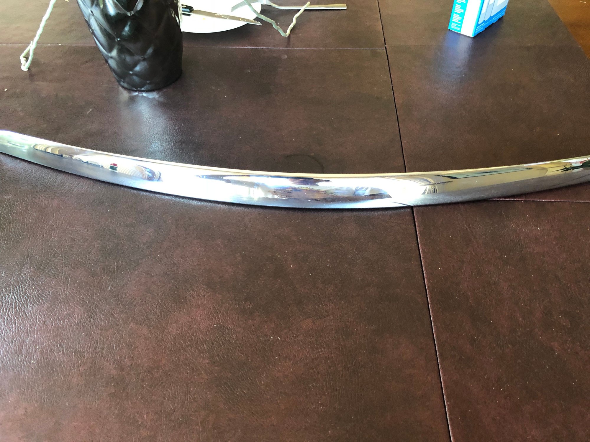

Does anyone know how to resecure the chrome molding
or do I need to get a new one from Lexus/Toyota ?
On one side of the edge of my chrome molding, I notice the
molding is slightly loose when I open or close the Hood.
I see there are a few black fastener under the hood
right under the chrome molding. It does not look like
the edge fastener is loose ...
It must have gotten lose as I been opening and closing
the hood more often lately because of my battery tender
Is this piece just held in place by double sided tape?
thanks everyone

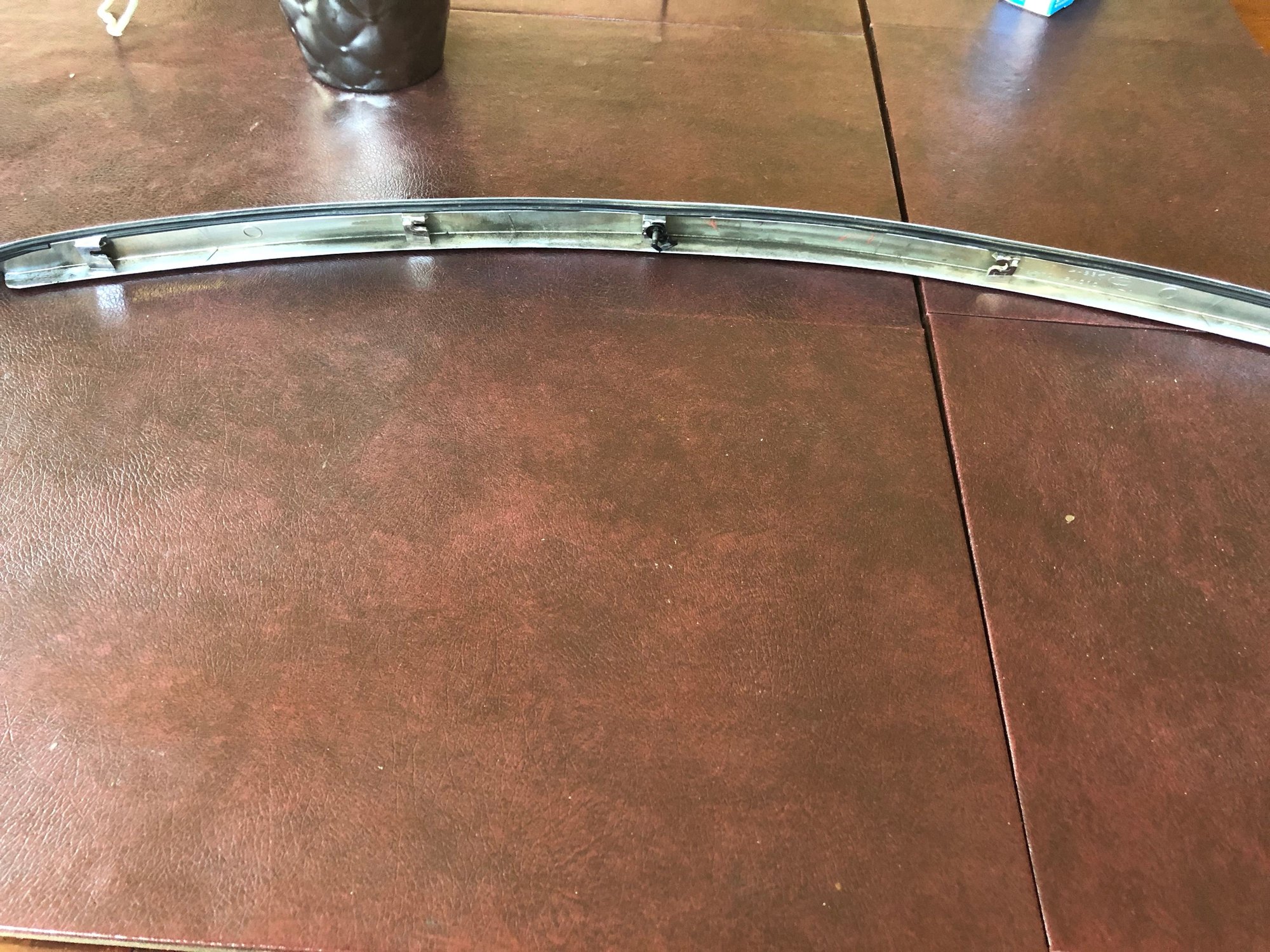

Does anyone know how to resecure the edge of the molding?
It does not look like the corner fastener is loose.
all the black fastener doesn’t even turn
or is there a way to turn it?
I am wondering if one of the nuts broke inside the back
of the chrome piece. Has anyone taken any pictures
or have a diagram how to remove or the chrome piece
look like from the bottom?
thanks

The trim was easy to remove and replace. Just unscrew the 5 nuts in the back and replace. Maybe one of the small studs on the back of the trim has broken.

Thanks iol. Took the piece and as you described,
one of the plastic clip to the screw broke
Getting a new chrome piece now
