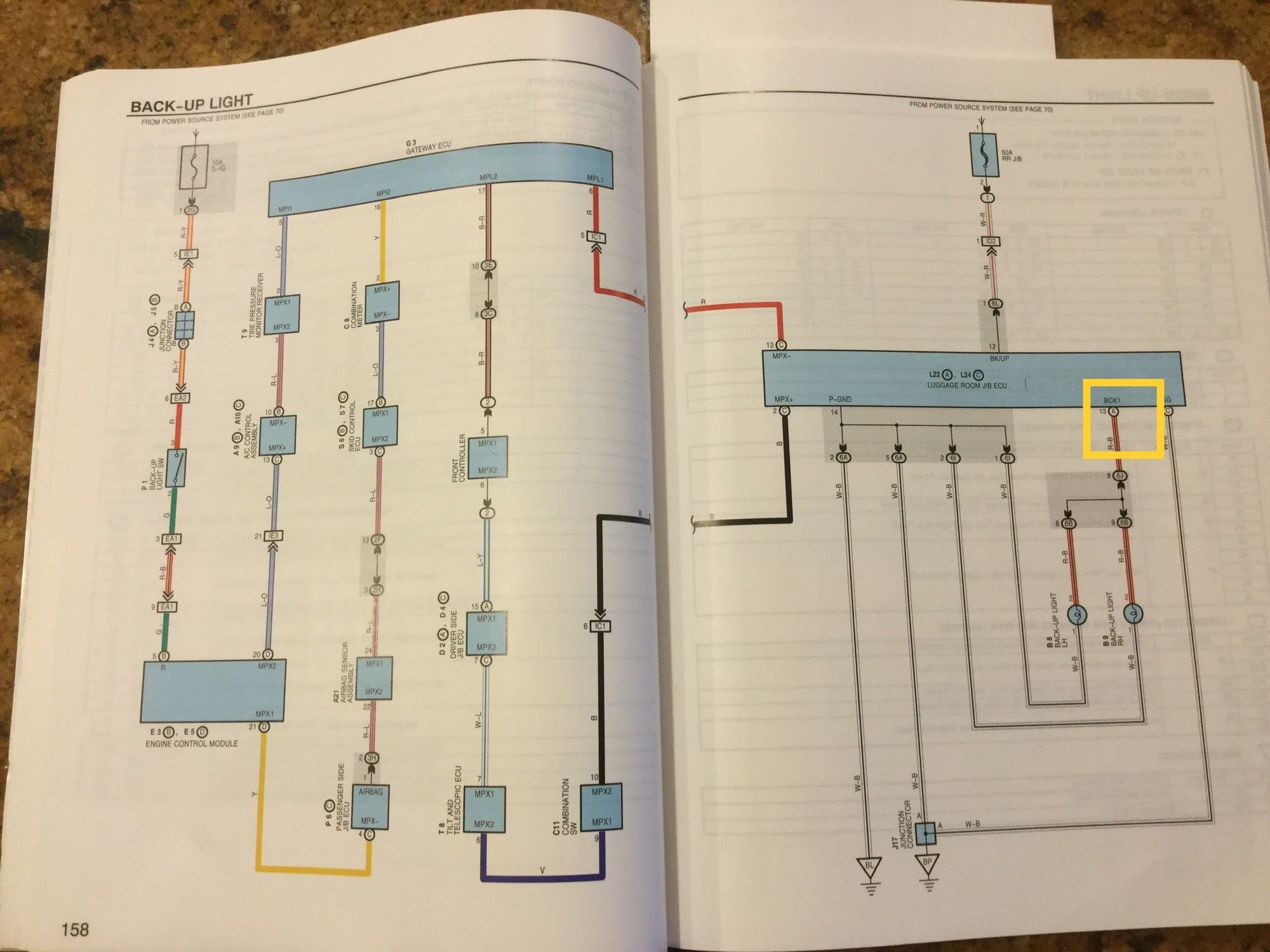

Bgw, you’re right. To me, it’s easier to pull power and the trigger for the camera from the light socket, rather splice from the connector pin. Either way will work.
Question: Can you, from the schematic, locate the switched +12v from the fuse box? I checked, could’nt find any. I know we’re using the power from the connector, just want to know if there is an alternate. Thks.

as requested Gman, I put a box around the jbox pin where I added the wire.
NOTE, I didn’t splice, I just slipped a new wire next to the existing pin, in the Jbox in the trunk.

It looks like it could be the ECU.
When you look at the schematic, the circuit requires a ground to activate the solenoid. When the switch is pushed, the circuit is completed.
it is not a constant ground. Where is the common ground?
it appears to be in the ECU.
before I swapped an ECU, I would open the J box and look for any foreign objects.
