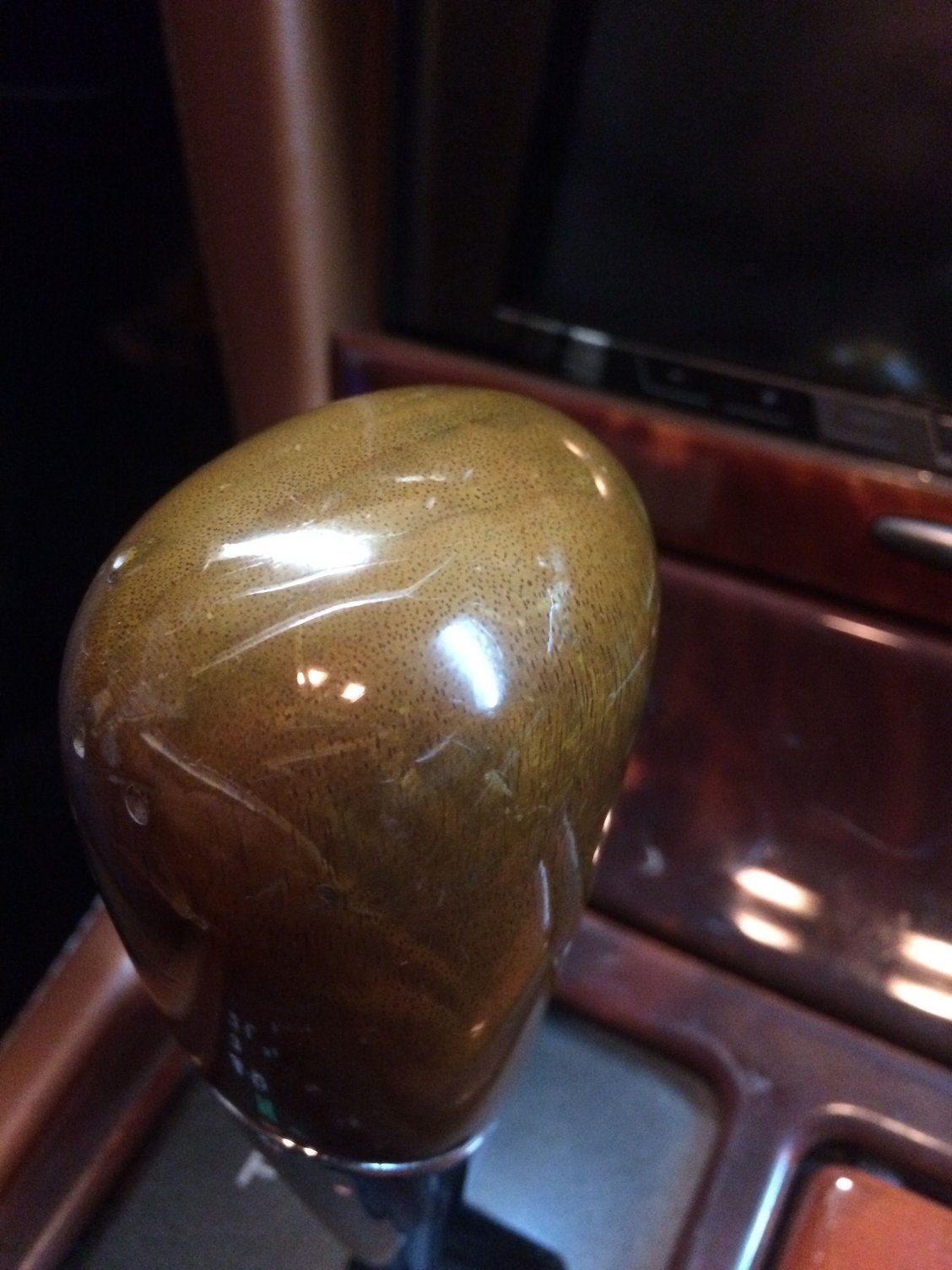

I will take some pictures and hope they will show the damage...I really believe a little dog chewed on the shift ****.
It would be nice if I only needed to brush the polyurethane over the scratches.
You know, it might be possible to just lightly sand the areas with damage to smooth the surface then add a coat to the entire shift ****.

Old Oct 15, 2015 | 02:14 PM
Harold57's Avatar
Harold57
Posts: 4,759
Likes: 416
Some of those marks look like drill marks. They are definitely down into the wood. A good sanding disk or belt (preferably mounted, not hand-held) ought to be able to take those out. You'll just have to keep turning the **** around to prevent flat spots.
Yeah, but wow.... he'll have to remove so much material. Much worse than I thought. I wonder if he could find some wood filler that would match well enough?
I guess it doesn't hurt to try. I would strip off all the polyurethane first to see how much damage actually made it into the wood.

The guy sold me the car earlier this year he is 74 yrs old, he purchased the car when it was 7mo old...the guy was the type who did not work on things, I could just tell. When I asked questions he knew nothing about cars...
With that said, I do not think it was a drill or his wife.
At first I thought it could be a ring, again no...the car had been detailed when I purchased it but when I removed things, seats, interior panels etc, I found dog hair everywhere!!!
I really think it was a dog.
The cup holder and ash tray lid would not operate because everything was full of spilt coffee and cigarette tar...ish soap and water fixed all of that...

Sanding did begin tonight and I will need to sand into the wood slightly, that also means I will need to stain the wood again. Either way, that is fine as I plan to use a stain and finish all in one product.
