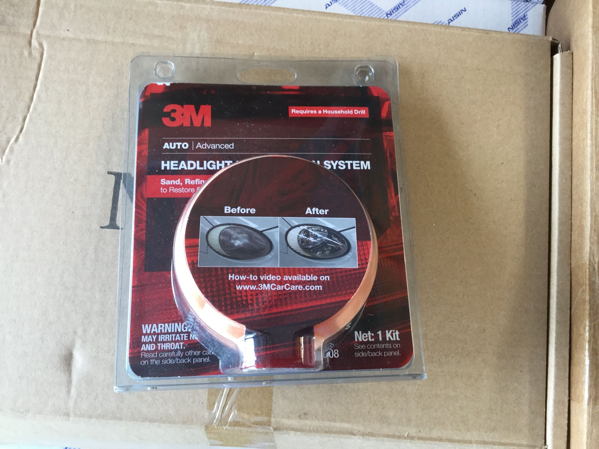

below is what I used the first time...it’s a drill wheel with several levels of sandpaper.
mutistep process...it works well.
