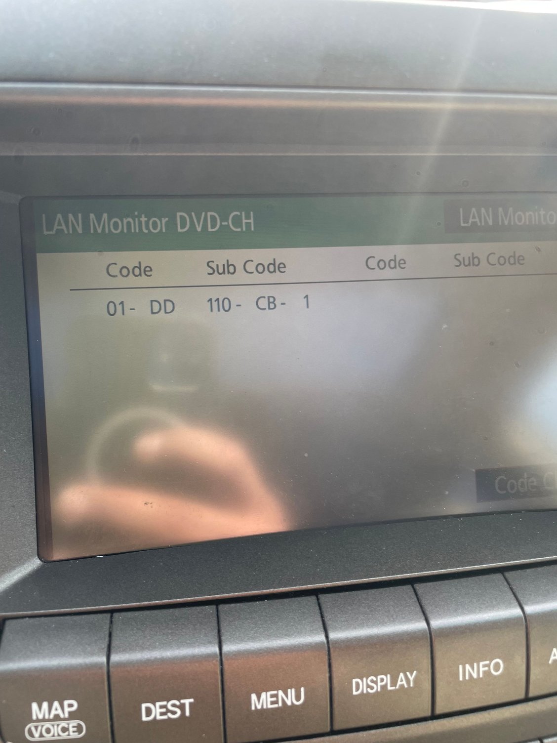

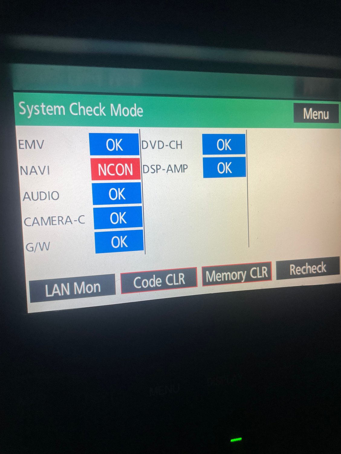

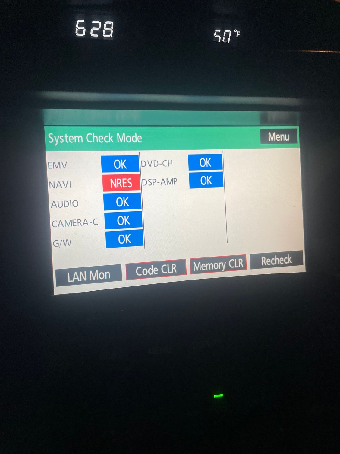

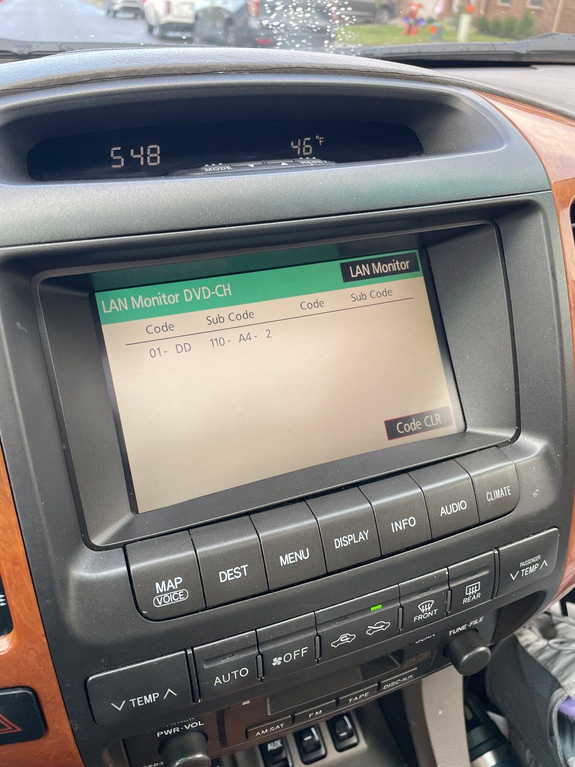

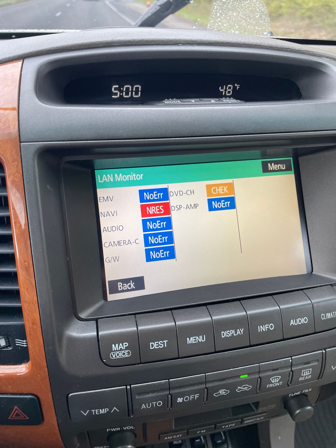

I have a 2007 gx470 with a navigation system and rear entertainment
my nav screen say
please contact dealer everything else works radio/climate
I was able to find the self diagnostics trick
and code reads 01-DD 110
i will attach pictures
any help would be great
