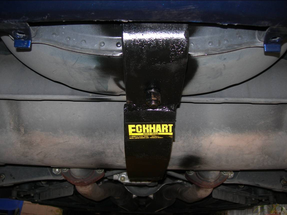

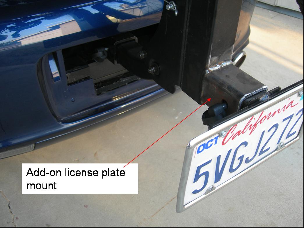

thanks to bfigard, here are more pics
one more comment from him, hehe
Might want to include disclaimer to ensure a professional receiver installer/welder be used. I was watching the rack bounce around when I was on the freeway, and the bumper hasn't moved or shown any signs of compliance. If I had asked Uncle Rich to weld it on, who knows!

Wouldn't rear view be compromised significantly ?
Old Aug 5, 2007 | 11:15 AM
  #34
bfigard's Avatar
bfigard
Joined: Apr 2007
Posts: 93
Compromised, yes. Significantly, no. You can see through the bike.
I cranked the mirror upward to keep eye on the straps on the bikes, make sure not about to fall off.
On the way to get the rear plate mount welded, I was doing a lot of checking to see if cops behind me. Had to do some shifting to see what kind of car back there, but easy to see a car is back there.
Nothing sticks out to the right/left, so parallel parking was easy as minding how far back the rack extends.

This picture is also taken from the rear, but from just under the rear bumper lip. The support piece is bolted to the bottom of the spare tire well in the trunk, then goes forward, under the muffler. You cannot see where it terminates in this picture. But there are two bolts which hold diagonal sway bars (??) and it seems to bolt there.
