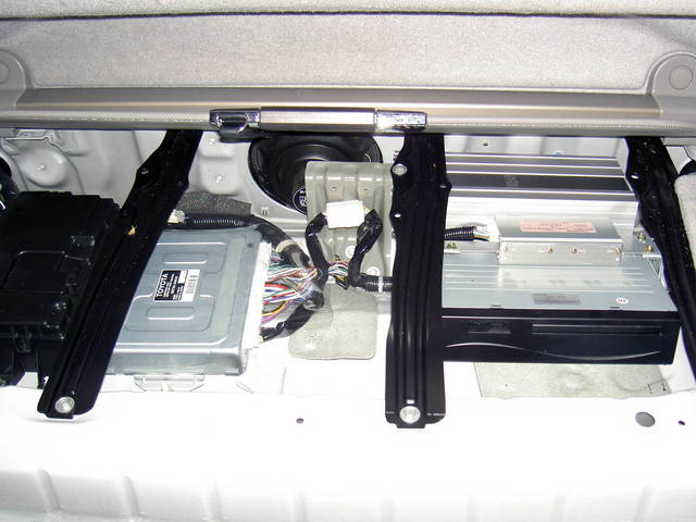

Hi, I was wondering if my car has 8 or 9 speakers? I can see 8(3 in each door and 2 in the rear) Is there another one somewhere hidden? My sc is 2002.Thank you for your thoughts

9 speakers including the woofer behind the rear seat center.
the amplifier is a 7-channel 240 watt (continuous average power with all channels driven, at 0.01% THD; 20 -20,000 Hz). There are 9 speakers including: two .75-in. pure titanium tweeters located at the base of the windshield pillars, two 2.5-in. mid-high-range speakers in the doors, two 6x9-in. midwoofers also in the doors, two 4-in. mid-high-range speakers in the rear quarter panels and one 8-in. low-frequency woofer. There is also a 24-bit floating-point DSP processor and top-up/top-down equalization which compensates for higher exterior noise when the top is down.

and if you want to access it, take apart the trunk

One of the members here replaced the sub with a larger one and he took a lot of photos of the install plus all the original bits AFAIR.
If you search the forum and gallery im sure you will find them.

I found one of his pics..
