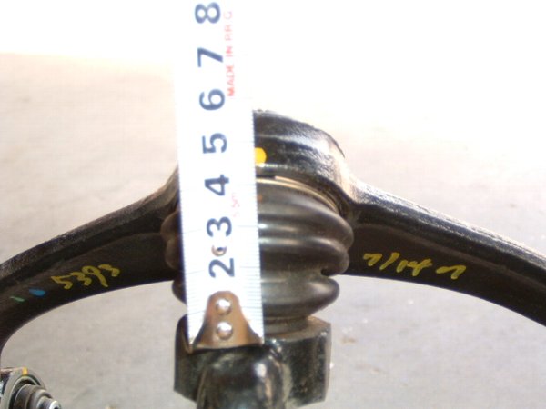

Here is the original upper arm 60mm height joint.

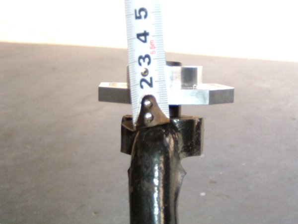

The ss arm 30mm.
This lowers what the nihongjins call "height pitch" but not shock travel.

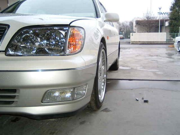

Before Install
After Install

Ok, I'm not sure if you understand fully what you are posting here, but you just showed something that relates to camber gain which is exactly what I was talking about above. Your shorter ball joint height there gives less camber gain, which means that the wheels will camber LESS as the suspension travels, which will give you LESS clearance to the fenders when the suspension starts to compress more. What you want is more camber gain so that the tire will tilt in more, and give more fender clearance.
The tire pictures of before and after are not related whatsoever to ball joint height, those are from different length upper arms, which change the camber at a static height or at any given suspension position.
