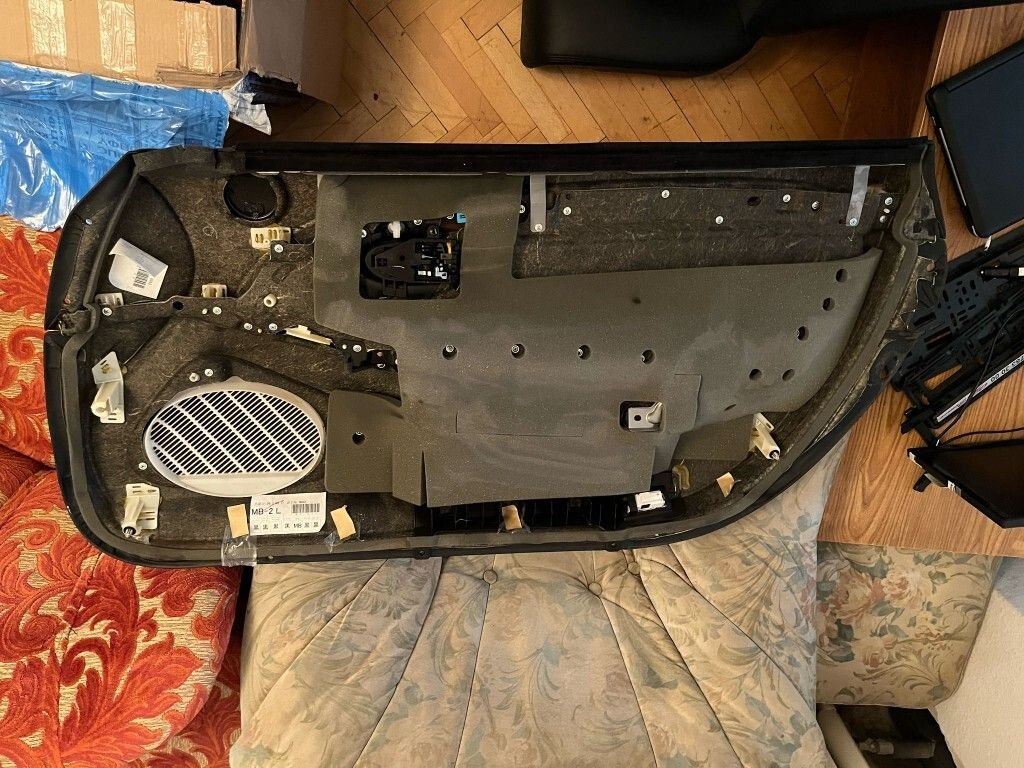

How can I remove ALL the speaker covers in an SC430? Any suggestions on where I can find new speaker covers?
Quote:
they might be either screwed in or glued in, see pic of the back of the door upholstery.Originally Posted by WFCLexus2002
Hello,
Hope this helps and best of luck!
Quote:
They are most likely held up by a Plastic Stud that was Melted and "Mushroomed" down once in place, to remove it, you will have to Drill Out the "Mushroomed" part, and then find a different way of securing it back on the panel, depending on the amount of Material that you will have to work with after you are done. As for where to find new ones, well, you either get a whole new Door Panel, or you will have to make them yourself, I've never really heard of anyone having issues with them, aside from normal wear and tear.Originally Posted by Matt_Dom
they might be either screwed in or glued in...
RofH
Not sure how to remove speaker covers, but there might be some YT videos on how to.
For the speaker covers, I would check your local salvage yards, eBay, and any social media groups that might have someone selling parts off an SC.
Good Luck and Welcome to the Club!!
