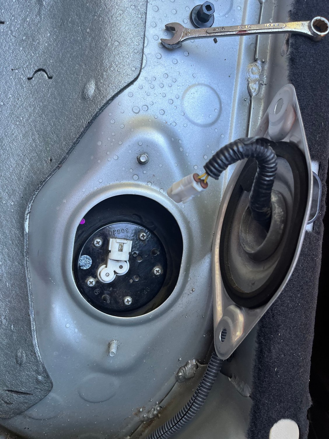

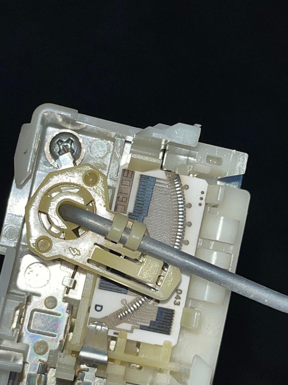

Success. With the existing equipment, the gauge now works. Cleaning the contact pads immersed into (oxygenated, 10% alcohol, corrosive) gasoline with a paper towel and a q-tip on both driver and passenger level indicators (a.k.a. send units) did the trick; I didn't need to buy replacements. Indeed, took around an hour and a half.
Nota bene:
The advice which hasn't been shared by previous posters, yet inevitably relevant, is:
I didn't open the fuel tank gas cap first - without that undoing the fuel line spills gasoline onto the tank. After that, this Lexus smells like a British car. It will sit in the garage for a little while to air out, top down.
Additonal observations from me:
1. I used rubber or chemical resistant gloves - there was dirt and gasoline aplenty.
The gas tank top surface is open to underside and has some 20 years of dirt & dust on in. I cleaned it the best I could before undoing any connection screws. I used paper towels and q-tips with 50% water-alcohol solution to get most of the dirt cleaned.
2. I took pictures which way the top white contacts point.
3. I started on the passenger side - it is simpler.
4. The pump unit (driver side) pulls out up and tilting toward the passenger side. The rubber hose underneath stayed attached. The rubber hose (fuel line) on top disconnects by pulling out the yellow clip completely and pulling the fuel line up.
5. The white electric connector on the pump unit has a catch clip; it is pulled from bottom, away from the connector. Pushing on the top side of the latch doesn't do much to undo the clip. I had to work a thin flat screwdriver between the clip and the catch to help undo it.

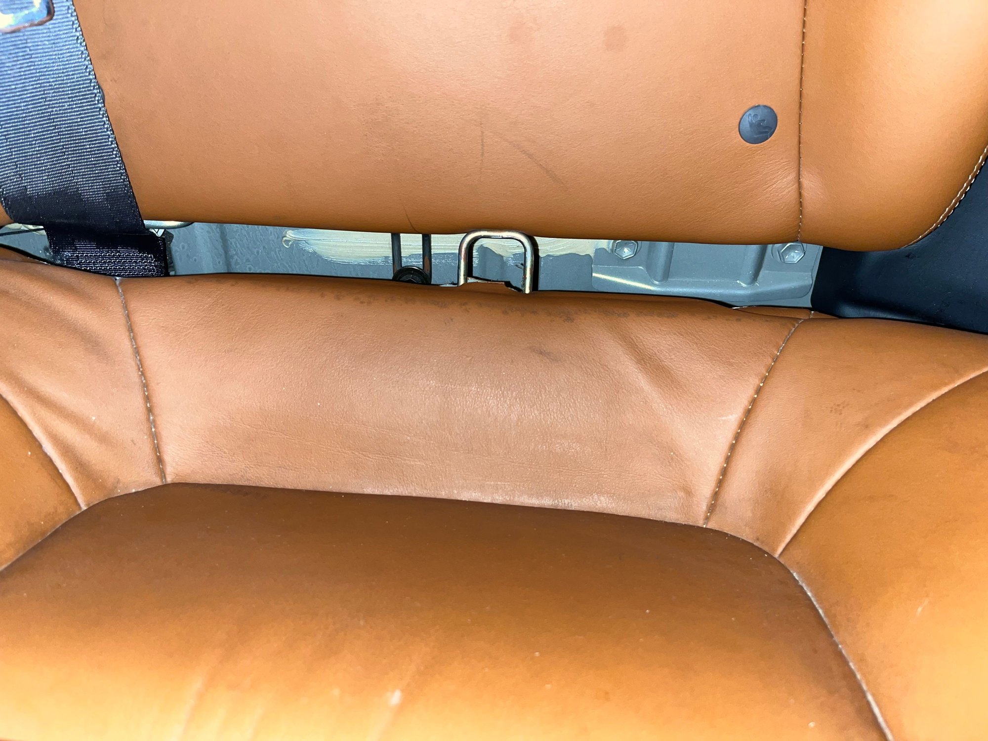

Just for those curious, this car does have LATCH for child seats or booster seats, middle of the rear cushions.
