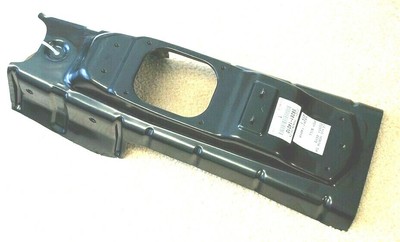

So I didn't *need* to grind down the automatic transmission hole to fit the shifter but I did it for easier install of the transmission while the shifter was installed, it's a bit hard to install the shifter if there is a little access.
What I'm thinking is to get the Supra manual transmission tunnel and replace it with the my auto one but first I'll have to get the dimensions to figure out if that's what I need.
Supra Transmission Tunnel P/N: 58261-14010
