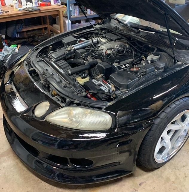

I don't know why I hadn't seen this thread prior. It is incredible. Can't wait to see the end result. You've inspired me to at least get moving on the project SC400 my son was working on before he passed away. One of the things he was dealing with was the fitting of a super charger under the hood. I see you built a custom hood. Nice!
He had taken his '95 up to the local racing area, but was very disappointed in the top-end speed of the stock 1UZ.

thank you - it has been tough, but that's partially why i bought my own SC400.
Yes, he was at Willow Springs, where he took a two-day race training course. I hope to get up there someday myself in the '93 SC400. You've inspired me to check into the supercharger. I found a video of a guy who did just this.

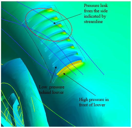

Following up on our discussion on best fender venting techniques and how it does when combined with other aero mods.I combined the vents with tire shields. Nothing optimal but just wanted to see the effects from both. The louvers weren't aggressive enough as they were only 1/4 high. Also it seems that louvers aligned along the fender are NOT as effective. They need to be aligned with the flow as you can see below.
Also, the flow from the fenders creeps along the car all the way down to rear wheel
Just for giggles... The car is at 71 pounds of negative lift (downforce)

I kinda posted in a hurry, but there were a few things I noticed.
The louvers "sort of" worked. If you look below: the louvers would have to be 0.5-1.0" high. Also they need to be aligned with the streamline I pointed out. i.e. angled relative to the fender. It doesn't seem like the fender vents a lot in the presence of the tire shield!
