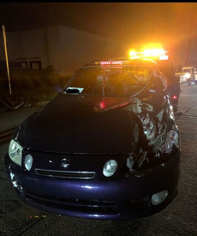

luckily I’m having it rebuilt so it can be back on the road, all that’s left is the wiring.
